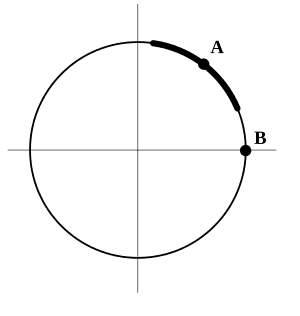

Wikipedia has a nice picture that demonstrates the local aspect:
Circle with the centre at the origin of crossing axes; a thick arc is drawn along the upper right, with a dot labelled A on it and a dot labelled B on the circle at the right, on the horizontal axis.
The circle allows an inversion at point ##A## and does not at point ##B.## There is no "global" version.
