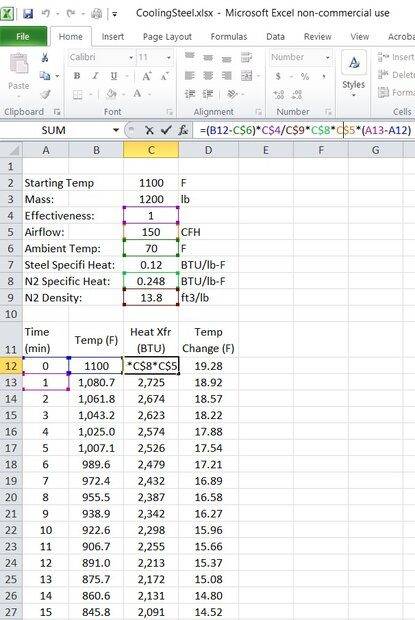

What you've provided isn't a bad start. The way I'd approach it is to numerically model Newton's Law of Cooling using a spreadsheet. If that lights the bulb let me know how it goes, otherwise I can talk you through that. A couple of points:
1. Theoretically speaking you never get to ambient temperature, but you can decide how close and calculate how long it takes to get there.
2. Is this in a closed, insulated container? In other words, are there other avenues of heat loss? Radiation?

Newton's Law of Cooling states that the heat transfer rate is proportional to temperature difference. So as the tube cools, the heat transfer drops and the rate of cooling slows. That's a differential equation that makes calculating the temperature at a time (t) in the future difficult.
But if you use a spreadsheet you can approximate it numerically.
  • First column: time
  • Column 2: Sample temp
  • Column 3: Heat transfer rate (m*Cp*ΔT) [that's mass flow rate of air]
  • Column 4: Temperature change in the time interval
Pick an interval that's small enough for a relatively smooth curve. Probably should also pick an effectiveness fraction for the heat transfer.

Trying to wrap my head around the Excel Setup, and I probably did this wrong.
Colum 1 = Time
Column 2 = Current Temp
Column 3 = Heat Transfer
Column 4 = KW Change
Column 5 = New Temp
I am using 1 Minute as my Time Base
Start Temp is 1100ºF.
I calculated that I put 43.47kw into the material to heat it to 1100. kw = (1200lb * 0.12 [Specific Heat of Steel] * 1030 [Temperature Rise]) / 3412 [BTU > kw Conversion]
Heat Transfer I am calculating as Q = ((M X Cp x dT) * 60) / 3412. M = 0.182lb/min of Nitrogen. Cp = 0.248btu/lbºF. dT = Current Temp - 70. This gives me btu/min. X 60 = BTU/hr. /3412 = KW.
KW Change = 43.47 - the Heat Transfer
If I interpret this as the KW lost in 1 minute, then plug it back into the initial KW calculation but solve for DeltaT. New Temperature = (KW Change * 3412) / (1200 * 0.12). This becomes the Sample Temp for the next row.
So row 1
Sample Temp = 1100. Heat Transfer = 0.818kw. KW Change = 43.47 - 0.818 = 42.653. New Temp = 1010.629.
Row 2:
Sample Temp - 1010.629. Heat Transfer = 0.747. KW change = 41.906. New Temp = 992.939.
This tells me that it'll take 42 minutes to get below 500ºF, which can't be correct.

I got 47min. I think you may have done some extra steps to find some of the constants instead of googling them? Otherwise, maybe some rounding errors between us. But close enough for a first pass.
What strikes me is the airflow is really low. Did you really mean CFH? CFM?
It may be some rounding errors, we have close enough answers.
Where I think we are not correct is that there is no account for the fact that the Furnace Wall is radiating heat as well. The heat capacity of the Nitrogen is not exclusively pulling heat from the Steel, it is also pulling from the fire brick.
The Nitrogen Flow rate is 150 CFH. The Furnace Chamber is only 27cuft. We flowing ~5 furnace volumes per hour.
I am trying to get some more information from my customer on this. I am expecting the cooling time to be somewhere in the 5hr range. Even if I reduce the Gas Flow rate to 25% its current value (simulating that the only 25% of the capacity of the Nitrogen is going to the steel), I am only at a little over 3hrs.
I do thank you for the help thus far, Russ.
@russ_watters are you sure that your spreadsheet is right? I get very similar numbers and 46 minutes to 500F, but only if I assume 150 cfm (9000 ft3/hour). With the given 150 cfh I get a first-minute heat removal of 46.3 Btu, for a steel temperature change of 0.32F. Carrying it to 500F takes 2800 minutes (47 hours). Maybe I have a stray factor of 60 in my spreadsheet.
