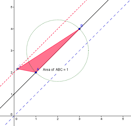

Another method is to use the formula ##A = 1/2 \cdot b \dot h##. You can calculate the base using the distance formula for two points. You know the area, so you need to calculate the "height".
Next you would find the equation of the line created by the points A and B. Then you would write equations for lines that are parallel to A and B, but higher and lower by distance ##h##. You can do all of this on graph paper without exact calculation of the points.

There is a lot of sophistication in calculations that involve geometric propositions. You found A and B are on the circle. What would you do if they weren't? How do you know that they are the diameter of the circle? The use of the inscribed angle property is contingent upon this finding this information. You report a max area and minimum areas and then essentially use a squeezing principle. That is based on a lot of other assumptions. Yes, it is a method that works -- and it involves a lot of big concepts.
My distance method works whether or not A and B creates a diameter, a chord, a tangent, or no intersection with the function for a circle. You can also change the function to a hyperbola, parabola, periodic wave, etc.
Unfortunately, I can't upload a Geogebra file here -- just pictures. If you drag the point C across either parallel line, the triangle keeps an area of 1. You can just count the intersection points of the two parallels with the circle. Or you can manually calculate them if you wish.
You can do this on grid paper easily with a straightedge and compass without reasoning about minima and maxima and the continuity of the function, etc.

The radius is 2sqrt(2). The height required for the triangle to be of area 1 unit is 1/sqrt(2). The max height Is 2sqrt(2) (radius).1/sqrt(2) being smaller can be on either side. Since the base it the diameter, it is a right triangle. For both sides it would be 2*2=4.
