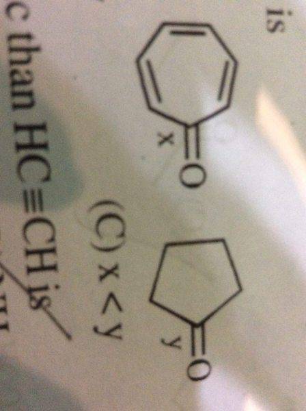

Correct order of bond length in two organic molecules
randomgamernerd
139
: [/B]The correct relation is:
A. x=y
B. x>y
C. x<y
D. None.
Please refer to picture attached.
: [/B]As stability increases, bond length decreases. When a Π bond is delocalised i.e it takes part in resonance, stability increases.
I think x takes part in resonance.
Hence x is more stable than y.
Thus x<y i.e C is correct option.
Do you know the Hückel rules?
yeah, I know..the 4n + 2 Π electron rule...right?
Yes, do you see how to apply it here?
no..
more resonance = longer bond
Compared to what?
