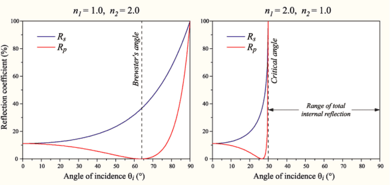

I do think the choices in the table aren't as clear as they could be, and they might do better to call the "unpolarized"case perpendicularly polarized.The concept they are trying to teach is basically all about the Brewster angle, and how the graph of reflectivity vs. angle is different for the polarization parallel to the plane vs. perpendicular to the plane. The term "plane"polarized IMO is rather ambiguous.
Suggestion for the OP is to sketch the graph of reflectivity vs. angle for the parallel polarization case, and for the perpendicularly polarized case for reflection off a material such as glass with index ## n=1.5 ##. You should then see that the reflected light anywhere near the Brewster angle will be largely polarized perpendicular to the plane of incidence. I looked for a graph of these two cases on-line, but I couldn't find a good one. The parallel case has the reflectivity go to zero at the Brewster angle and then increases past the Brewster angle, while the perpendicular case increases steadily with angle of incidence with no Brewster angle. For both directions of polarization the reflectivity goes to ## 1.0 ## at 90 degree angle of incidence. (When it is polarized perpendicular to the plane of incidence and reflection it is certainly polarized, but the term "plane" polarized to me is unclear and IMO is somewhat confusing. I don't know if you would call the perpendicular case "plane" polarized.)
I am really sorry I don't understand how to sketch the graph you are referring to

I wish someone could find this graph in a "link" somewhere or sketch it, (reflectivity vs. angle for the parallel and perpendicular polarization), because it really shows how reflected light is polarized, and even how the transmitted light through a dielectric tilted at an angle will then also be partially polarized, but with the polarization at 90 degrees to that of the reflected light's polarization.
Edit: I found it. See https://physics.stackexchange.com/q...nsely-when-it-hits-a-surface-at-a-large-angle
In the link, there is this graph:
What is Rs and Rp?

There is a plane defined by the incident ray, the reflected ray, and the normal to the surface. I think this is usually referred to as the plane of reflection. Light can be polarized parallel to this plane, or it can be polarized perpendicular to this plane. The two components behave differently (in intensity) upon reflection. The parallel component ,## R_p ##, has an angle where the reflectivity drops to zero, known as the Brewster angle. Meanwhile the reflectivity of the perpendicular component ## R_s ## increases steadily with angle of incidence.
The windshield of the vehicle is tilted somewhere near the Brewster angle. Light reflecting off of it will be polarized in the perpendicular direction for the most part, which is horizontal in this case. The transmitted light will be a combination of both types of polarization, but somewhat more of the parallel (vertical) variety. They really should have told the student that the polarizing filter in front of the camera is oriented in the vertical direction, i.e. to pass the parallel polarized light and block the perpendicular.
