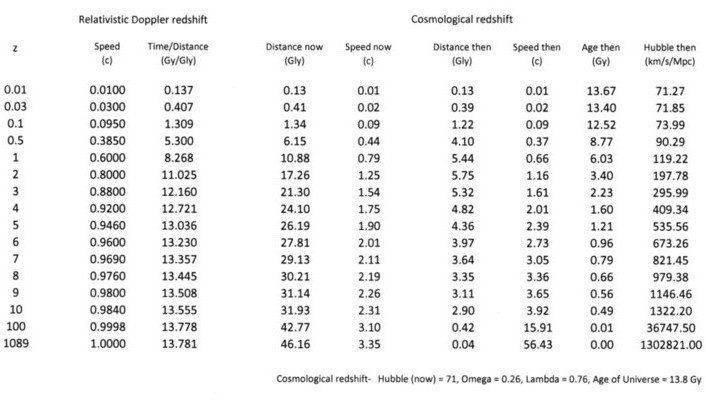

I've recently been looking at how redshift is used to calculate distances to various objects in the cosmos and I now feel I have a fair undertsanding of the difference between relativistic redshift and cosmological redshift. Attached is a table I put together comparing the data from both types of redshift and my question is, would it be a reasonable assumption to say that the 'time/distance' from the relativistic redshift data is the actual time/distance the light itself has travelled? There are a few discrepencies when you add the 'age then' from the cosmo redshift data to the 'time/distance' from the relativistic redshift data which makes me suspect this might not be the case (unless it's just data from two different equations not entirely working together). If it isn't, what exactly is the relevance for the relativistic redshift data?

...would it be a reasonable assumption to say that the 'time/distance' from the relativistic redshift data is the actual time/distance the light itself has travelled? ...
I don't think so---or perhaps I don't understand your third column of numbers which you call
"time/distance" (units: Gy/Gly)
The special relativity doppler shift
could be calculated for a particle or other object which is at ZERO DISTANCE from us, at the instant it whizzes past us.
Therefore your fraction "time/distance" is indeterminant. It might very likely have zero denominator, and the time is not well defined. But maybe you can explain your third column so I can understand.
I understand your first column is just z values from 0.01 to 1089, which you are going to interpret as EITHER a dopplershift z, or as a cosmological redshift z.
YOUR SECOND COLUMN LOOKS GOOD to me. It looks like you just used the special rel doppler formula. I introduce a variable rho = 1+z for convenience in writing it:
[tex]\rho = 1+z = \sqrt{\frac{1+\beta}{1-\beta}}[/tex]
[tex]\beta = \frac{\rho^2 - 1}{\rho^2 + 1}}[/tex]
so in your second column you took z to be a doppler shift, and you just plugged into the second equation here and found beta, the speed in units of c.
Your third column, as I say, mystifies me. But the OTHER COLUMNS SEEM STRAIGHTFORWARD. You could have gotten them straight from Morgan's calculator.
In those columns you are interpreting z as a COSMOLOGICAL redshift, which is a totally different thing from a special rel Doppler shift. So there would probably be no relation between those other columns (four thru nine)
SR doppler formula is used when two objects are right close together in the same reference frame. In that case, expansion of largescale distances can normally be neglected.
Or it could be used for CORRECTION due to local motion in a receding frame. But that probably doesn't apply here.
The main thing you would need to explain, to make it clear to me, is what your time/distance column actually means.
When you observe a certain SR doppler shift (call it z if you want) then how do you decide on a distance and how do you decide on a time----so what is this ratio you call time/distance?
Thanks for the reply Marcus. In truth, I posted a question in another thread (https://www.physicsforums.com/showthread.php?t=206984) asking if the relativistic redshift equation incorporated the cosmological redshift (which I now understand is a separate set of equations). I did some searching and found this thread and the other one called 'Hubble parameter in early universe' which went towards helping me understand the cosmological redshift. The figures you see in columns 4 to 9 are taken from the cosmo calculator, I was inquiring if there was some connection between them and the relativistic redshift figures (which it appears there is not).
The third colomn is based on figures produced in the following equations-
Doppler effect (which applies to < z = 0.1)
[tex]r (distance) = \frac{v}{H} = \frac{zc}{H}[/tex]
if z = 0.03
[tex]r (distance) = \frac{v}{H} = \frac{zc}{H} = \frac{0.03c}{71} = \frac{8993.775}{71} = 126.673 Mpc = 407.25 Mly (or 0.407 Gly)[/tex]
Relativistic Doppler effect (which applies to > z = 0.1) I've actually applied this to anything over z = 0.03
[tex]z = \sqrt{\frac{1 + v/c}{1 - v/c}} -1[/tex]
which provides the following equation-
[tex]v/c = \frac{(z + 1)^{2} - 1}{(z + 1)^{2} + 1}[/tex]
therefore if z = 0.1
[tex]v/c = \frac{(0.1 + 1)^{2} - 1}{(0.1 + 1)^{2} + 1} = 0.095c[/tex]
[tex]r (distance) = \frac{v/c}{H} = \frac{0.095c}{71} = \frac{28480.2875}{71} = 401.13 Mpc = 1309 Mly (or 1.309 Gly)[/tex]
with some help from the following calculator-
http://hyperphysics.phy-astr.gsu.edu/hbase/astro/hubble.html#c3
Hopefully the above sheds some light on column 3. It seemed odd that the relativistic redshift would produce a set of figures that appear to be describing time or distance (as implied at the hyperphysics website).

Steve, I see now how to read the third column. All the other columns made sense right away and I've commented already.
You've taken care to be clear and use LaTex which makes it very easy to read and understand your equations and calculations, which helps and I hope you are rewarded for this both now and in the hereafter.
You drew the right conclusion.
... I was inquiring if there was some connection between them and the relativistic redshift figures (which it appears there is not).
At very small redshift things moosh together and different things turn out to be approximately the same so there appears to be connection. One can used sloppy methods to calculate and it works approximately. You only get forced to be careful at larger redshifts.
What your table shows is that what you get by special rel doppler and a naive application of the Hubble equation does NOT correspond to the reality you get from a good redshift calculator. having made that point, the natural thing to ask is WHY.
WHY DO THE DISTANCES IN COLUMN 3 NOT MATCH UP TO ANYTHING?
Well for one thing the Hubble equation v = H0 d applies only to recession speed and distance at this instant right now in January 2008.
As long as z is small and v is small we can be sloppy and forget about differences between speed then, and speed now, and average speed during the time of flight---it is all about the same. But for larger z, watch out!
So when you take a COSMOLOGICAL REDSHIFT and apply the special rel inverse doppler formula to it, you do in fact get a speed. But is it the speed NOW?
Or is it the speed then, when the light set out on its journey to us? Or what is it supposed to mean? some average?
It isn't anything. It isn't well defined. Because special rel is not generally applicable. But whatever it might be, it surely is not the speed NOW. so you cannot apply the Hubble formula! The v = H d equation simply does not apply.
So when you apply it and get a distance that does not match anything, nobody should be surprised. That is my attempt to answer the question of why it doesn't match the cosmo calculator results.

After your next post, I realized that you meant "time OR distance" and that the units were "Gy OR Gly". this is just the normal hazards of notation. that is probably the main reason I didn't see what you were doing immediately. I will be more alert to that possible reading another time.
Thanks again for your reply.
Would it be a fair assumption to say -
The simple Doppler effect equation can be used when z < 0.01
I revised this from 0.03 which still had a degree of error when compared to the figure from the relativistic Doppler effect equation. z = 0.01 still covers a radius of 137.815 Mly which takes us well out of the Local 'Virgo' Supercluster.
The relativistic Doppler effect equation should be used when z < 0.1 to take in account special relativity.
The cosmological redshift equations are used when z > 0.1 to take into account cosmic expansion.
But as a whole, it's normally best to use the cosmological redshift equations in order to get the most accurate results (I'm aware there is a gravitational redshift but this applies locally so I've not looked too much into that).

BTW, I think that column 3 of yours (post 7) describes look-back time or look-back distance in terms of light travel time, which are obviously equivalent.

it gets it about "Wright" as a rough approximation, doesn't it?
here are some sample lookback times using Ned Wright's calculator
http://www.astro.ucla.edu/~wright/CosmoCalc.html
Code:
z  Wright calc  special rel doppler approx (Steve's 3rd column)
1   7.731       8.268
2   10.324     11.025
3   11.476     12.160
4   12.094     12.721
5   12.469     13.036
I would not encourge anybody to think of what you get in Steve's 3rd column as the real lookback time (in a cosmology context)
because it could get them confused. Using SR doppler leads to misconceptions about the lookback time or anything else involving the cosmological redshift z, because the cosmological z is not a doppler. But if you want a rough approximation it is definitely the right order of magnitude. Maybe by adjusting parameters one could get it even closer. Thanks for pointing out the similarity, Jorrie!

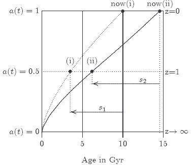

Yep, I agree. I shot from the hip and I've missed!
I have done a little work before on lookback times and found that it is more than just a little "model dependent". As a fair example, I've considered: (i) a flat universe with no cosmological constant against (ii) a flat universe with ~73% vacuum energy component, both for a Hubble constant of ~66 km/s/Mpc and a redshift z=1.
The resulting curves are shown in the attached graph, with widely different lookback times/distances, s1 and s2. Neither has anything to do with Doppler shift, because the redshifts are the same! The lookback distances depend on the shape of the expansion curve.
Lessons: 1. Don't shoot without aiming! 2. Don't confuse cosmological redshift with Doppler shift!
