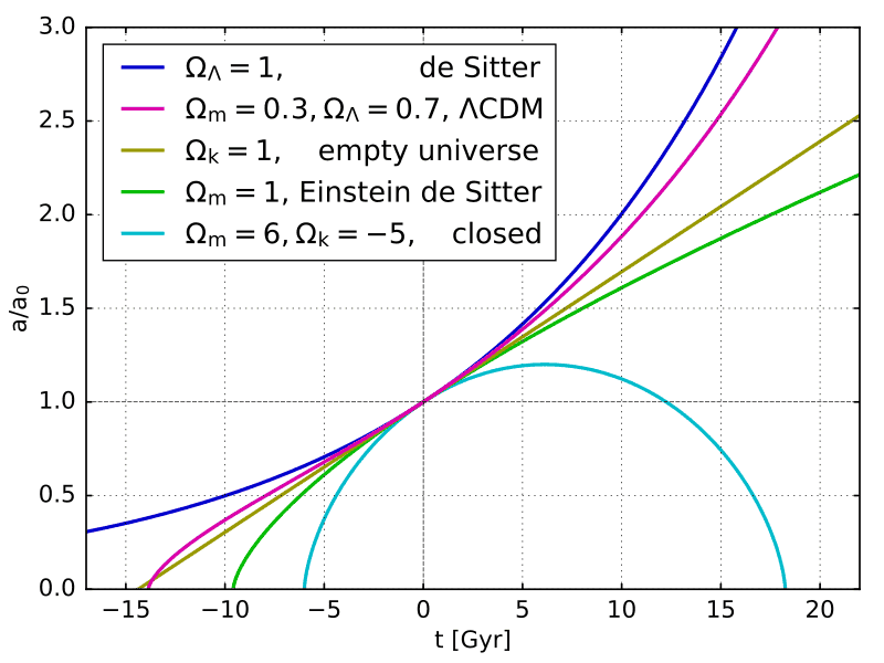

If what I did 10 or so years ago in https://www.physicsforums.com/threads/weyl-curvature-and-tidal-forces.433916/post-2910883 is right, for the flat FLRW metric
$$ds^2 = -c^2 dt^2 + a(t)^2 \left(dx^2 + dy^2 + dz^2 \right)$$
The "tidal force" stretching the string will be proportional to ##\frac{a''}{a}## where a'' = ##\frac {d^2 a(t)} { dt^2}##
The justification for this is the geodesic deviation equation, which says that the relative acceleration between geodesics is ##R^{a}{}_{bcd} u^b u^d D##, where D is the separation between geodesics. It's convenient to let D be the distance between the middle of the long string and the end. Then the proper acceleration of the middle of the string is zero, and the proper acceleration of the end of the string must be of the above magnitude to keep the length of the string constant.
However, to get a'' we need to get into more details of the Friedmann equations, https://en.wikipedia.org/wiki/Friedmann_equations
Skimming through the appropriate wiki links will give the relevant equations, most particularly
https://en.wikipedia.org/wiki/Hubble's_law
https://en.wikipedia.org/wiki/Friedmann–Lemaître–Robertson–Walker_metric
The first link, to Friedmann's equations, is the most directly useful, it gives:
H^2 = \left(\frac{\dot{a}}{a}\right)^2 = \frac{8 \pi G}{3}\rho - \frac{kc^2}{a^2}
and
$$ {\displaystyle {\dot {H}}+H^{2}={\frac {\ddot {a}}{a}}=-{\frac {4\pi G}{3}}\left(\rho +{\frac {3p}{c^{2}}}\right).} $$
As I've already assumed we have a flat spatial slice, we set k=0 in the above.
You'll have to wade through the math to get more details, but basically Hubble's constant changes with time and gives a' / a, while what we really want is a'' / a.

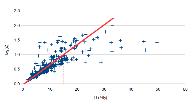

PeterDonis said:
No, it hasn't. The expansion was decelerating until a few billion years ago; now it is accelerating.
My claim that the universe 'has made a pretty good job of expanding linearly' was based on the following diagram. It shows the currently popular (0.3, 0.7) model in red and the linear (empty) universe in brown. As Peter Donis said, the current model has departed a bit from the linear model but the most remarkable thing about the two models is that they both appear to agree almost exactly on the age of the universe.
