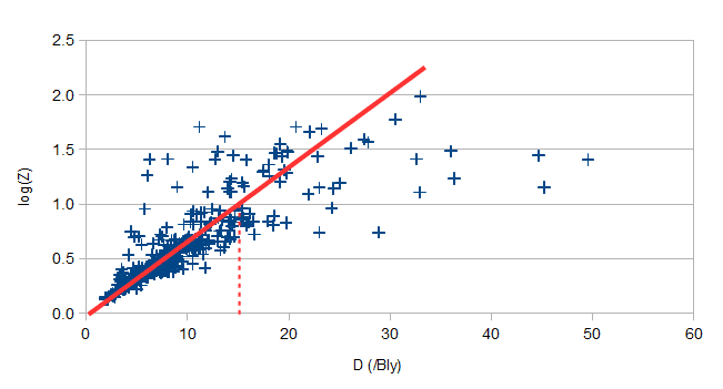

J O Linton said:
A graph of D against log(1+z) for very large z is consistent with the assumption that they are proportional
I have no idea what graph you are referring to, since the only graph that has been given so far in this thread directly contradicts your claim here, as I have already pointed out in post #26 of this thread.

I am well aware of the arguments in favour of the ##\Lambda CDM## model and am quite willing to accept that it is the best model we have at present. Please do not deliberately misunderstand me. I am not arguing that the expansion of the universe has been linear - only that in order to understand the basic properties of the universe we live in, a linear model is perfectly adequate, at least to a first approximation.
I attach a graph of log(Z) (Z = 1+z) against D. the data is taken from the NED-4D files available at https://ned.ipac.caltech.edu/level5/NED1D/intro.html.
In resepct of your other comment in post #26, by 'observable universe' I meant that part of the universe within the particle horizon. A linear universe has an infinite particle and an infinite event horizon. I believe I am right in saying that the ##\Lambda CDM## universe has an infinite particle horizon but a finite event horizon - i.e we can see all of the past universe but may not be able to communicate with all of the future universe. As I have already pointed out, the particle horizon of our universe extends at least as far as the CMBR.
  • #33
The linear model is not adequate to describe the observations. As you say yourself to fit all (!) data, i.e., at least both the redshift-distance measurements (e.g., from Hubble space telescope) and the CMBR-fluctuation data (e.g., from the Planck satellite measurements) the cold-dark-matter model with a cosmological constant (including acceleration!) is the far best model, and the linear model fails. Whether or not this really is the final answer, nobody can say. There's at least the issue about the value of the Hubble constant when measured with different methods that has to be understood and be resolved.
  • #34
I doubt if anyone has seriously tried to reconcile the observations with the linear model. The reason for this is, of course, that there are good theoretical reasons why the expansion cannot be linear because a linear universe is theoretically empty - which our universe patently is not! I am not trying to argue that the ##\Lambda CDM## model is wrong - only that, to a first approximation, the linear model makes a pretty good job of explaining the erssential features of our universe.

  • #35
It's not just theoretical reasons. There are direct observables that can't be reconciled with the linear model. Most obviously the shape of the Hubble diagram (e.g. see Reiss' work, past and current). As one looks towards higher z's the shape of the curve will be different, depending on the value of the second derivative of ##a## (in particular, it will curve in opposite directions during acceleration/deceleration phases).
That's what first prompted the inclusion of Lambda into the model. And if you think about it, it couldn't have come from what you call theoretical reasons, as with matter - we can look around us and see that the universe is not empty, and decide that only models with matter in it should be considered; but the cosmological constant is not conspicuously advertising its existence, so there's no a priori reason to favour models with it over those without. Its inclusion in the model must come from observations of how the expansion unfolds over time.
Now, it's true that you can approximate a curve that slopes one way for about half it's length and the other way for the other half, as a line. This is contingent on not looking too closely and being fortunate enough to find oneself at the cosmic time when the two opposing contributions are about equal.
But you're doing more than that here - you're assuming the approximation will hold just as well in the future, which is what you're doing when you're making deductions about actual horizons.
If you forgive me a hyperbolic analogy, it's like acknowledging that the Earth being flat is a good local approximation, and - even though one is aware that the approximation diverges the farther (or closer) one looks, use the flat Earth model to make deductions about the entire planet.
You can always draw a linear fit through any set of points. That doesn't mean the linear fit is a good approximation.
Sure they have. You already showed a graph of how that would work in post #23. All you would need to do is add the observations that support the ##\Lambda CDM## model and rule out the other models.
