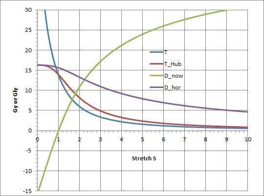

I have incorporated the CEH into CosmoLean_A22, together with a few minor upgrades. The numerical integration now has to run for scale factor 10-7 to 107, so I had to compromise on the number of steps to get an acceptable execution time (some 3 million steps). Nevertheless, the accuracy seems to be at least 3 significant digits.
Here is a "copy & paste friendly" output sample (a check-box to this effect is one of the minor upgrades):
Code:
S	a	T	T_Hub	D_now	D_then	D_hor
1.090	0.917	12.579	13.372	1.213	1.112	15.458
1.000	1.000	13.755	13.900	0.000	0.000	15.622
0.910	1.099	15.090	14.392	-1.288	-1.416	15.768
0.820	1.220	16.612	14.838	-2.604	-3.176	15.894
0.730	1.370	18.361	15.227	-3.957	-5.421	15.999
0.640	1.562	20.387	15.553	-5.343	-8.348	16.084
0.550	1.818	22.765	15.814	-6.755	-12.282	16.149
0.460	2.174	25.610	16.010	-8.187	-17.799	16.195
0.370	2.703	29.112	16.147	-9.635	-26.040	16.222
0.280	3.571	33.626	16.233	-11.092	-39.616	16.233
0.190	5.263	39.932	16.279	-12.556	-66.083	16.279
0.100	10.000	50.388	16.297	-14.022	-140.21	16.297
0.010	100.000	87.918	16.300	-15.489	-1548.8	16.300
A small amount of manual formatting may still be required. I had to remove some trailing digits from the last two lines. I'm not sure if there is a HTML table tag available in the forum editor, because that would have made it even easier to paste.
Works really well! I just now asked for a table with 110 rows, from distant past (first galaxies) to over 70 billion years into future (year 88 billion), and the table appeared instantly. I then asked for the copy-paste version and that appeared instantly. Here it is, let's see what it it looks like. this is without any aligning by hand:
Code:
10.000	0.100	0.559	0.839	30.890	3.089	4.653
