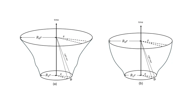

looking more closer at it:
If you see two galaxies g0 and g1 on the same line, with one galaxy g0 just a bit further than the other g1.
Use g0 as origine of your coordinate system. At time t0 = 0 light is emitted from g0.
At the later time t1, this light passes galaxy g1 and g1 is also emitting light.
At time T we receive the light from both galaxies.
From our perspective:
If the instrumentation measures more than expected red-shift from the light received from g0 and g1 and
if the light from galaxy g0 has more additional red-shift than the light from galaxy g1 (which is closer),
then light that was emitted later in time (from galaxy g1) shows less excess red-shift than light from g0.
I have to assume here that relativistic effects (and possible other mechanisms that can cause a red-shift effect),
have been taken into account and we are talking only about an additional red-shift unaccounted for.
So, moving forward in time (for subsequent emitted light), the amount of additional red-shift is diminishing over time,
i.e. it says expansion is slowing down and there is no accelerating expansion of the universe.
I do not see how you can get to the conclusion that "Observations show that the expansion of the universe is accelerating"
based on the measurements.
(In which the reasoning also needs to be correct obviously).
The question remains, how do you get at this conclusion from the observations?
What is the reasoning?

I'm not quite sure what you're saying here. G0 will be more redshifted since it is further from us than G1 (assuming the two are not so close as to be bound together by gravity). This, by itself, means little. To determine the rate of expansion you have to look at many, many galaxies and combine redshifts with other factors like supernova brightness, baryon acoustics, CMB properties, etc.

Roughly speaking, the point is that by looking far away you get a cross-section of the universe throughout its history. Nearby stuff looks as it did recently, and further away stuff looks as it did a long time ago. You can then think about how cosmological expansion affects the light in flight, and back an expansion history out of that data.
You need the details of the observations and the maths of the cosmological model to make actual numerical deductions like whether there is a non-zero ##\ddot{a}##.
It works like this: As we look across the universe, we see recession speeds increasing with distance. This alone, only tells us that the universe is expanding. To work out how it expanded over time, we look at exactly how that recession speed changes with distance. If for example, if the rate increases linearly with distance(plotting distance vs. recession gives a straight line), than then the expansion rate has been constant through time. If however, it isn't linear (The plot line curves), then the expansion rate hasn't been constant over time. Which way the line curves tells us whether the rate has decreased or increased over time.
What is meant by time is "cosmic time" i.e. proper time measured by observers who are co-moving with the expansion, but who are otherwise not moving "through" space (in co-moving coordinates). We imagine their clocks all having been synchronized at cosmic time t = 0: the beginning of the expansion. Another way to think about it is that this is time as defined in reference frame in which (ignoring primordial fluctuations), the CMB appears isotropic (no kinematic dipole).
The answer to your question about how acceleration is measured is complicated. The short answer is that it's indirect, and model-dependent. How it's determined is also dataset-dependent. In one dataset (observations of Type Ia supernovae or SNe), the two physical observables are (1) distance to a galaxy (as measured at the present time using a standard candle like a Type Ia SNe) and (2) redshift of that galaxy, as measured using spectroscopy. Measure these two for enough SNe, and you can produce a distance-redshift curve. You compare this empirical curve to what different versions of cosmology theory (different models) predict. The models have different expansion histories due to the presence of different constituents driving the expansion. Models with no Lambda (no cosmological constant) predict a curve that differs from our data by many many standard deviations (many sigma). Which means the deviation between the no-Lambda theory and experiment is very unlikely to be due to random measurement error. The distance-vs-redshift curve that best fits our data comes from a model in which Lambda is not zero. Again, the evidence for this, statistically, is very strong (that's why Reiss and Perlmutter and whoever else won the Nobel prize for these SNe observations). So at no point did anyone directly measure the recession rate of a galaxy at many different times and note that it was increasing with time. They measured present-day distance and present-day redshift for a large sample of galaxies. But those observations can only be explained if Lambda is non-zero, and hence the expansion rate has been increasing with time exponentially over recent cosmological history (say, the last 6 billion years).
For other datasets, like measurements of the Cosmic Microwave Background (CMB) fluctuations, the physical observables are totally different, but the results agree. Again, the determination is indirect. In the CMB you look at the fluctuations and say, "how are they statistically distributed as a function of scale on the sky?". That produces another curve called the angular power spectrum. This curve is really telling you the size distribution of density fluctuations (sound waves) in the primordial plasma of the early universe. You again compare the shape of this curve to what what early-Universe theory predicts for universes with different compositions and expansion histories. The comparison again shows that the model that best fits that data is one in which Lambda (the cosmological constant) is non-zero, to exceedingly high statistical significance.
Now we're looking for evidence that Lambda may not be a constant. We're attributing its effects to some mystery quantum field permeating all of space (dubbed "dark energy") whose density may actually vary with time rather than being fixed. But the present-day value for the energy density of that field (Lambda, essentially) is not in doubt, given the data.
Hope that helps!

Drakkith said:
Measure the velocity of receding galaxies at time A, then measure again at a later time B. The measurements will show that galaxies are receding faster at time B than they should be if the expansion was purely 'inertial' without acceleration.
No, that's not the case. When we talk about the acceleration of the expansion, we're not referring to the fact that the recession velocity of galaxies increases with time, but rather to the increase in the growth rate of the scale factor.
In fact, in the model that best fits observations, the recession velocity of galaxies currently decreases with time.
Edit: I just realized this isn't true. What's currently decreasing is the Hubble parameter, not the recession velocity of galaxies.

There is a very crucial point and is exactly what the question is about.
There is a large gap between "the measurements" and "show that galaxies are receding faster ..."
It was not clear at all that the same galaxy was measured several times and the data compared at these different times.
Also what these measurements actually are or show always stays rather vague and gets to quickly interpreted into galaxies receding.
There are a lot of non trivial and possible tricky issues when galaxies are very far away and relativistic effects become important.
The situation at time A and that at time B are not identical.
For the remote galaxy time has passed and the distance is also different.
It can affect how to interpret redshift with respect to distance.
The Hubble parameter is different as it is time dependent.
The light has taken a longer time to reach us, that affects the timing.
I tried to make clear that you do not observe how objects in the universe are moving away from one another now, but how they did in the past as this information is reaching us only now after having travelled billions of years through the universe.
With the simple model on g0 and g1 I tried to illustrate that an excess in decelerating expansion can appear to us as an excess in accelerating expansion, a kind of optical illusion, due to that it takes time for the light to reach us.
If the galaxy g0 is showing more unaccounted red shift than the closer galaxy g1 then that effect goes away for galaxies closer to us emitting later in time. So later in time the extra red-shift effect becomes smaller and not larger.

I once asked the same question, how do we know if the distant galaxies are accelerating now since the light we observe here and now is from billions of years ago?
Then I found that cosmologists used methods such as measuring the apparent size of galaxies v redshift, otherwise known as the angular size redshift relation.
The figure above shows two types of expansion (a) is accelerating and (b) a decelerating expansion. Time goes from bottom to top, the scale factor ##R_1## is when the universe was much smaller and ##R_0## is the scale factor today.
The light rays from a distant galaxy that we observe today were emitted when the universe was much smaller and these galaxies can appear larger to us and its this apparent size v redshift that can determine the history of the expansion of the universe.
I don't know the exact numbers but, initially at low redshifts ( up to around z = 1.3)the angular size of galaxies decreases, to then increase at higher redshifts, and finally at very high z they decrease again.
The measured change in the angular size at specific redshifts is exactly what we would expect from a universe that transitions from deceleration to accelerated (figure (a)), and cosmologist can use it to estimate the acceleration started around 4 to 5 billion years ago.
If the universe was currently decelerating as in figure (b), then the observed angular size redshift relation would be much different, pretty much the opposite to what we observe. These methods have been used since the 90's and are still used today using different sources at many wavelengths over a wide range of redshifts, and the results always point toward a Robertson Walker universe with accelerated expansion.
Although the universe is accelerating in its expansion, the Hubble parameter actually decreases with time, and will continue to do so until the dark energy constant totally dominates and then it will finally be truly a constant giving
$$H=\sqrt{\frac{\Lambda c^2}{3}}$$
Since the scale factor is related to Hubble constant by ##H=\frac{1}{R}\frac{dR}{dt}## and substitute this into the above we have the differential equation:
$$\frac{1}{R}\frac{dR}{dt}=\sqrt{\frac{\Lambda c^2}{3}}$$
which has the solution ##R\propto e^{ct\sqrt{\Lambda /3}}##
So in the remote future, the scale factor ##R(t)## will increase exponentially with time forever, according to our best models anyway.
