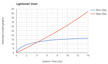

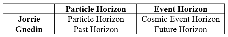

These horizons can be calculated with calculators provided by Jorrie and Gnedin. They use different names for them:
Table comparing horizon names used by two calculators: Jorrie uses Particle Horizon and Cosmic Event Horizon, Gnedin uses Past Horizon and Future Horizon, under column headings Particle Horizon and Event Horizon.

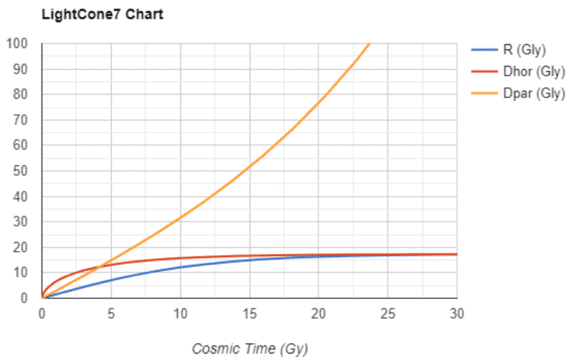

Using Jorrie’s calculator and PLANCK Data (2015), one can get the following plots:
Line chart titled LightCone7 Chart, plotting Dhor (Gly) in blue and Dpar (Gly) in red against Cosmic Time (Gy) from 0 to 14, with Selected Comoving graphs on the vertical axis.
In the above figure, the particle horizon indicates the size of the observable universe as a function of time. The radius of the event horizon was small during the early times and has a value of 16.5 Gly now.
An interesting point to note is that light emitted outside the event horizon at various times will never reach our location. It can be demonstrated that lights emitted inside of and close to the event horizon have peculiar behaviors such as prolonged journeys to reach our location.
Please share with us your understandings and/or questions about these horizons.

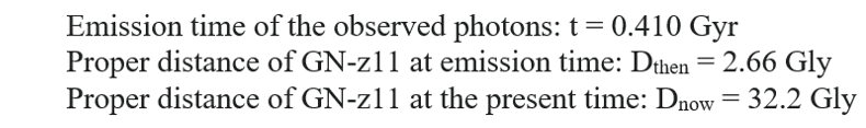

The Big Bang model depicts a complicated picture of the universe and the consequences of space expansion can be very confusing. Let’s use some calculation results to illustrate this. GN-z11 is currently the oldest and most distant known galaxy in the observable universe, having a redshift of z = 11.09. Using Jorrie’s calculator and PLANCK Data (2015), one can get the following information about this galaxy:

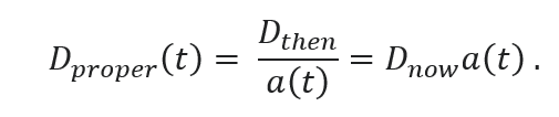

Three lines of text: Emission time of the observed photons: t = 0.410 Gyr; Proper distance of GN-z11 at emission time: Dthen = 2.66 Gly; Proper distance of GN-z11 at the present time: Dnow = 32.2 Gly
The figure below shows that at the emission time, the photons and GN-z11 were 2.66 Gly away from our location. Starting from there, GN-z11 continues to move away from our location due to space expansion according to the equation,
Equation: D_proper(t) = D_then / a(t) = D_now a(t), where D_proper is proper distance at time t, D_then is comoving distance and a(t) is the scale factor.

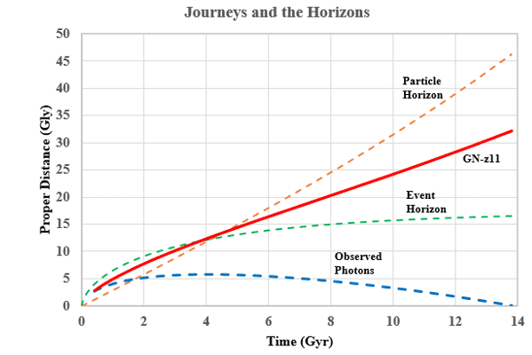

Adding the particle and event horizons to the figure, one gets the following:
Line graph titled Journeys and the Horizons plotting proper distance in Gly against time in Gyr, showing curves for particle horizon, event horizon, GN-z11 and observed photons.
At emission, GN-z11 was inside the event horizon and, therefore, the emitted photons can reach our location. These photons, however, arrived 13.8 - 0.41 = 13.4 Gyr later. Around t = 3.84 Gyr, GN-z11 moved out of the event horizon and light emitted by it since can never reach our location.

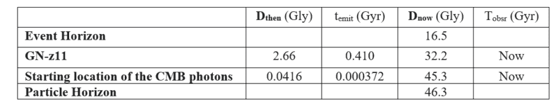

To examine the calculation results further, let us draw an imaginary line from our location to the current GN-z11 location and beyond, and use D to represent various proper distances from our location at the present time. Jorrie’s calculator can give the following information:
Table of cosmological distances and times with columns D_then (Gly), t_emit (Gyr), D_now (Gly) and T_obsr (Gyr). Event Horizon: D_now 16.5. GN-z11: D_then 2.66, t_emit 0.410, D_now 32.2, T_obsr Now. Starting location of the CMB photons: D_then 0.0416, t_emit 0.000372, D_now 45.3, T_obsr Now. Particle Horizon: D_now 46.3.
The present-time proper distances of the starting location of the CMB photons and GN-z11 are both inside the observable universe (particle horizon). That’s why we can observe them, but what we observe are the photons coming from them long time ago; the lights emitted by them now will never reach our location.
To generalize, we can observe, at the present time, all objects between the event horizon and the particle horizon, but only their past history reaching us just now. Any lights emitted by them now, however, will never reach our location.

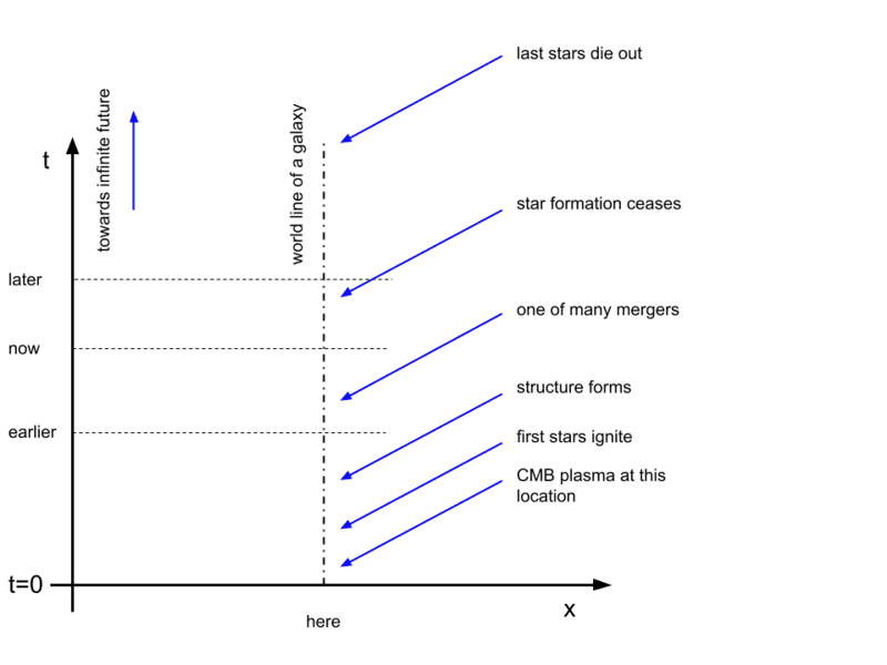

Just adding a bit to Ibix's comment. Think of a galaxy as a string of events, together forming its history.
I.e. there's some gas early on; as time advances the gas coalesces and the galaxy forms. Over time, star formation ceases and the stars fade until it's just some inert mass drifting in the void forever. On cosmological scales, all these events happen pretty much in the same place (same spatial coordinate).
For an observer located within the galaxy, the string of events will form a straight line (or, a 'world line'), where all the events happen 'here', just at different times, like so:
Spacetime diagram with time t on the vertical axis and space x horizontal; a vertical dash-dot line marked 'world line of a galaxy' runs upward from t=0 at 'here', with blue arrows labelled CMB plasma at this location, first stars ignite, structure forms, one of many mergers, star formation ceases, and last stars die out.
(In this post, a 'galaxy' will refer to the entire world line, from formless plasma from which it formed, to a collection of stellar husks in the far future.)
The world line of a similar, but distant galaxy, receding with the expansion of space, will be a curve:
Spacetime diagram with time t on the vertical axis and space x horizontal; a dash-dot vertical line marks our galaxy's world line at 'here', and a dotted curve marks a distant galaxy's world line starting from t=0, with blue arrows labelled first stars ignite, structure forms, one of many mergers, star formation ceases, and last stars die out.
I.e. as time advances, the observer at the 'here' spot will see each consecutive event at ever farther distances.

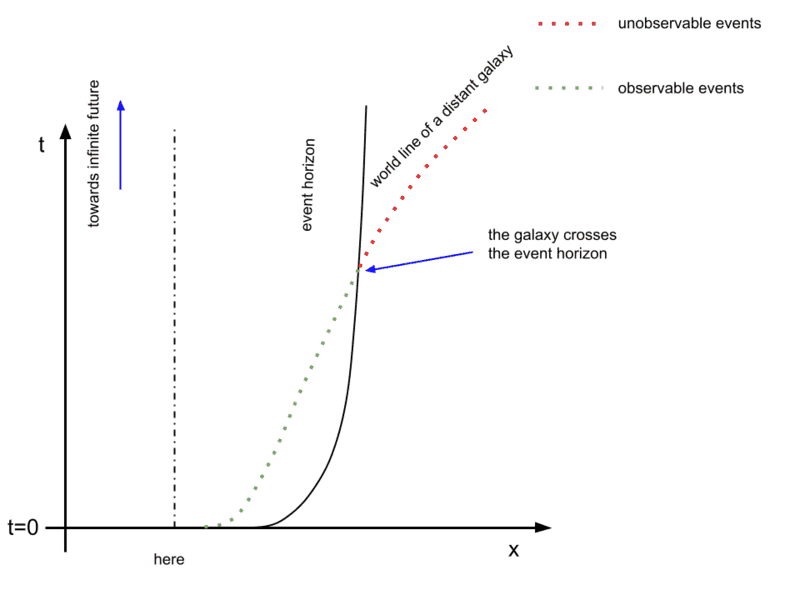

The event horizon cuts off a part of the world line of a distant galaxy, so that only some of the events can be ever observed:
Spacetime diagram with time t on the vertical axis and position x horizontal; a black curve labelled event horizon, a green dotted observable events segment and red dotted unobservable events segment on the world line of a distant galaxy, with a blue arrow marking where the galaxy crosses the event horizon, and a dash-dot line marked here.
In this example, everything from birth to mergers could be observed at some point by the 'here' observer, but the stages of evolution including final star formation and stars going out is forever out of reach.

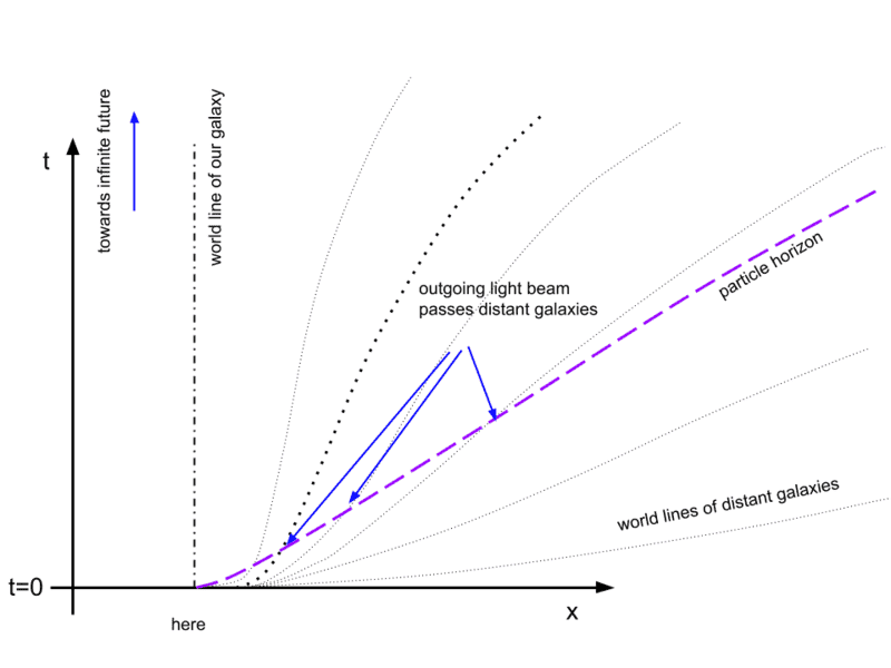

Particle horizon marks the reach of the signal emitted from 'here' at t=0.
Spacetime diagram with time t on the vertical axis and space x on the horizontal axis; a dash-dot vertical line marked world line of our galaxy, dotted curves for distant galaxy world lines, and a dashed line marked particle horizon.
As the signal passes consecutive galaxies on its way, the t=0 signals from those same galaxies reach the 'here' spot at the same moment.
The particle horizon is the farthest we can see at any given moment in the cosmic time. It's the farthest world line from which light could reach us. But it says nothing about how much of the world line - i.e. how much of the history of a galaxy at that spot - will be observable. That's what the event horizon determines:
Spacetime diagram with time t on the vertical axis and distance x on the horizontal axis, showing world lines of galaxies A and B, the event horizon, the particle horizon, and observable and unobservable events.
To reiterate: the particle horizon and the event horizon provide answers to two different questions. PH tells us what is the farthest spatial coordinate (in the comoving sense - heuristically, the farthest galaxy) from which light signals are reaching us now. EH tells us what range of space-time coordinates can ever be observed - or, in other words, what is the last thing (if any) that we could see from any given place.
(Note: these are eyeballed drawings, not graphs - while they were made to somewhat resemble the real thing, the scaling and the curves will be off. For properly drawn graphs refer to the calculators mentioned in the OP, or to fig.1 in the paper linked in post #2)

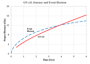

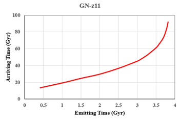

To illustrate this point, we continue to use GN-z11 as an example. Let’s draw an imaginary line from our location to GN-z11 and use D to represent its proper distances at various times. Starting from t = 0.410 Gyr and D = 2.66 Gly, GN-z11 moved away from our location along the line. Around t = 3.89 Gyr, it reached the event horizon at D = 12.0 Gly, as shown in the figure below:
Line graph titled GN-z11 Journey and Event Horizon, plotting proper distance (Gly) against time (Gyr); a solid red curve for GN-z11 and a dashed blue curve for the event horizon cross near 4 Gyr at about 12 Gly.
Any light emitted by GN-z11 outside of the event horizon will never reach our location. We are, therefore, interested in knowing when will the lights emitted during the portion of the journey with D < 12.0 Gly and t < 3.89 Gyr arrive at our location. The calculated result using the two calculators mentioned in this thread from t = 0.410 to t ≲ 3.89 Gyr is shown in the following figure (the calculations were somewhat tedious):
Line graph titled GN-z11 plotting arriving time (Gyr, y-axis 0 to 100) against emitting time (Gyr, x-axis 0 to 4); the curve rises gently then steepens sharply near emitting time 3.8 Gyr.
Note that while the light emitted at t = 0.41 Gly reaches our location at t = 13.8 Gyr, light emitted at t = 2 Gly will reach our location around t = 30 Gyr. As GN-z11 approaching the event horizon, the increase of arrival time becomes even more rapid, indicating that the journey of the photons is further prolonged. For example, light emitted at t = 3.8 Gly will reach our location around t = 90 Gyr. This trend is consistent with the property that lights emitted after GN-z11 moved out of the event horizon (around t = 3.89 Gyr) will never reach our location.

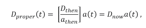

Equation: D_proper(t) = D_then / a(t) = D_now a(t). The proper distance at time t equals the comoving distance at the then epoch divided by the scale factor a(t), which equals D_now times a(t).
Text reading 'Correction:' highlighted in yellow, followed by the line 'The above equation is incorrect. It should be,' with the equation not shown.
Equation: D_proper(t) = [D_then / a_then] a(t) = D_now a(t), where D_proper is proper distance at time t and a is the scale factor.
Equation text: where a_then = 0.0827 at z = 11.09.
