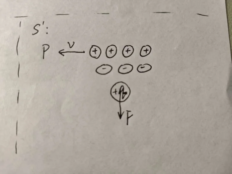

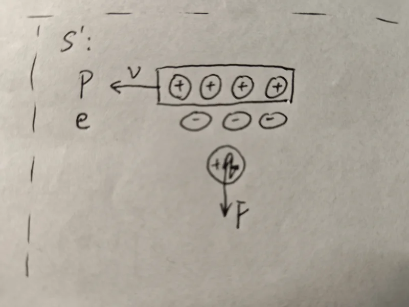

Here is the question. Why force is perpenducular to the object's velocity? In frame ##S'## the force is perpenducular to the conductor(in my case)

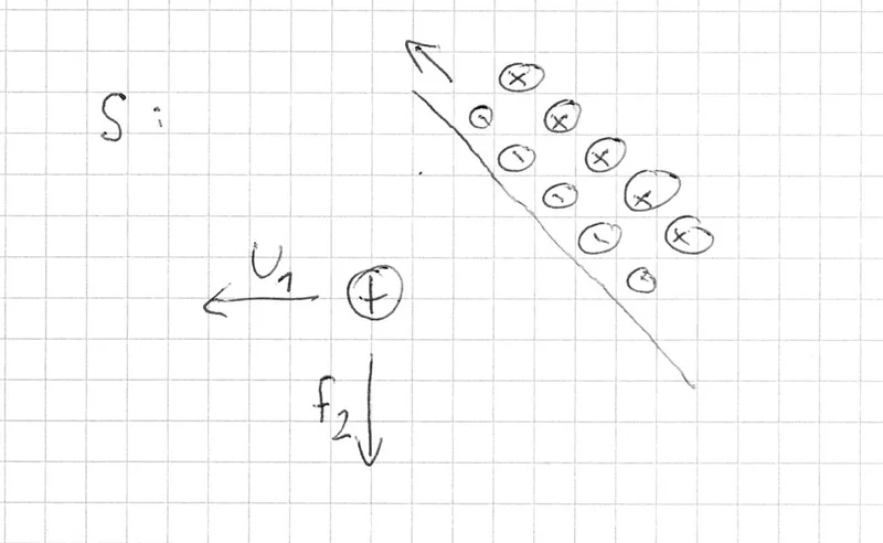

Does my picture in posting #26 describe correctly your case in lab-frame ##S##?

Sagittarius A-Star said:
I don't think so, because in frame S′ the conductor is not oriented horizontally.
You might be right here. My statement above was based on symmetry w.r.t. the normal to the conductor that passes through the test charge. I think it would apply to a long charged rod without a current flowing through it.
But here the negative and positive charges are moving in different directions, so their fields are contracted along different axes, which eventually breaks the above symmetry.
It also makes sense that a boost perpendicular to a force doesn't change its direction.

Thanks! You are right. I really dont know the details about Maxwell's equations and Lorentz transformation, so can you give me some advices that where should I begin my study of these laws, as I am only a beginner.
except the force, cause I don't know the force's direction in frame ##S## now.

JiuBeixin said:
In frame S′ the force is perpenducular to the conductor(in my case)
That was my initial assumption too, because it's true for a charged rod without a current, but not necessarily for one with a current. See my post #33.
At @PeterDonis wrote in posting #4, the Lorentz force is
##F = q \left( \vec{E} + \vec{v} \times \vec{B} \right)##.
If there is no electic field in frame ##S##, then the cross product remains, which is perpendicular to the velocity and to the magnetic field.

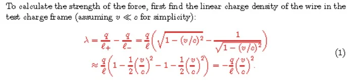

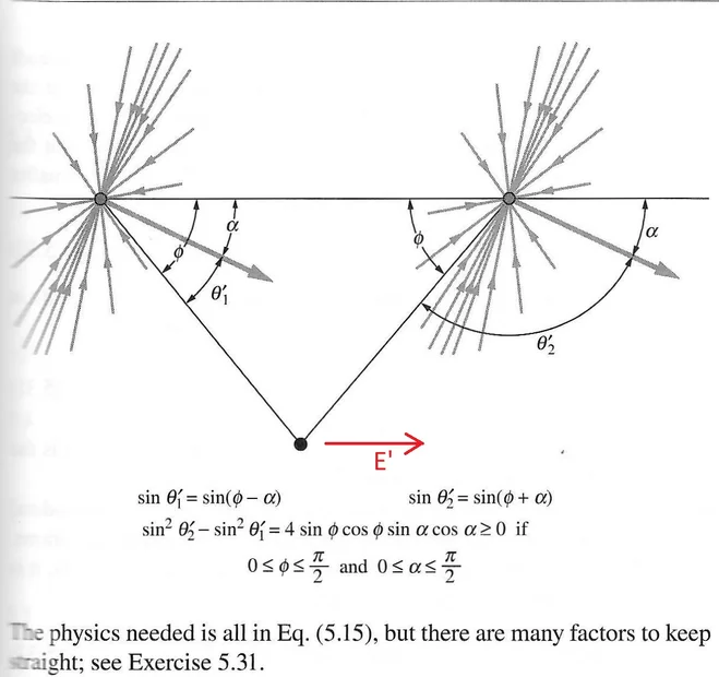

I think that cannot be, because Purcell does a calculation of the electric force in the rest frame of the object via lenght contraction (not only a qualitative explanation). The calculation result fits to the force transformation formula.
Here is a simplified calculation:
https://physics.weber.edu/schroeder/mrr/MRRtalk.html

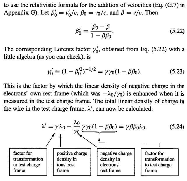

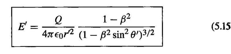

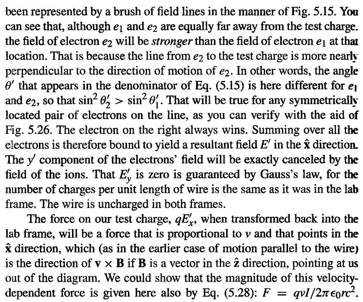

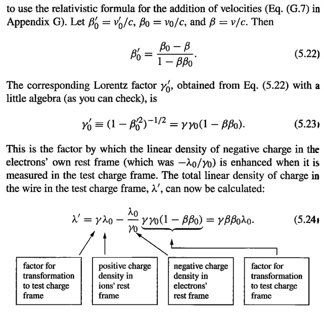

The simplified calculation, I linked to in posting #42, does an approximation for small ##v## in equation (1). But of course, the calculation could be changed to become exact.

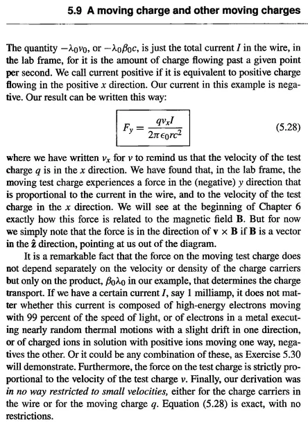

Purcell does an exact calculation in the book.
His calculation is also more complicated, because he calculates the more general case that the velocity of the object in the lab frame is not assumed to be equal to the velocity of the electrons in the conductor. He calculates the velocity of the electrons in the rest frame of the object by using the "relativistic velocity addition" formula.
His calculation goes over 3 pages. It gets also correctly, that the force in the lab frame must be by a factor ##1/\gamma## smaller than in the rest frame of the object.
This is his conclusion of his calculation:
Source (Electricity and Magnetism 3rd Edition by Edward M. Purcell, David J. Morin, page 263):
https://www.amazon.com/Electricity-Magnetism-Edward-M-Purcell/dp/1107014026?tag=pfamazon01-20

I think the point is, that for the charge line-density, the quadratic term in ##\beta'## is the first nonzero term.
The constant terms of the Lorentz contractions cancel out between the electrons and positive atom ions (I checked, that this is also valid for an exact calculation).
Source:
In the lab frame, the magnetic force is proportional to the product of the object velocity and the electrons velocity (which are assumed to be equal in the simplified calculation).
Conclusion: In this scenario (with assumption, that object velocity and electrons velocity are equal), magnetic force is a second order effect in (normalized) velocity ##\beta##.

Purcell calculates exactly the more general case that the velocity of the object in the lab frame is not assumed to be equal to the velocity of the electrons in the conductor.
In his calculation, in the restframe of the object, the charge line density is not proportional to ##\beta^2##, but to the product ##\gamma\beta_0\beta##. The electrons move in the lab-frame with ##\beta_0##.

I went over the calculation from Purcell from the references that others have posted - thanks to all who responded, by the way - and I can see why his argument works in the special case when the drift velocity, which I'll call v_d, is equal to the observer velocity. When v_0 = v_d = v, the result which is multilinear in both v_0 and v_d is second order in v. This is the same order as length contraction, so all is good in that case.
I see that others have posted another analysis by Purcell, which handles the case where v_0 is not equal to v_d. have yet to study this more general analysis and will have to read and think about it before I make a furthter response.
Reply
The effect of this on the charge line density might be an artifact of the constraint in the OP and in the linked simplified calculation, that object-velocity and electrons-velocity are equal.
I'm trying to untangle the notation. I am assuming that the lab frame, S, is unprimed, so all unprimed quantites are measured in S. And I am assuming that the primed quanties are measured in frame S' moving with velocity v relative to S. Further, I am assuming ##v_0## is the drift velocity of the electrons in S, and ##\lambda_0## is the linear charge density of the protons in frame S, (i.e. \lambda_0 is a positive quantity), which in frame S is equal in magnitude but opposite in sign to the linear charge density of the electrons because the wire is neutral.
Assuming this is all correct, we continue with the comparison. Because the results seem to agree with what I expect, I am assuming this is all correct.
[add]. To summarize the result from the attachment of Purcell's analysis:
$$\lambda' = \gamma \beta \beta_0 \lambda_0$$
To compare it to my notation, we need to introduce the current in the lab frame, which I will call ##I_0##, which I think should be equal to ##-c \beta_0 \lambda_0##, with the minus sign occuring because the electrons have a negative charge. This makes the charge density in the lab frame from this analysis reduce to ##-\gamma \beta \frac{I_0}{c} ##, which is essentially the result I got in my post #38 if we go to the equations I wrote before I assumed ##\gamma \approx 1##.
To recap, and to replacing the original volume densities I wrote in my original post #38 ##\rho## and current densities J by multiplying by the cross sectional area of the wire A, converting them into linear charge densites ##\rho## and currents I, while additionally adding in the factors of c which I omitted, we have:
$$\rho' = \gamma \left (\rho - \beta \frac{I_0}{c} \right)$$
Untis wise, ##\rho## in the above equation has units of charge/unit length, while I/c has units of (charge / second) / (length /second) = (charge / length), which checks.
[add]. For consistency, I should have replaced ##\rho## with ##\lambda##, but I didn't. They're both linear charge densities, I had just been using a different symbol.
My overall comment is that the equation I wrote above, which is based on the Lorentz transformation using the charge/ current four vector method, is to my mind easier, but I may be biased because it's the way I'm used to doing it - and it's also the way I trust - because it's the way I'm used to doing it. I think that using charge densities and currents is also friendlier and arguably more fundamental than using drift velocities which are based on the Drude model - the actual motion of the electrons in a physical wire is more complicated, but we can approximate them owith the Drude model as a constant drift velocity.

Length contraction is indeed a second-order effect in (normalized) velocity ##\beta##. But in the general case, Purcell derives the magnetic force not only from length contraction.
The term ##\beta\beta_0## comes indirectly into his charge line-density formula via the "relativistic velocity addition" for the electrons.

Purcell discussed also a scenario, in which, in the lab-frame, the object moves only vertically towards the horizontal conductor. Also in this scenario, the magnetic force in the lab frame turns out to be perpendicular to the velocity of the object.
In the object's restframe, the neutral conductor moves downwards towards the object at rest. The electrons in the conductor have a velocity component to the right:
Contribution of each charge in the (overall neutral) downwards moving conductor:
Source:

JiuBeixin said:
TL;DR: Exploring the relativistic origin of Lorentz force. I'm deriving how a transverse force (from length contraction) and a longitudinal force (from relativistic momentum compensation) combine to stay perpendicular to velocity.
I represent the conductor as two parallel lines: stationary protons and electrons moving at velocity ##v##. A test object with a positive charge also moves at velocity ##v## parallel to the electrons.
In frame ##S'## (the rest frame of the object), the object experiences a repulsive force (the origin of the Lorentz force) due to the length contraction of the moving proton line.
If I introduce an additional vertical velocity ##u## to the object in the frame ##S## the rest frame of the conductor), the entire conductor appears to move upward in frame ##S'##. Since length contraction only occurs in the direction of relative motion, this vertical shift seemingly shouldn't create any additional charge density imbalance, so there isn't any extra force.
Yet, someone told me that because of a kind of Transformation of Forces, the force in frame ##S## would be vertical, but WHT and HOW it transform?
PS: I am a high school student and not a native English speaker, so please excuse any grammar issuee and awkward phrase :)​
