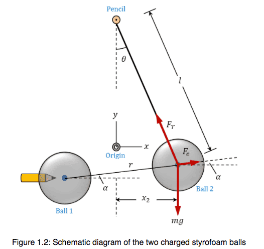

Show that the magnitude of the electric force on each ball is given by
Fe = mgtanθ/ (cosα+ sinαtanθ)
where θ = arcsin(x2/L)
α = arcsin((y2-y1)/r)
r = √((x2-x1)^2+(y2-y1)^2)
This is a question from my coulomb's law lab, where 2 styrofoam balls where charged, one was hung on a string and the other was brought closer to it from 20cm away and the change in the hanging ball position was recorded. (x2,y2) is the position of the hanging ball, and (x1,y1) is the position of the other ball that is moving closer to the hanging ball. r is the separation distance between the 2 balls. L is the length of the string that the ball is hung on. If this is not clear enough, please see these links:
question: https://imgur.com/a/IrkZl
diagram: https://imgur.com/a/UzzMu
2. Homework Equations
I am pretty confused about how to approach this problem. I drew the free body diagram for the ball and split the forces into their x and y components so derive Fe, and that hasn't got me anywhere. Whats a better way to do this?

You didn't include Coulomb's Law as the main Relevant Equation, but maybe just because you figured it was obvious. :smile:
So you get Fe from Coulomb's Law and the separation distance r, right? Once you have that, the rest is just trigonometry to solve the sum of the forces on the hanging ball in the x & y directions are each zero. Can you show us your work so far?

ngiro0862 said:
How can I use Coulomb's Law if I don't know the charges?
Just leave the charge as a variable Q for now...
ngiro0862 said:
I also tried breaking the forces into x and y components but I don't think I can find the tension force without knowing Fe, unless T=mg?
Do you have the same FBD as the original problem? If Ball #1 is below Ball #2, it will unload some of the string tension according the angles...
Yeah it's identical! I thought that was the case, but I was trying anything.
