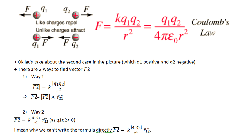

sorry I have use the image I made. Since I don't know how to perform the formula on forum :(
This is the problem I am having.
Hello Rookie, :welcome:
You would miss the direction of ##\vec F## if one of the two charges has a charge opposite to the other...
In other words: ##\vec F## can be in the same direction as ##\vec r## or it can be in the opposite direction.

Oh my god. I've just realized without the absolute symbols. It would be more easier to express the direction. Oh my oh my thank you very much teacher :)

Teacher. There's one more thing I would like to ask. I see there are many formula using "charge density". Is charge density able to be negative !?
If a charge density can be negative, it is very much easy to express its direction. I didn't find any vector form E that use the unit vector to express direction. They mainly focus on the magnitude.
With ##\vec F = q\vec E\ ## you can use (almost) the same expression
Charge density can be negative, yes: negative charge leads to negative charge density :smile:
