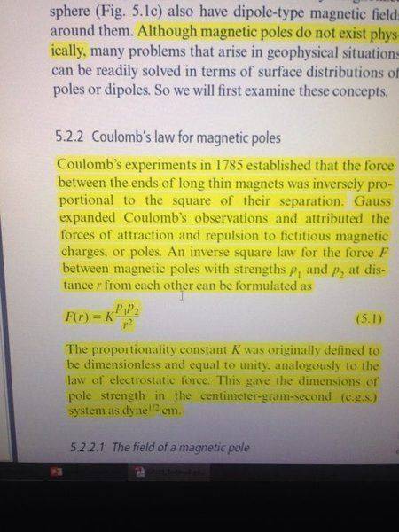

- What are the units of P1 and P2 in Coulomb's law for magnetic poles? (picture attached).
- What is the accurate name of 'P' : magnetic pole strength? Magnetic pole intensity?
PS: Sorry if my questions are too basic for this forum- I am not a Physicist.
have a read of this page ...
http://electricalstudy.net/lesson/magnetic-poles-and-coulombs-law/
should answer your Q'sDave
