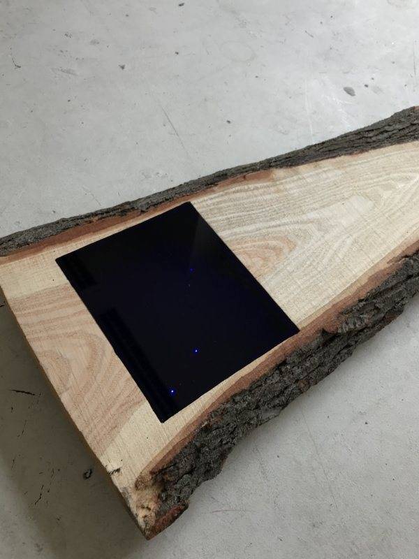

The moving part will be the sun which is going to be lit up, I was thinking that it will orbit the galaxy which is going to be suggested by the object on the floor possibly similar to the one in the photo. But it is not established yet and to be honest I love the black hole idea!
Thanks for the suggestion I will look into the method you described.

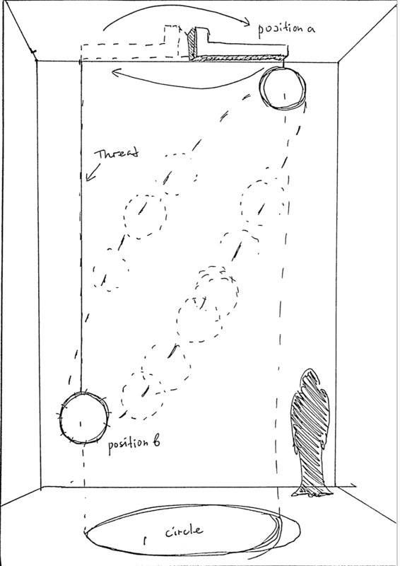

Here is something I sketched out, I hope it won't make things more confusing, hehe. It basically shows two extremum points of the movement the way I have initially thought about this.

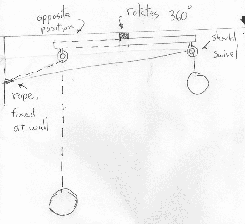

If the end of the rope that is fixed at the wall is far enough away from the rotating arm then the motion of the sphere is nearly elliptical with the plane of the ellipse tilted at a 45 degree angle from the floor?
@Spinnor: That's what I was thinking about.
It doesn't have to be a wall, mounting something to the ceiling works as well as long as it is outside the area the rotating arm covers and ends lower than that arm.
Thanks for the replies guys, I will try it with the method you suggested, however I will only have the opportunity to work on it full-scale in September. For fun here is the link to a quick prototype I made today from the sketch of Spinnor https://we.tl/t-fru9vbzPRp .
I think I like the elegance and straight-forwardness of this method but I am a bit afraid that the rope will become too prevailing element of sculpture, but that will only be clear once I make a first full size try out.
You could use the right size fishing line, very strong and thin. You also might use a small pulley to reduce friction for the fishing line.
With regard to the ellipse, if using the post #10 method with a cord, an ellipse major chord length twice that of the ellipse minor chord based upon the diameter of the rotating arm can be created by using a single sheave pulley at the wall and a double sheave swiveled pulley on the arm with the end of the cord connected to the wall/ceiling location of the single pulley.
Additionally, by using a transparent fishing line, as suggested above, and painting the arm and its pulley assembly to match the room ceiling color and a similarly colored cover with a side opening for the wall or ceiling mounted pulley assembly you might minimize the distraction by those elements, at least for non-STEM viewers who are going to immediately start investigating how you achieved your ellipse motion anyway.
