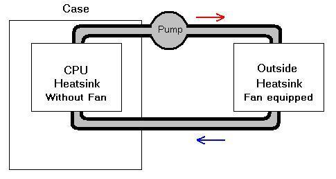

Hi all.
I want to create a Cooler for my CPU to better over-clocking
Because heat has a negative affect on cpu performance and because of my fancy.
I speak about a closed tube that a liquid is injected in it. It should be has a little vacuum, because when the liquid is heated and therefore expanded the tube has extra space to prevent exploding. Also a pump is inserted in this closed circuit somewhere to create flow.Both side (Cooling side and CPU side) has heatsink.
I want to know can it cool the CPU. Is it better than a single fan?
Is there an other liquid that was similar water but without the conductivity of water?Because water-if leak- can damage boards.
What is ur suggestion about this system to enhance it.
Thanks in advance

You can buy liquid coolers for CPU's. They have gone through all the design issues already.

In that case, I would still start with the commercial coolers - look at several, make sure you understand the design, and can reproduce the stated design parameters - in particular, can you calculate the cooling, and do you get the same answer the manufacturer claims? Only after that can you be relatively confident that you are ready to design one yourself.
You should probably learn about how air conditioning works, as it works in a similar manner. Additionally, if you're going to do it completely yourself, you should learn the thermodynamics math that goes with it. Otherwise, you might cool too little or cool too much, wasting power/money. Your local library should have a book on this, if it's well stocked, or you could look online.
I also recommend you purchase a cheap computer to test it on, in the event it doesn't function as planned. It would truly suck if you forgot one little thing and you overheater your overclocked computer. This way you can work out any design/construction bugs before you risk damaging your expensive computer.

There is a liquid for this purpose, but it's very expensive: Fluorinert, by 3M
I hope I spelled that correctly...
Anyway, it was used to cool some Crays and is still used in the electronics industry for researching part failures and developing high voltage power supplies.
oooh, I don't know about the bolded part. If you create a vacuum the liquid will probably boil off and fill it...no vacuum. Perhaps some space filled with air for the liquid to expand into, but that might cause pumping issues. Either way I don't think that's much of an issure. I imagine that properly chosen pipes should be able to easily expand to adjust to the tiny liquid thermal expansion.
Unless the liquid (water) freezes...
But yes, liquid cooling is generally much more efficient than air cooling.
