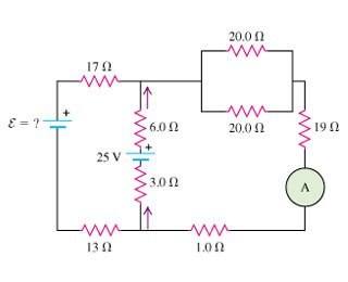

In the circuit shown in the link, the 6.0 \ohm resistor is consuming energy at a rate of 24.0 J/s when the current through it flows as shown.
A) Find the current through the ammeter A.
B) What is the polarity and emf of the battery \epsilon assuming it has negligible internal resistance?

Your link does not appear to work. Can you please upload the JPG as an attachment? Look for the little framed painting icon in the posting window to link to a JPG.

First thing is to parallel combine the two 20 Ohm resistors in the upper left part of the circuit. That simplifies things a little. Then write the 2 KVL equations for the 2 loops in the circuit, and solve for the unknowns.
Thank you. The problem was that I was assuming the current to be the same throughout the whole of the loops which was giving me some weird answers. Completely forgot about the junction rule.
