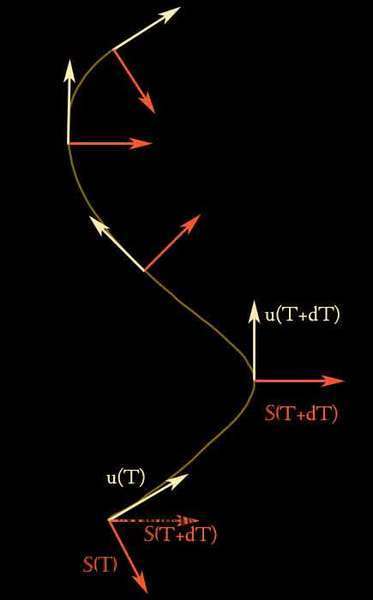

This is what I currently understand by parallel transport. The definitions I've read don't talk about it in quite this way, as a vector field, but I think this is equivalent to them:
Given a tangent vector V0 at some point P0, construct a vector field along an oriented curve P(?), where ? stands for any appropriate parameter, such that (1) the value of the vector field at P0 is V0, (2) there exists some parameter t for which dV(P(t))/dt = 0 at every point along the curve. This vector field is the parallel transport of V0, and a parameter that meets the condition in 2 is called an affine parameter because it can be transformed into any other affine parameter by an affine transformation, that is, a function whose rule takes the form or a linear equation a + bt. Proper time is one example of an affine parameter.
Now, I've just come across the idea of Fermi-Walker transport in Robert Littlejohn's notes on Thomas precession, linked to from the Wikipedia article on that subject. Fermi-Walker transport is defined by this equation:
[tex]\frac{\mathrm{d} s}{\mathrm{d} \tau}=-\left ( s \cdot \frac{\mathrm{d} u}{\mathrm{d} \tau}\right )u[/tex]
which he says is a "parallel transport equation, of which there are many kinds in physics."
This seems to be a different and broader definition of parallel transport from the one I'd previously encountered. Is one definition more prevalent than the other, or are they really the same in some sense.* If they are different, would people who use the narrower definition say rather: "There are many kinds of transport (of a vector) in physics, including parallel transport and Fermi-Walker transport"? In the dialect where Fermi-Walker transport is a kind of parallel transport, are there any non-parallel transports, and what special name (if any) is given to a transport whose derivative wrt an affine parameter is zero everywhere along the curve?
*I see the Wikipedia article Fermi-Walker transport mentions a thing called a Fermi derivative which it says is zero for a Fermi-Walker transport. It says this is in connection with a Riemannian manifold, but the examples it gives seem to be from general relativity. Unfortunately it doesn't define the parameter it calls s, with respect to which this derivative is taken [ http://en.wikipedia.org/wiki/Fermi-Walker_transport ], whether this is arc length or any parameter or an affine parameter. Does each kind of parallel transport, in the broader sense, have its own specially defined derivative which must be equal to zero?

Sorry, I should have explained more. There are so many different notation conventions! By s, if I've understood correctly, he means a 4-vector field defined along a timelike curve with the constraint that its value at each point on the curve is orthogonal to the 4-velocity of the curve at that point. So it turns out his equation is a special case of FW transport as you defined it. Your equation reduces to his when the vector field you called X in #3 is everywhere orthogonal to u because then their dot product is always zero, so the last term disappears.
On p. 5, RL writes:
So what does "in the same direction" mean in a relativistic context? As the spaceship follows its world line x superscript mu = x superscript mu of tau, at any given value of tau the angular momentum or spin s of the gyroscope is a vector that is purely spatial in some (hence any) instantaneous rest frame of the spaceship. Such a vector can be regarded as a 4-vector whose time component vanishes in a rest frame, that is, one that is orthogonal to the world velocity u, as indicated in Fig. 5.2. Thus we de ne a 4-vector with components s superscript mu = (0,s) in some conventional rest frame, and then de fine the components in all other Lorentz frames by doing Lorentz transformations."
By "conventional rest frame", I think he means an orthonormal basis for the tangent space at some point on the curve chosen so that its timelike basis vector is the 4-velocity at that point (the derivative of the curve wrt proper time), and its spacelike basis vectors (and thus its spatial orientation) are chosen by some arbitrary convention.
Okay, so provisionally (if my post #7 was right), I think we've sorted out the general definition of FW transport, thanks to Altabeh.
A linguistic detour paragraph. I notice that people talk about a vector field being transported, apparently meaning that some kind of field generated by a formula involving one or more derivatives (the exact details depending on what sort of trasport this is), whose value at each point depends on the value of the original vector field at that point, has values equal to zero everywhere that it's defined. So a proper velocity field might be said to be parallel transported along a geodesic, rather than (as I'd been thinking of it) an individual vector at some point being parallel transported, i.e. a parallel transport field being generated from that vector, which can then be compared to the proper velocity field and the question asked: are the values of the proper velocity field everywhere equal to the values of the parallel transport field of one (and hence any) value of the proper velocity field. Oh well, I expect I'll get used to the terminology as I read more.
Returning to the special case of FW transport that RL discusses, the creation of a vector field along a timelike curve, with nonzero acceleration, whose value at each point is orthogonal to the proper velocity of the curve so that
he talks about the values of this vector field as being derived by a "sequence of infinitesimal boosts". Boost can mean a coordinate boost or a boost of the vector itself. I think here it must mean boosts of the vectors themselves, since the values of the proper velocity field differ along the curve. I've been told that infinitesimal means a linear approximation, but I can't see how it can mean that here; how can a physical effect be due to an arbitrary human choice of how to approximate it? I'm going to try to put in my own words what I've learned and mislearnt, and maybe that will help focus on which bits are confusing me. I've filled in the gaps with some guesses, which may be wildly off the mark, so consider every statement here a question!
RL seems to be talking about a recipe for generating a vector field, given some initial value.
(1) s is a continuous vector field, but pretend for now that it's made up of discrete values at separate points along the curve. Suppose we know the value of s at some point. Parameterise the curve by proper time, T, so that that value of s at this point is s(0), and has a zero time component in the instantaneous co-moving inertial rest frame, ICMIF, associated with this point on the curve.
NOTE: RL says nothing explicitly about this discrete step, but I'm guessing it's implied in his formulas such as s(T + Delta T), since it makes as much sense to say the vector field is generated by the value of this as Delta T goes to 0, as it does to define addition by the rule: x + y = x as y goes to zero. And if Delta T is taken as not zero, it raises the question of what is the "next" real number after some value if T.
(2) For some mysterious reason (said by various sources to be due to the relativity of simultaneity, but why would a 4-vector, which exists independently of arbitrary coordinate representations, care about the relativity of anything?), it happens that the value of s at every point is orthogonal to the proper velocity of the curve. So, from the starting value of s, which we'll express as (0,s), its coordinates in an ICMIF defined by the inital proper velocity and some arbitrary choice or spatial orientation, we'll use the following iterative rule to generate the rest of the (discrete) values of s: let s(Ti+Ti+1) be obtained by the matrix equation L s(Ti), where L is the pure boost
[tex]\begin{bmatrix}<br /> \gamma & \gamma \textbf{v}^T\\ <br /> \gamma \textbf{v} & I+\frac{\gamma -1}{v^2}\textbf{v}\textbf{v}^T<br /> \end{bmatrix}[/tex]
with v the relative velocity (3-velocity) of u(Ti+1) in an ICMIF defined by u(Ti) and spacelike basis vectors obtained from the initial spacelike basis vectors by the same interative rule. And I is the 3x3 identity matrix. I am the 3x3 identity matrix ;-)
Q. Am I right in thinking that the coordinates of s(Ti) in the ICMIF so defined corresponding to u(Ti) will be the same as the coordinates of s(Tj) in the ICMIF so defined corresponding to u(Tj) for all values of i and j from 1 to n, the number of values in this discrete vector field?
EDIT: A. Must be. Reading on, I see RL deals with this in eq. (5.20). This only concerns spatial coordinates, but we already know the time coordinate is 0.
Q. For finite n, there will never be any Thomas precession for movement in a complete circle at constant speed?
(3) Find the limit of the vector fields generated by this process as the interval between neighboring values of T goes to zero and n goes to infinity. This will be the actual continuous vector field s, representing the spin or angular momentum of a gyroscope along a timelike curve with nonzero acceleration. This limiting process results in a vector field of spin vectors whose value at the end of a curve representing motion in a complete circle with constant velocity can somehow be different from the value at the beginning, and will thus have different coordinates in the same inertial reference frame. I don't understand how they can differ, but I can believe that weirdness could creep in where infinities are involved. To find out by how much they differ, integrate... something.
