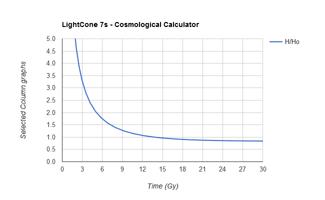

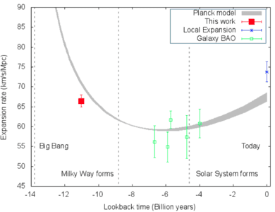

This is tangentially related to the topic of this post:
I found this graph which appears to show the Hubble constant transitioning from decreasing to increasing.
I have found on this site from marcus:
"Hubble's "constant" has been decreasing since the start of expansion and it is expected to continue decreasing but to level out in the long term."
This graph and this statement seem contradictory. I am likely misinterpreting something. Does the graph not show the Hubble constant?

The graph does not plot the Hubble constant over cosmological time, but rather against lookback time, as observed today. In essence, the horizontal axis does represent cosmological time increasing from left to right, but it has a different basis.
Marcus' statement refers to the Hubble constant as observers living at time T would have measured it. Here is what that same curve would look like against cosmological time.

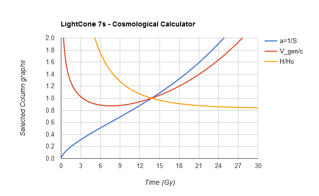

That lightcone graph you posted is the one I expected when graphing the Hubble constant , yet I found this other one in a peer review paper. I have seen both graphs with equal frequency on random websites which one obviously has to be careful of.
I understand the horizontal axis difference. The confusion I have is the vertical axis label is the Hubble constant (I could be wrong) but the curve looks like it is an acceleration of the Hubble constant. It shows the Hubble constant lower 6GY ago.
The lightcone graph should (I would think) show the same data from 0 to 14GYear (ie ignore data after 14GY for comparison). But they don't seem to as the first one has the minimum at 6GY ago; the lightcone graph does not match this curve and has no minimum. The graph I posted looks like the derivative of the lightcone graph.
I must be missing something as a number of people have replied, and none appear to see the point which creates my confusion.
There is a bit of confusion, because the term 'cosmic expansion rate' sometimes means different things in different papers. Some see the the first derivative of the scale factor as 'expansion rate', while others view the Hubble value H(t) as 'expansion rate'. I think the paper that you referred to falls into the first category, while here we have agreed that the second view is more appropriate. In Marcus' parlance, the red curve below is the recession rate of a generic galaxy (in this case one that is presently on the Hubble sphere). I think it has the same form as the "expansion rate" of the paper that you refer to.
Does this make more sense?
It's a pity Marcus is not around at present, because he has a succulent way of explaining all of this.
Jorrie, the graph with the 3 curves are of the form I am familiar with. The project I have been working on with my kids yielded almost identical (within 15%) graphs directly from quantum effects. This project is what led to my original question; we currently trying to test the results of the project to the known data. I know this site does not allow (for very good reasons as most are wrong and/or misleading) personal theories, so I will not post any graphs. We have started this project from an Engineering (EE) perspective, thus, my questions and terminology are way off from physics perspective/terminology. I will show them the Lightcone calculator in your signature; it looks awesome. Thanks!
The Lightcone graphs you have posted, your comments on the graph, and Marcus' explanation I quoted all make complete sense.
Unfortunately, I am still confused how the first graph (not originally found on this website) is correct.
The vertical axis units are labeled "Km/S/Mpc". How can this be a derivative of the Hubble constant? I thought Km/S/Mpc (effectively; 1/s) was the the units of the Hubble constant. The numeric values also fall into the proper range of the Hubble constant's expected value, yet it follows the shape of the red line on the lightcone graph which, as far as I can tell, can't have those units.
I still am missing something...any help appreciated.
In some previous thread Marcus and I agreed that we should call the red curve the 'recession rate' and the gold curve the 'expansion rate'. The latter is like an interest rate, a certain % growth, independent of the amount of money. One could say that this is the "expansion rate of your investment". In our cosmos, it is today about 1/144 % per million years.
In the case of the red curve, we look at the recession rate of one galaxy that was originally very close to us and was receding from us a high rate per unit distance (Mpc). During decelerating expansion, the rate dropped and during the late accelerated expansion, the rate increased. Hence the minimum at around year 8 billion.
Edit: In our case, "the bank dropped the interest rate faster than our money could grow to compensate". However, lately the amount of money became large enough so that it compensated for the drop in interest rate and the interest rate is stabilizing towards a more constant value. Our money is starting to show proper exponential growth, as one would expect from compounded interest at a constant interest rate.
I hope this helps.
What is the units of the red curve? Does this match the units , 1/s, of the graph I don't understand?

Is the lightcone graph on page1 consistent with: wa=0 and w0=-1?
By my understanding the first graph should have units of 1/s2. Any chance it is labeled wrong and this is the cause of my confusion?
The curves of the LightCone graphs on page 1 are highly normalized (hence all equal 1 at the present time) and all three are dimensionless. But we can laboriously un-normalize them.
More to the point, V_gen/c is dimensionless, so V_gen has the same units as c, i.e. km/s as used for Ho. The "generic" subscript was defined to be for a galaxy presently at the Hubble radius, so the units effectively become km/s/(Hubble radius). Now one Hubble radius presently equals 14400 Mly, or 4390 Mpc. So, the red curve can be converted to Km/s/Mpc by multiplying it by c (3e5 km/s) and dividing by 4390 Mpc. This simply changes the scale, not the curve itself.
The units of H is the same as Ho (traditionally km/s/Mpc), so essentially the two curves have the same units. This does not mean they represent the same function though. I think the graph in the paper is labeled for convenience and is correct.

I think 69911e referred to the LighCone graphs that I posted before and repeated above. The LightCone program only considers the LCDM model with wa=0 and w0=-1.
Now I understand. The same units, with the same name for 2 associated but different things is what I missed. Now we get back to applying this...
Thanks!
