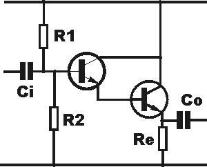

I have a small problem regarding darlington transistor pairs.
Lets say a source is connected to the coupling capacitor Ci and this source has an internal resistance of for example 10kOhms. When finding the Output resistance of the darlington, should the internal resistance of the source be taken in consideration?
Thank you
Note: The coupling capacitors are assumed equivalent to a short at signal frequency
  • Circuit schematic of a two-stage transistor amplifier with a Darlington pair, showing input coupling capacitor Ci, resistors R1 and R2 at the base, resistor Re at the emitter, and output coupling capacitor Co.
Yes, the internal resistance of the source is in parallel with R1 and R2.
