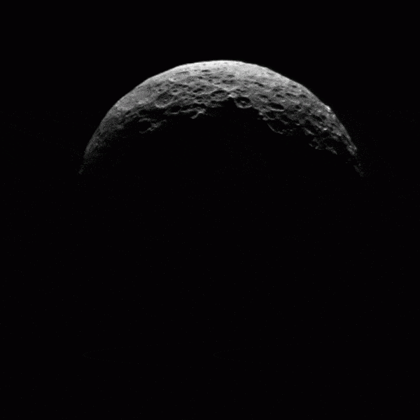

A new image was posted a couple of hours ago.
This animation shows the north pole of dwarf planet Ceres as seen by the Dawn spacecraft on April 10, 2015.
Dawn was at a distance of 21,000 miles (33,000 kilometers) when its framing camera took these images.
The spacecraft was maneuvering toward its first science orbit, which it will enter on April 23.

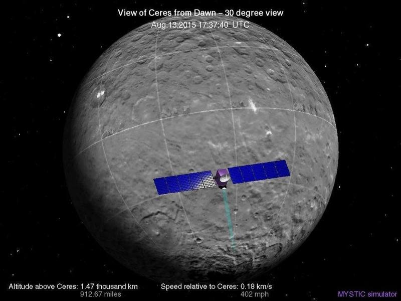

I suppose I can stop capturing these images now.
Things are getting a bit too dynamic.
And, just so I don't feel I wasted my time yesterday.

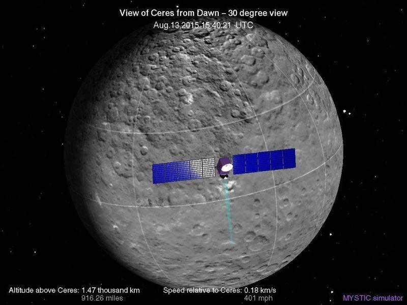

Here's an image of Ceres from a distance where Dawn was yesterday, which is conveniently my eye height to ground, of Dawn at LAMO orbit.
Ceres is my baseball, Dawn is some yellowish thing that fell out of my big leaf maple tree, and my toes are in the general direction that Ceres is moving in.
Dawn is not to scale.
And as Dr. Rayman says; "This is only a simulation."

  • #342
Speed went down for the first time! since the probe started spiraling into circular orbit. At least on the simulated view. This morning it had crept up to 161 mph, but a new fullview2 update as of 19:30 UTC shows it eased back to 160 mph.
I guess this means we can proceed with our plans to colonize the planet, Om. We need to figure out how to best to excavate air-tight bubbles deep in the ice for the colonists to live in. And how to provide cheerful lighting and amusement facilities.

We will know it's passing over S pole when we see a "half-Ceres" phase.
And then the probe should not be crossing the terminator at 90 degrees, from light into dark. It should be crossing into the leftthand dark quadrant. Like at an angle of 95 degrees, instead of 90. That way when it comes back over the N pole, from dark into light, it will be heading into the righthand light quadrant, say at an angle of 85 degrees. (usual counterclockwise angle convention taking terminator as x axis)
By that time it may be going only 150 mph, which would be 67 m/s or RC3 orbit speed assuming the Ceres mass of 943 billion billion kg. Just guessing.
Of course fullview2 could be using the wrong mass and be wrong many ways, but so far it is telling a consistent story and I haven't seen a good reason to doubt it.
