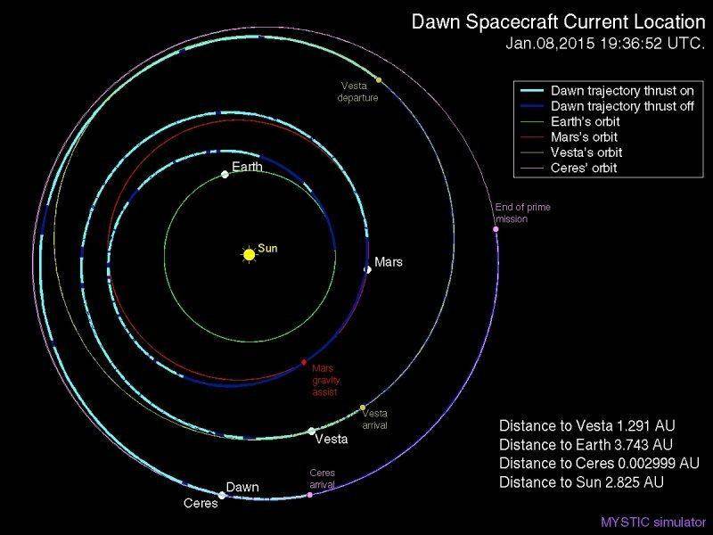

Today, for the first time, the Dawn craft is within 0.003 AU from Ceres. that is, it is less than 1.5 light seconds from goal.
The actual figure they gave as of 8 January just now, when you googled "where is Dawn now?" is 0.002999 AU
http://dawn.jpl.nasa.gov/mission/live_shots.asp

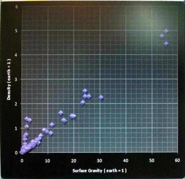

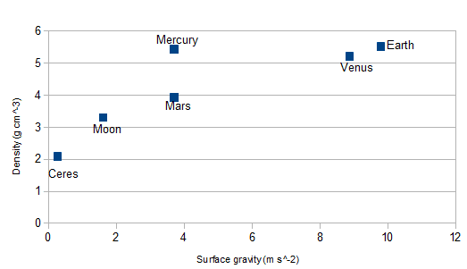

Small solid rocky bodies have average densities of ~3 tons per cubic meter. Ceres is only 2.
Mars has subsurface ice. Even our Moon does. And Ceres is colder still.
Knowing nothing else, I suspect that Ceres has lots of ice, vaguely like Mars

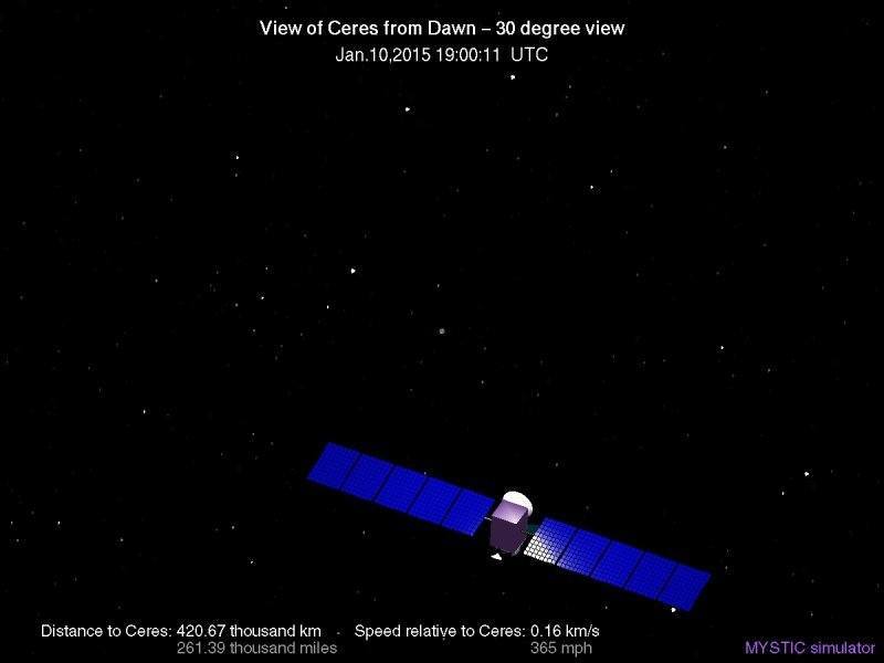

To keep us up to date on the approach to Ceres. The ratio of diameters to the moon is about 1000 km to 3500 km. So Ceres is about 28% as wide as Earth's moon.
The moon has an angular size of about half a degree. So we can estimate how big Ceres looks in the sky, seen from the spacecraft . The spacecraft is roughly as far from Ceres as we are from the moon so Ceres should look about 1/4 the size of the moon, and have an angular size of about 1/8 of a degree.
they have an illustration at the "live shots" website that is a kind of "diagram" of how Ceres would look from the spacecraft . It is a grayish brownish dot in the center of a frame that is supposed to represent a 30 degree field of view. The dot is small at present---as 1/8 of a degree is small in a 30 degree field. If the diagram is 8 inches wide on your computer then the dot is about 1/30 of an inch----like a 32nd of an inch on some rulers.
Over the next several weeks that dot will get bigger (if the public outreach people at Dawn office keep it current, and I think they will). More realistically, it should look like a half moon, with one illuminated hemisphere towards the sun, and one in shadow. Dawn is gradually overtaking Ceres along roughly the same orbit track. So it sees the "half-Ceres" phase. But the grey dot in the illustration is too small and schematic to show phases (at least so far).
Hey! I just looked at today's http://dawn.jpl.nasa.gov/mission/live_shots.asp
and today's view of Ceres from Dawn
and I saw a crescent or half-Ceres phase in the small diagrammatic dot. They put in that detail. You may not be able to see it in this attachment

The distance they give for today is 420,670 km and if I paste
"420,670 km in light seconds" into google I get 1.40 light seconds.
Moon's distance from Earth is 1.28 light seconds. So since the real size of Ceres is 28% of Moon,
the current angular size of Ceres is
28*1.28/1.40 = 25.6% of the angular size of the moon. At the moment.

Distance down to 1.346 light seconds. Enjoyed the droll movie about aliens :) I can't picture what Ceresians would evolve to be. Maybe they are just trees anyway.
In the simulated view of Ceres, from a position beside the spacecraft , the sunwards direction seems to be DOWN as the picture frame is presented. The bright-lit hemisphere of the planet is down, and maybe a little to the left.
I guess that could make sense, with the solar panels spread out nearly horizontal (but the simulation may not be trying for detailed realism.)
1.346 cs is near 1.28 cs the distance from us of the moon. As mentioned earlier, the real width of Ceres is about 28% of the moon's. So at the same distance it would look 28% as big in the sky.
About how it looks now, I'd guess, since the distance is nearly the same. Wish we could fast forward, I'm eager to see the real thing :)

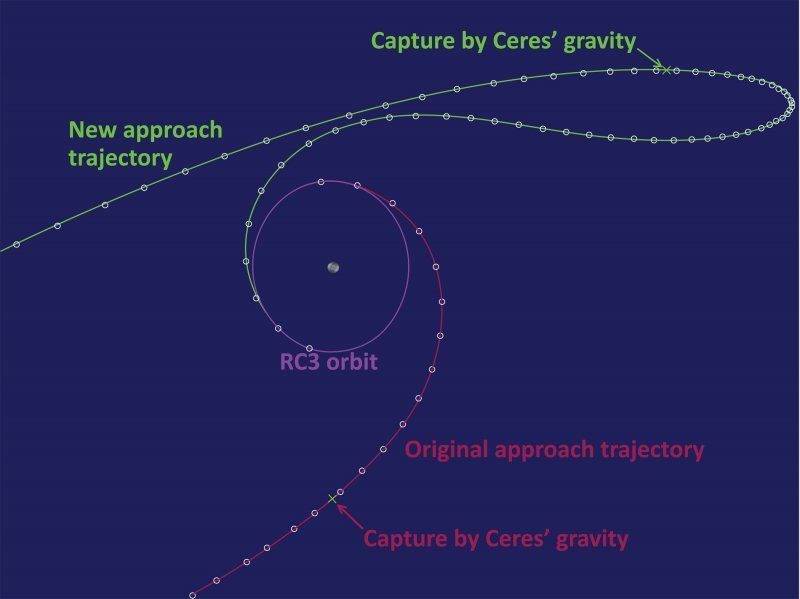

In this picture the original approach trajectory plan is in red. After an brief thruster outage in September 2014, a longer approach was planned shown in green. You can see the red trajectory comes in already at a slower speed (day circles closer together) is captured sooner and spirals into the target orbit in only a few days. The green trajectory comes in at faster speed (day circles farther apart) and OVERSHOOTS. It then kind of stalls and hangs there in a hairpin turn, with many day circles close together and then falls back towards Ceres and spirals in.
They are conserving their hydrazine resource which must be used to orient the ship because two gyro wheels can't be used. The main thrust is always the solar electric xenon ion beam (shown as blue green tail in some of the illustrations). Hydrazine is used for orienting the crafts attitude.
I'll try to find out more about what went into replotting the approach trajectory.
In the diagram, the sun is far to the left. Ceres orbital motion is directly IN TO THE PICTURE. The spacecraft is running roughly parallel to Ceres in orbit, but slightly closer to the sun. So since the sunward direction is to the left, craft is shown as coming in towards Ceres from the left.
It is also like Ceres, in orbit around the sun, so it is also moving into the picture frame.
This illustration is from http://dawnblog.jpl.nasa.gov/2014/11/28/dawn-journal-november-28/
where there are more diagrams and explanations.

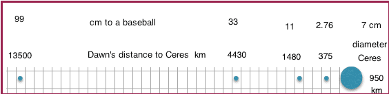

I doodled these distances relative to the size of dawn, but still had trouble visualizing what Ceres would look like, so I dug around the house, and found a baseball.
At its lowest orbit, it's the equivalent to looking at a baseball 1 inch in front of your eye.
That seemed a bit close, so I calculated the ISS orbital height in terms of baseball scale, and discovered that it orbits only 2.3 mm above the earth/baseball surface.
At which point, I took off my glasses, and poked myself in the eye, with my baseball.

As for density, I understand density is influenced by gravity, with more massive rocky planets having more surface gravity which squeezes them to higher density, even for the same bulk composition
Perhaps someone could plot average density as a function of surface Gs say for mercury Venus Earth moon Mars and see what shows?
Density is influenced both by the planet's mass (which leads to gravitational compression - not surface gravity! Saturn for example has a "surface" gravity of 10.44 m s-2, not that much different to Earth due to its larger mass but (comparatively) much larger radius, but its interior experiences far more gravitational compression than Earth's due to the weight of much more surrounding material pressing on the core) and by its composition. So Mercury for example has much less gravitational compression than Earth but has a similar density due to it having such a large iron core. The Moon's density on the other hand is much lower than Earth's, partly because of its lower mass but also because of its much smaller iron core. (And of course the giant planets have a higher mass and lower density than any of the terrestrial planets, due to their composition.)
Density as a function of surface gravity wouldn't be very enlightening for that reason. Density as a function of mass, however, would reveal some gravitational compression. However, the compressed and uncompressed densities of these bodies have already been worked out, and can be shown in http://lasp.colorado.edu/~bagenal/3750/ClassNotes/Class15.16/DensityTable.jpg.
Today I took my baseball out and photographed it at the appropriate distance: 83 feet
I blew it up, and it only had a resolution of about 13 pixels diameter. Since the Dawn team claims the resolution they will be taking should be 26 pixels, I replaced the baseball with a log.
Here is what I predict we will be seeing in a few days:
It's no wonder they didn't want to waste their efforts on an image at this stage.
Doh! The latest tweet says they will be imaging the planet on the 26th. Good decision!

TEFLer, I don't think I can help. For me the point is that they determined Ceres mass by observing deflection of less massive bodies (asteroids) in close encounters. And that told them the density was around 2 (say 2.2 g/cc). Assuming composition is mainly water ice and rock (density ~3.5) that told them how of the mass was water. Then based on a rotation period of 9 hours, they were able to reason that the planet must be differentiated into layers (a dusty crust, an icy mantel, a rocky core). Otherwise with the observed rate of rotation it would bulge out more around the middle---be more "oblate" or flattened.
BTW when we started the thread the probe's distance to Ceres was about 1.5 light seconds. It is now 1.08 light seconds.
Equatorial diameter is 950 km. Since it is roughly 1000 km we can get an idea of how big Ceres looks to Dawn right now. They tell us the distance is 325 thousand km, so the angular size is about 1/325 radians. About 1/6 of a degree

TEFLing said:
Qualitatively, surface gravity reflects the FORCES affecting the bulk of a planet...
And those FORCES are what would compress the planet
I was under the impression, that we knew Mercury had an anomalously large iron core, precisely because it is over dense for its surface gravity ...
Whereas Venus Earth moon and Mars are all on trend
Is that not true? Could someone possibly post and plot?
Here you go:
The Moon, Mars, Venus and Earth seem to lie in a pretty straight line. Mercury is a lot denser than its predicted value (presumably because of its huge iron core) and Ceres is a lot less dense (presumably because it contains a lot of ice).
I thought a bit about the origin of this straight line:
Surface gravitational acceleration g = GM/r^2.
Because ρ = M/V (where ρ is the density of the planet and V is its volume), for a spherical planet,
g = (4π/3)Gρr.
Surface gravity is therefore proportional to the density of the planet for a given radius, as all other terms are constant. I'm still not entirely sure where the straight line comes from though, since the Moon, Mars, Venus and Earth have very different radii. Or am I missing something key here?

Amaterasu21 said:
Here you go:
g = (4π/3)Gρr.
That is a great graph !
I think the straight line hints that all four of those planetoids have the same overall average bulk composition
Which gets squeezed and compressed by gravity
To higher densities for larger bodies
What is the y-intercept on the plot? Looks more like 3 than 3.5 to me
