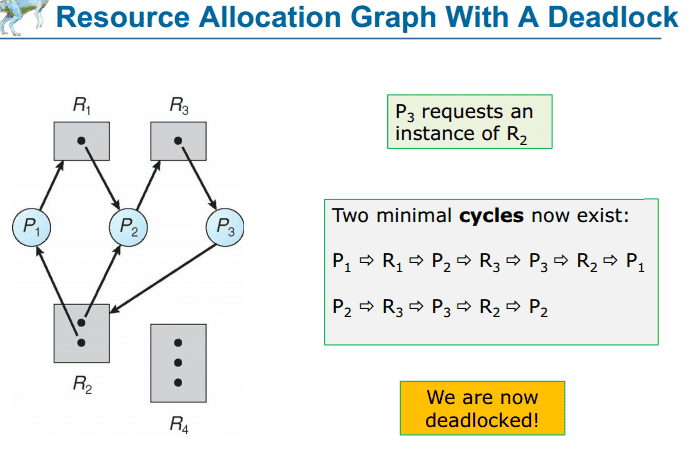

I have written the code, however i do not see how deadlocks can even be possible with this assignment. Since there is a monitor thread which automatically frees resources after their usage time is ended, there is no way a deadlock could occur. I thought one of the conditions of deadlock was that a thread would not give up the resource it has until it is able to access the resource it wants. In this assignment, the monitor will force threads to release resources so even if there exists a cycle, it will be broken by the monitor thread very quickly.
It seems like the Banker's Algorithm would be overkill for this assignment. Can someone explain how exactly a deadlock would be possible?
Would it not be the most efficient to just let threads access the resources they need (unless of course there are no instances of a needed resource) until they are all done?

When i say loop i mean a deadlock cycle, ie.
This deadlock cycle can occur with the code i have, however since there is a monitor thread which frees resources from processes, the deadlock will be undone.
If the monitor did not exist, then the deadlocks would be permanent.

Since there can be pseudo-deadlocks, should i attempt to trace a circle from one thread back to itself when it tries to acquire a resource?
ie,
Thread1 has already acquired Resource1.
Thread2 has already acquired Resource2.
T1 acquires R2.
T2 tries to acquire R1 but since R1 -> T1 -> R2 -> T2 -> R1, it is disallowed, using the logic from that diagram i posted.
When you say you want to "prevent deadlocks", you mean one of two things:
1) When a deadlock occurs, you don't want the system to hang - but it's okay if the application crashes.
2) You want to avoid a possible deadlock before it happens - by declining a claim.
The first case is pretty simple. All you have to do is detect a deadly embrace (each thread requesting the resource the other has), kill one of those two threads, and take its resources.
To do the second, you need to order the resources so that whenever a thread claims one resource, it also ties up all other resources that precede it in the order. If you know ahead of time which thread may need which resources, you can be loose with resources that are not potentially claimed by more than one thread.
For example:
Thread 1 will need A, C, E, and G
Thread 2 will need B, E, F, and G
Resources are ordered E, G.
Resources A, B, C, D, and F are unordered because they are uncontested.
Thread 1 claims A
Thread 2 claims F
Thread 2 claims G - this ties up E which precedes G in the order
Thread 1 attempts to claim E - but must wait.
The potential deadlock is thus avoided. Thread 2 is unencumbered and thread 1 has nothing that thread 2 might want. So eventually thread 2 will complete or reach another state that will allow E to be claimed by thread 1.
You can implement this, but the model provided in the exercise will not allow you to test it. To test it, you will need to change the model. After it is tested, you can change the model back - and, of course, it will still work, and it will meet the requirements of your assignment.
