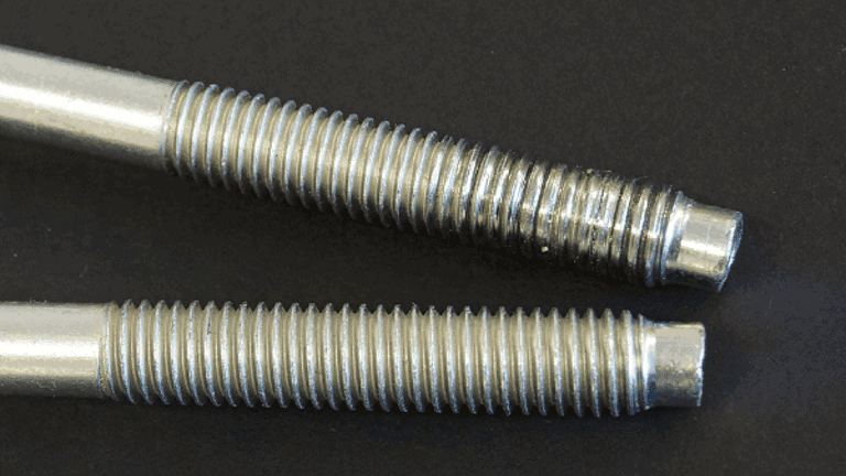

  4. Galling is less likely to happen.
Uncertainty during preload using torque
Threads damaged by galling
So it'd seem like lubrication, due to the reduction in friction, is always a good addition to threaded joints. However, the thing holding threaded joints together is friction itself. If it wasn't for friction, the screws would unwind returning to their original length.
In some situations, lubricants must be used even if that risks losing some preload which should be addressed with other measurements. Two examples of such cases are:
  1. Working with unlibricated stainless steel can be awful. Galling is a true risk that materializes pretty often in my experience. It may happen even before you start applying the preload when the head contacts the surface because it galled already on the way to get there.

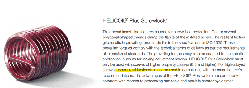

  2. Helicoils are a common practice in aerospace applications because they allow the use of smaller fasteners in weaker materials such as aluminum. Locking helicoils have a deformed thread which induces greater friction. This makes it very difficult for the fastener to completely unwind itself until it falls out. I'm not sure of its effectiveness in preventing the loss of preload. Here is a perhaps biased video because it's from Nordlock but I still consider it interesting. I started at 2:14 where it shows the results from the nut with the nylon insert which would be the closest to the deformed thread I was talking about. The point is that the manufacturer imposes the use of lubrication if such helicoils are used.
The way I currently rationalize the use of lubricants in threaded joints is that, even if it might make the loss of preload easier due to the reduction in the friction coefficient, the reduction in uncertainty during the application is worth it because you'll be able to reach a higher preload more consistently which will result in greater friction keeping the joint together even if the friction coefficient is lower. However, that argument falls apart if the application of preload is through other methods independent of friction such as turn-of-nut or measuring the extension of the bolt experimentally (extensiometric gauges, ultrasonic, micrometer, etc).

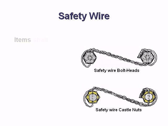

In high vibration applications you may need additional support like seizing wire, lock washers, lock-tite, etc.
I'll list some questions and concerns with the options you mentioned.
  • Seizing wire: I assume it's the same as locking wire or safety wire (non-native English). I don't have much experience with them but my concerns would be:
    • You need an anchor. If there is more than one screw, they can anchor each other.
    • The screws must be above a certain size. Right? I have trouble imagining this on M6 screws (approximately 1/4 inch) and below.
    • The screws must be compatible with the wire.
    • There must be a free "line of sight" between the screw and the anchor for the wire to be placed there or it must be routed through some space where it doesn't collide with other elements.
    • The operator must be properly trained to install it.

Of those options, the locking wire I think is the best one. I guess it's often used for a reason.
Parts could be designed with an anchor in place (even if it makes it a little harder / more expensive to manufacture) to be compatible with locking wire in case there isn't a coupled screw to be used as an anchor.
It doesn't damage the surfaces the way that locking washers do it and you don't have to worry about potential problems with adhesives.
The only negative point I can think of is that you could end with a pointy end from the wire. If exposed to radiation, it could be a starting point for electric arcs but it'd be under control as long as the parts are correctly grounded (easier said than done) so there can't be electric build-up over time.

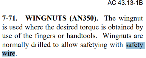

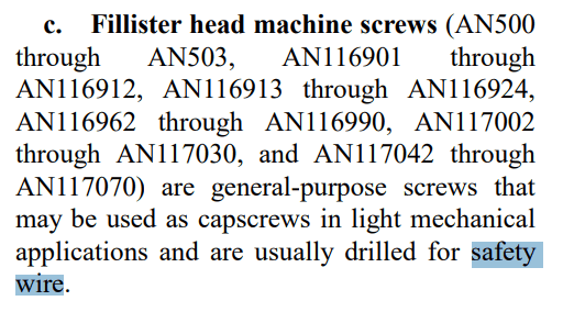

I have some questions about locking wire.
  1. Are screws with holes for locking wire defined by some norm? Drilling them myself feels wrong since I could damage them or, at least, invalidate their prior qualification. I have seen them in McMaster for hex heads and Northest Fastener and supply for head heads and socket heads for American pitches. I'm certain they must be defined by some ISO/DIN or even American norm that contains ISO equivalencies. Having them available as DIN 912 and DIN 933 would be great. (DIN 912 and DIN 933 are old norms and there are newer international ISO versions but those codes are still widely used)
  2. Same question as above but for nuts. The usual nut in Europe is DIN 934 / ISO 4032. Do people just drill them? It seems even more dangerous than drilling the head of a screw.
  3. What's the smallest size you have seen being used? If they are defined by some norm I guess I will be able to see the sizes there but I'm not sure yet if such a norm exists.
  4. Countersunk screws don’t seem compatible with this method. But what about counterbore screws? Is there a ready solution for a scenario like that? If not, I believe a large enough counterbore with smoothed edges might work.
  5. Is the locking wire qualified too? Does it follow its own norm (ISO/DIN/American norm)?

I have heard that before. I'll consider using it with locking helicoils.
The problem is that the friction coefficient is unknown in that scenario although it could be found through testing. Or the turn-of-nut method could be used instead.
Later, removing the fastener might be doable as long as the adhesive is not too strong. The remnants between the threads could still work to prevent galling. I'll have to test this approach in the future to confirm the procedure.

1. Yes, there’s several. Most of the ones I am familiar with are from aviation, are measured in SAE units, and are usually defined by AN, NAS, or MS spec/part number.
Drilling them yourself is not advised due to the precision required, unless you have access to a high-precision CNC machine to repeatedly do the drilling to the same specs.
You may occasionally see a mechanic in a shop drilling a wire hole through the head of a bolt or screw, but usually they’re doing it for a purpose other than for safety/lock wire. I know that we had several modified bolts kicking around the tool closet that were used as rig pins that had been drilled across the head to accept wire or string to hold a “REMOVE BEFORE FLIGHT” flag.
2. Similar to 1, but with the exception that nuts are usually castellated instead of drilled, as they’re intended for use with cotter pins and a hole drilled through the bolt they’re paired with.
There are locking nuts that feature a slight taper to the last few threads to provide extra friction. They’re usually not used for high-torque situations, but they’re quite frequently used for pretty much anything else. They are nominally supposed to be discarded after a single use, but as long as you get a good retention force, many mechanics will reuse them several times, only discarding them once their grip is significantly reduced.
3. Again, relying on SAE units, but the smallest I saw safety wire being used on was a 1/8th inch diameter screw. Below that, the torque limits are so low that you can get away with locknuts.
4. Correct, countersink is not compatible with any safety/retaining system on the head. Counterbore will not be either. If you need to secure the screw against rotation, you will either need to have a threaded bore into the part you’re referencing against to determine rotation, or use a tabbed washer, a suitable locking/castellated nut, and a retaining tab on the part being used as a reference to determine rotation.
5. I don’t recall off the top of my head, but purchasing it from any reputable vendor will provide acceptable quality. The standards come into play when you install the wire, and that really depends on the technician installing it. I refer you to
FAA Advisory Circular 43.13-1B, Chapter 7, Section 7 for more details.
