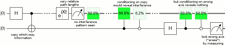

First thing's first, delayed erasure doesn't work the way you think it does. The interference pattern doesn't "come back", you measure the "choice" photon in a particular way then use it to group outcomes into buckets. Within each bucket there will be an interference pattern.
Because recovering the interference patterns requires the measurement outcome of the choice photon, there's no retro-causality required. The situation is more reasonably described as the earlier signal photon measurement outcome telling you how the choice photon's measurement result will be biased if you go with erasure.
Personally I find it all very obvious when simplified into a circuit diagram, though that's probably more to do with my familiarity with them than anything intrinsic:
