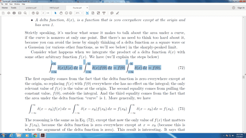

Prove the following
-∞δ'(x)*f(x-a) = -f'(a)
-∞δ'(x-a)*f(x) = f(a)
[/B]
-∞ δ'(x)*f(x-a) = ∫δ(x)*f(x-a)dx-∫f'(x-a)*δ(x)dx = f(-a) - f'(-a)
Went from 1st to second by integration by parts
Used integral definition of delta function to go to 3rd part
1) ∫-∞ ∞δ'(x)*f(x-a)
2) = ∫δ(x)*f(x-a)dx-∫f'(x-a)*δ(x)dx
3) = f(-a) - f'(-a)
Made above easier to read
