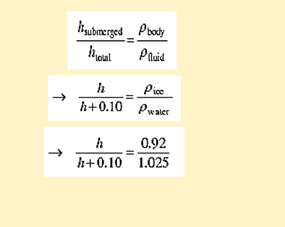

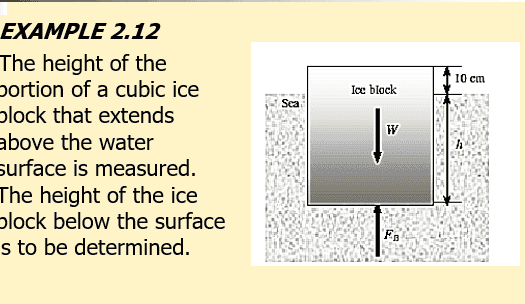

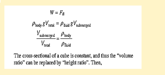

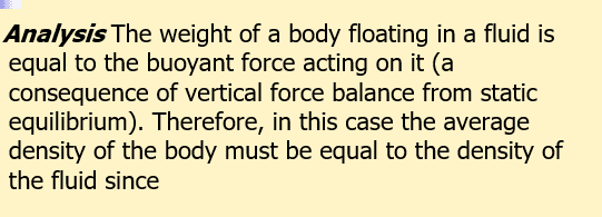

how can the average density of the body equal to the density of fluid(2nd photo) ? the object is not completely submerged in the liquid , so the density of object should be lower , right ?

You are correct. The statement in the text is incorrect.
