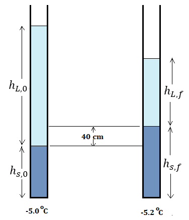

A long vertical column is closed at the bottom and open at the top; it is
partially filled with a particular liquid and cooled to -5°C. At this temperature
the fluid solidifies below a particular level, remaining liquid above this level. If the
temperature is further lowered to -5.2°C the solid-liquid interface moves
upward by 40 cm. The latent heat (per unit mass) is 2 cal/g, and the density of
the liquid phase is 1 g/cm3. Find the density of the solid phase. Neglect thermal
expansion of all materials.
So i think i am missing something pretty dumb, but anyway:
$$|\Delta P_{ressure}| = \rho_{s} g \Delta H$$
Claperyon equation:
$$\frac{\Delta P}{\Delta T} = \frac{\Delta L_{m}}{\Delta V_{m} T}$$
Equally both:
$$|\rho_{s}| = \frac{|\Delta T \Delta L_{m}|}{|\Delta H \Delta V_{m} g T|}$$
My problem is, how do i find ##\Delta V_{m}##?? Shouldn't it be given?

The phase change takes place at the interface between the liquid and solid phases. What determines the pressure at this location?
Also, I would recommend not taking absolute values in this problem. You will need to be careful with signs.

You have the ratio ##\frac{\Delta L_{m}}{\Delta V_{m}}## where, presumably, the subscript ##m## refers to molar values. However, the ratio is the same if you think of the ##m## as indicating per unit mass instead of per mole. (The data in the problem is given in terms of unit mass.) Can you express the change in specific volume, ##\Delta V_{m}##, in terms of ##\rho_s## and ##\rho_l##?

The trick to solving this problem is to tentatively assume that the density of the solid phase is very nearly equal to the density of the liquid phase.

Yes, i just got $$\rho_s = \frac{\Delta L |\Delta T|} {|\Delta H| g T} (\frac{1}{\rho_L}-\frac{1}{\rho_s})^{-1}$$, unfortunatelly substituing the numerical values give something very wrong ;P

Let's see exactly what you did. Incidentally, the equation should read: $$\rho_L = \frac{\Delta L |\Delta T|} {|\Delta H| g T} (\frac{1}{\rho_L}-\frac{1}{\rho_s})^{-1}$$

This looks correct to me. I'm assuming that ##\Delta H## represents the increase in height of the solid and ##\Delta L## is the (positive) latent heat. When you solve this symbolically for ##\rho_s##, what expression do you get?

Since the liquid is on top, why isn't the pressure change at the phase change interface ##\rho_L g \Delta H##?

That is a correct expression for the change in pressure if ##\Delta H = \Delta h_L##, where ##\Delta h_L ## is the change in vertical length of the liquid phase, ##h_{L,f}-h_{L,0}##. But, mass conservation implies ##\rho_L \Delta h_L =-\rho_S \Delta h_S## where ##\Delta h_S## is the change in vertical length of the solid phase, ##h_{S,f}-h_{S,0}##. So you can express the pressure change in terms of ##\rho_S## and ##\Delta h_S##.
