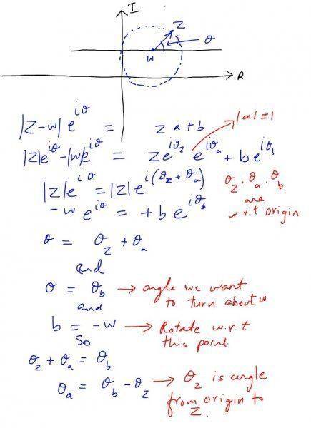

Dear all, can you please verify if my derivation of the algebraic formula for the rotation isometry is correct. The handwritten file is attached.
The derivation from the book (Alan F beardon, Algebra and Geometry) which is succinct but rather unclear is given below.

  • Handwritten derivation: an Argand diagram with axes I and R, a dashed circle centred at w, and points z, w and theta marked. Below it, equations |z-w|e^{iθ} = |z|e^{iθ} - we^{iθ} and related steps relating angles θ_z, θ_a, θ_b, with notes that b = -w is the point to rotate about.
I tried to arrive at my solution beginning with ## f(z) − w = a(z − w) ## and they both matched! but the reason for ## a !=1 ## is so that a will have imaginary part therefore an angle θ to rotate about??
The reason why ## |a| =1 ## is so that z is not proportionally multiplied/scaled ??

It's hard to follow the handwritten stuff, since there are no explanations in it. So I'll just comment on what you said here. You defined f by f(z)=az+b, so it follows immediately that if a=1, then f is a translation. Your definition of w makes sense if and only if a≠1, so I first assumed that the next step is to examine that case. But a few steps later, you wrote ##a=e^{i\theta}##, which only makes sense if |a|=1. So you should have stated earlier that the case you're investigating is a≠1, |a|=1. To show that f is a rotation around w when these conditions are met, it's sufficient to show that |f(z)-w|=|z-w|. I would say that your typed statements do that, but you could have included more details. We have
$$f(z)-w=az+b-w=az+w(1-a)-w= a(z-w)+w-w =a(z-w)$$ and therefore
$$|f(z)-w|=|a||z-w|=|z-w|.$$ As you can see, the assumption that |a|=1 is essential.
By the way, you should try to avoid notations like a!=0. The ugliness can be avoided by using the LaTeX code \neq, or just the ≠ symbol that you find when you click on the ∑ symbol in the editor. The notation a!=0 is especially bad since the most obvious interpretation of it is different from what you had in mind.
