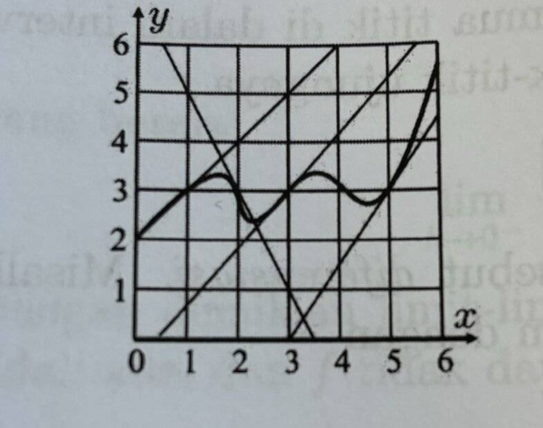

1. How to get f’(1), f’(2), f’(3), and f’(5)
2. How to calculate average speed change of y to changes in x in the interval [0,6]
3. Estimate value of f’+(0) and f’-(6)
pls help me about this graph, i dont know how to read this 🙏

I don't think acceleration is needed. In fact, maybe the questions are not about motion at all. Possibly the intended questions are these:
1. Find ##f’(1), f’(2), f’(3)## and ##f’(5)## (where ##f'## denotes ##\frac {dy}{dx}##).
2. Calculate the average rate of change of ##y## with respect to ##x## over the interval from ##x=0## to ##x=6##.
3. Estimate the values of ##f’_+(0)## and ##f_-'(6)##.

Btw, I do not like the ##f'(1)## part. The diagram is not drawn correctly for that case. The straight line matches the slope of the curve somewhere around ##x=\frac 12##, not at ##x=1##.
Yes. I'd draw some of the other tangents slightly differently too.

what my lecture explain when study before is just about what the definition about f’(x), in his explanation :
f’(x) = lim h->0 [(f(x+h) - f(x)]/h
and then :
f’(x) = 1/(2*sqrt[x])
no explanation in my lecture about somethink like read the graph in my op, also the graph type isn’t familiar for me
if i follow the equation, then f’(1) is :
1/(2*sqrt[1])
= 1/2
f’(2) :
1/(2*sqrt[2])
=1/(2*sqrt[2]) * sqrt[2]/sqrt[2]
=sqrt[2]/4
(So basically, i’m not read/analys the graph, i just substitute the value to equation, so what function the graph is?)
is that true for Q1? if yes i will try explain how i find the Q2, if its not true, pls explain me first for Q1 🙏

Good as an exact definition, but doesn't give you an intuitive grasp. In terms of the graph, it is the slope of the graph at x. The diagram has usefully provided tangent lines at the points you are asked about in the first part, and a tangent at a point of the graph is a straight line with the same slope there.

1. What is the gradient of the sloping straight line passing through the point (2, 3) on your graph?
2. Is this line a tangent to the curve at the point (2,3)?

Those tangent lines are there so that you can visually estimate the derivative at those x-values. Do you know the relationship between a derivative and the slope of a tangent line on the graph? For each tangent line, you can pick some points on it that will give you an easy slope calculation.
