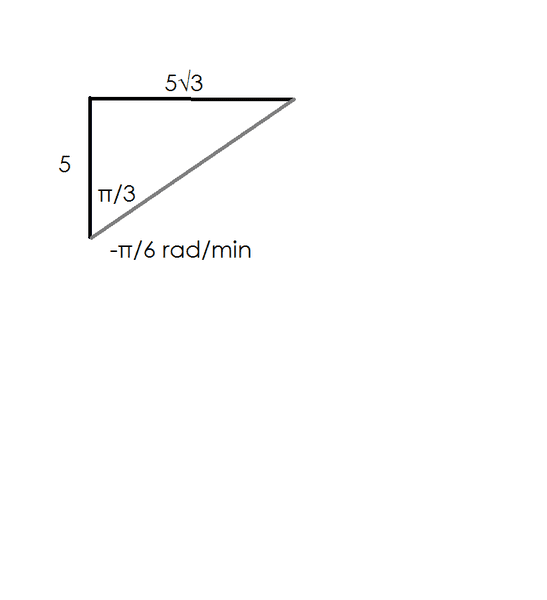

1. A plane flies horizontally at an altitude of 5 km and passes directly over a tracking telescope on the ground. When the angle of elevation is [itex]\frac{\pi}{3}[/itex], this angle is decreasing at a rate of -[itex]\frac{\pi}{3}[/itex] rad/min. How fast is the plane traveling at that time?
$$tanθ=\frac{opp}{hyp}$$
First I find the length of the top of the triangle, x. $$tan\frac{\pi}{3}=\frac{x}{5}$$ $$x=5\sqrt{3}$$
Then I take the derivative.
$$tanθ=\frac{x}{y}$$ $$sec^2x\frac{dθ}{dt}=\frac{y\frac{dx}{dt}-x\frac{dx}{dt}}{y^2}$$ The y, or altitude, is always constant so $$sec^2x\frac{dθ}{dt}=\frac{y\frac{dx}{dt}}{y^2}$$ $$sec^2\frac{\pi}{3}×-\frac{\pi}{6}×5=\frac{dx}{dt}$$ $$\frac{dx}{dt}=-\frac{10}{3}\pi$$
The answer from my textbook is $$\frac{10}{9}\pi$$ What did I do wrong? Any help is much appreciated.
Is the angle of elevation measured from the vertical or the horizontal?
Check the time-derivative of the equation: ##x=y\tan\theta##
I checked the time derivative of x=tany but I still get $$\frac{dx}{dt}=sec^2θ×\frac{dθ}{dt}×y$$
I've also attached a drawing.
  • Right triangle with a vertical leg labeled 5, a horizontal top leg labeled 5√3, and a hypotenuse drawn in gray; the angle at the bottom-left vertex is marked π/3, with the rate -π/6 rad/min written below it.
That's good: $$\frac{dx}{dt}=y\sec^2\theta\frac{d\theta}{dt}$$
Now you have your answer.

##dx/dt## is the linear speed.
##\sec(\pi/3)=2##
That leaves only the interpretation ... is the angle ##\theta## in that formula the angle of elevation?
See: http://www.mathwords.com/a/angle_elevation.htm
