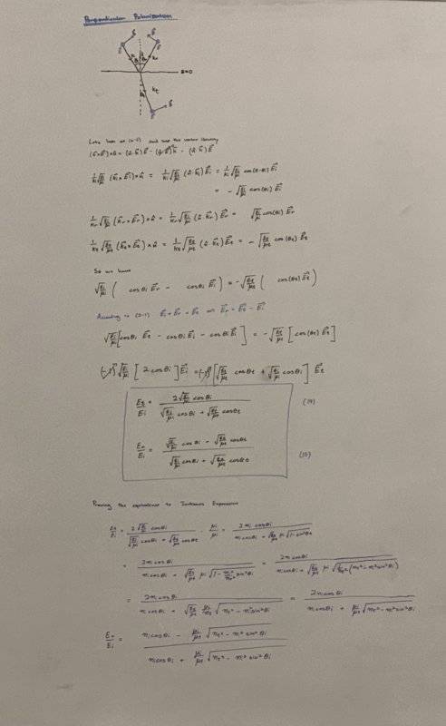

Derive Fresnels equation for Parallel Incidence using Maxwell's Boundary Conditions
Maxwell's BC's say the tangential component of field must be continuous across the interface $$\sqrt{\mu_i \epsilon_i} \left[ \frac{1}{k_i} \left(\vec{B_i} \times \vec{k_i} \right) + \frac{1}{k_r} \left(\vec{B_r} \times \vec{k_r} \right) \right] \times \hat{n} = \sqrt{\mu_t \epsilon_t} \left[ \frac{1}{k_t} \left( \vec{B_t} \times \vec{k_t} \right)\right] \times \hat{n}$$

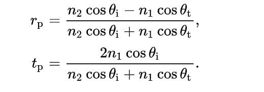

The correct equations taken from wikipedia are pictured in my attempt at a solutions
I'd first like to preface this post with the "right answer" per wikipedia (I've seen the same answer elsewhere on more reputable websites)

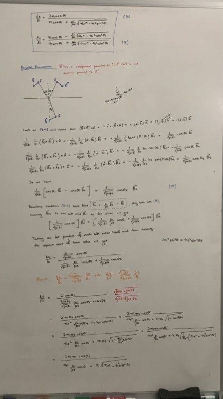

The thing I find trouble some is the cross terms such as ##n_2 \cos \theta_i## where indices of refraction are "mixed with the other angle".
I have meticulously applied Maxwell's boundary conditions namely that the tangential components of $\vec{E}$ must be continuous across the boundary. I'm positing that ##\frac{B_r}{B_i} = \frac{E_r}{E_i}## since to my knowledge their magnitudes are always related by constants.
the aforementioned Boundary Condition can be expressed as the following in terms of ##\vec{B}$ and $\vec{k}##;
$$\sqrt{\mu_i \epsilon_i} \left[ \frac{1}{k_i} \left(\vec{B_i} \times \vec{k_i} \right) + \frac{1}{k_r} \left(\vec{B_r} \times \vec{k_r} \right) \right] \times \hat{n} = \sqrt{\mu_t \epsilon_t} \left[ \frac{1}{k_t} \left( \vec{B_t} \times \vec{k_t} \right)\right] \times \hat{n}$$Using the vector identity
$$\left( \vec{B} \times \vec{k} \right) \times \hat{n} = - \left( \vec{k} \times \vec{B} \right) \times \hat{n} = -\left( \hat{n} \cdot \vec{k} \right) \vec{B} + \left( \hat{n} \cdot \vec{B} \right)\vec{k} = -\left( \hat{n} \cdot \vec{k} \right) \vec{B}$$
(since the magnetic field is orthogonal to the normal)
I'm going to do this term by term while paying close attention to the geometry
$$\frac{\sqrt{\mu_i \epsilon_i}}{k_i}\left( \vec{B_i} \times \vec{k_i} \right) \times \hat{n} = - \frac{\sqrt{\mu_i \epsilon_i}}{k_i} \left( \hat{n} \cdot \vec{k_i} \right) \vec{B_i} = - \frac{\sqrt{\mu_i \epsilon_i}}{k_i} k_i \cos \left( \pi - \theta_i\right) \vec{B_i} = \sqrt{\mu_i \epsilon_i} \cos \theta_i \vec{B_i}$$
$$\frac{\sqrt{\mu_i \epsilon_i}}{k_r}\left( \vec{B_r} \times \vec{k_r} \right) \times \hat{n} = - \frac{\sqrt{\mu_i \epsilon_i}}{k_r} \left( \hat{n} \cdot \vec{k_r} \right) \vec{B_r} = - \sqrt{\mu_i \epsilon_i} \cos \theta_r \vec{B_r}$$
$$\frac{\sqrt{\mu_t \epsilon_t}}{k_t}\left( \vec{B_t} \times \vec{k_t} \right) \times \hat{n} = - \frac{\sqrt{\mu_t \epsilon_t}}{k_t} \left( \hat{n} \cdot \vec{k_t} \right) \vec{B_t} = - \frac{\sqrt{\mu_t \epsilon_t}}{k_t} k_t \cos \left( \pi - \theta_t\right) \vec{B_t} = \sqrt{\mu_t \epsilon_t} \cos \theta_t \vec{B_t}$$
After invoking ##\theta_i = \theta_r## and ##\vec{B_i} + \vec{B_r} = \vec{B_t}## we have
$$\sqrt{\mu_i \epsilon_i} \cos \theta_i \vec{B_i} - \sqrt{\mu_i \epsilon_i} \cos \theta_i \vec{B_r} = \sqrt{\mu_t \epsilon_t} \cos \theta_t \vec{B_i} + \sqrt{\mu_t \epsilon_t} \cos \theta_t \vec{B_r}$$
Collecting like terms of $\vec{B_i}$ on one side and $\vec{B_r}$ on the other we have
$$- \left[ \sqrt{\mu_i \epsilon_i} \cos \theta_i + \sqrt{\mu_t \epsilon_t} \cos \theta_t \right] \vec{B_r} = \left[ \sqrt{\mu_t \epsilon_t} \cos \theta_t - \sqrt{\mu_i \epsilon_i} \cos \theta_i \right] \vec{B_i}$$
Taking the dot product of each side with itself
$$\left( \sqrt{\mu_i \epsilon_i} \cos \theta_i + \sqrt{\mu_t \epsilon_t} \cos \theta_t\right)^2 B_r^2 = \left( \sqrt{\mu_t \epsilon_t} \cos \theta_t - \sqrt{\mu_i \epsilon_i} \cos \theta_i \right)^2 B_i^2$$
After taking
(1) Dividing and taking the square root of the previous line
(2) Invoking the assumption that ##\frac{B_r}{B_i} = \frac{E_r}{E_i}##
(3) Using ##\eta = \sqrt{\mu \epsilon}##
(4) Using ##\frac{E_t}{E_r} = 1 + \frac{E_r}{E_i}##
We find the Fresnel equations for parallel polarization are

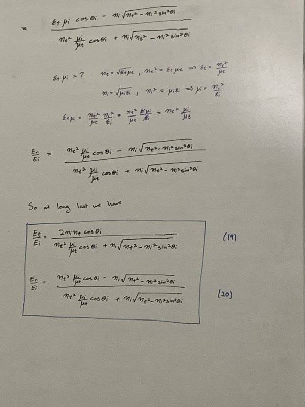

$$\left(\frac{E_r}{E_i} \right)_{parallel} = \frac{\eta_t \cos \theta_t - \eta_i \cos \theta_i}{ \eta_i \cos \theta_i + \eta_t \cos \theta_t}$$
$$\left( \frac{E_t}{E_i} \right)_{parallel} = \frac{2 \eta_t \cos \theta_t}{\eta_i \cos \theta_i + \eta_t \cos \theta_t}$$
My answers conflict with wikipedia which corroborates lecture notes from both Brown University and MIT, but I wasn't able to understand\follow the derivations in those notes. The most startling concern with my answer is the lack of "cross terms" such as $\eta_i \cos \theta_t$ and $\eta_t \cos \theta_i$ and the like which are present in the first picture I posted. At the same time I can't see anything wrong with my math and I can't fathom how these "cross terms" appear.
If anyone could provide helpful hints or point me in the right direction I would be greatly appreciative.
PhDeezNutz said:
Homework Equations: Maxwell's BC's say the tangential component of field must be continuous across the interface $$\sqrt{\mu_i \epsilon_i} \left[ \frac{1}{k_i} \left(\vec{B_i} \times \vec{k_i} \right) + \frac{1}{k_r} \left(\vec{B_r} \times \vec{k_r} \right) \right] \times \hat{n} = \sqrt{\mu_t \epsilon_t} \left[ \frac{1}{k_t} \left( \vec{B_t} \times \vec{k_t} \right)\right] \times \hat{n}$$
Should the factor of ##\sqrt{\mu_i \epsilon_i}## on the left side be ##\frac{1}{\sqrt{\mu_i \epsilon_i}}##?
Similarly for the right side of the equation.

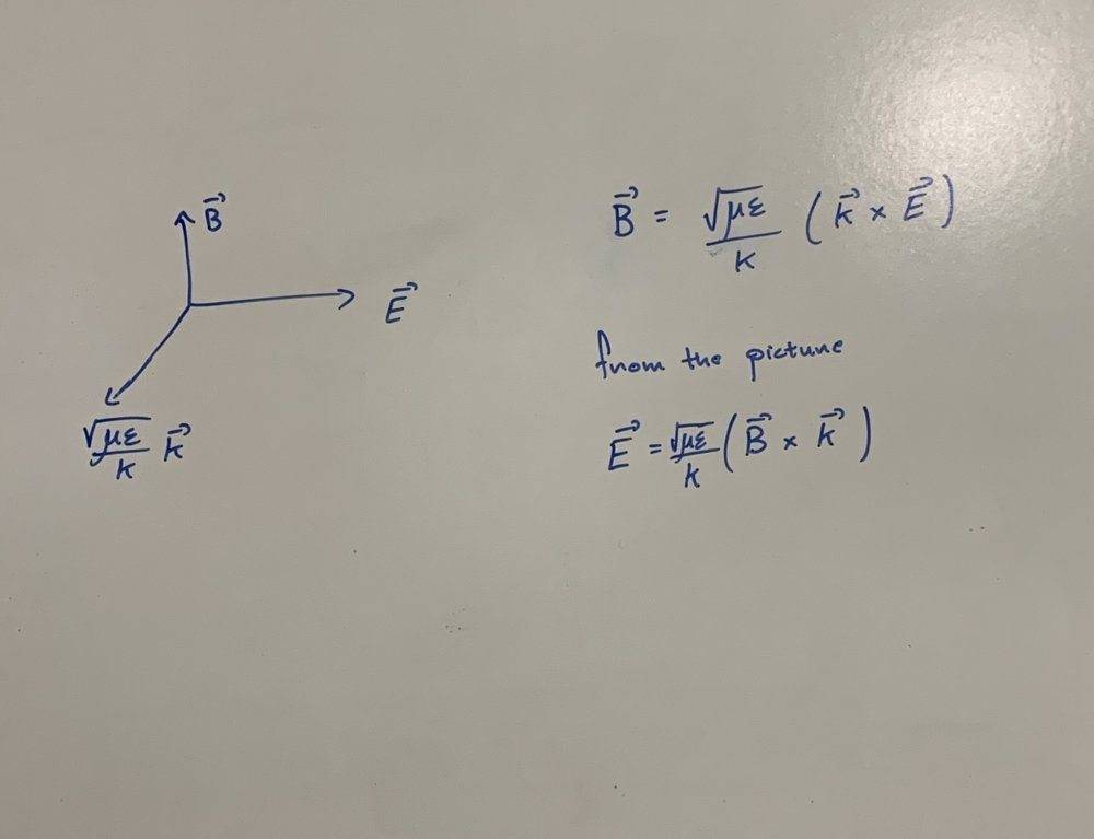

Thank you for responding.
Forgive me If I'm wrong, I thought the definition of ##\vec{B}## in terms of the wave-vector ##\vec{k}## was
$$\vec{B} = \frac{\sqrt{\mu \epsilon}}{k} \left( \vec{k} \times \vec{E} \right)$$
and consequently
$$ \vec{E} = \frac{\sqrt{\mu \epsilon}}{k} \left( \vec{B} \times \vec{k} \right)$$
The specific part you quoted was me trying to say that the "tangential components of ##\vec{E}## are continuous across the boundary".
Also, forgive me for jumping the gun but do you see where the so-called "cross terms" come from? I tried looking at ##\frac{E_t}{E_i} = \frac{\sqrt{\mu_i \epsilon_i} B_i}{\sqrt{\mu_t \epsilon_t} B_t}##
The best I could do was get the following
$$ \frac{E_t}{E_i} = \frac{2 \eta_i \cos \theta_i}{\eta_t \cos \theta_i + \frac{\eta_t ^2}{\eta_i} \cos \theta_t}$$
Which is "kind of like" the wikipedia answer but not quite; it has one cross term instead of the desired two cross terms.

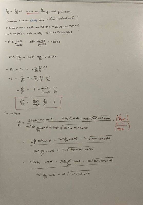

I'm glad you brought it up because I forgot to in my original post. You are right many of the derivations for Fresnel's equations invoke ##\mu_i = \mu_t = \mu_0## for both Perpendicular and Parallel Polarizations. However I was able to correctly derive the expression for perpendicular incidence without using that assumption. I'm hoping to do the same with Parallel Polarization.
I have two reasons for using the complicated cross product expression
1) It incorporates the index of refraction which is what the wikipedia final answer is in terms of.
2) Using the vector identity (and the picture) allows us to get rid of terms and we get a final expression of
Are you saying this statement would have been apparent without the cross product condition? If so I don't see it.
I appear to only be using one boundary condition but I'm actually using 3 of the 4. Two of which are being implicitly assumed.
I might as well state them for completeness.
$$ \left(\vec{B_i} + \vec{B_r} \right) \cdot \hat{n} = \vec{B_t} \cdot \hat{n}$$
$$ \left(\vec{B_i} + \vec{B_r} \right) \times \hat{n} = \vec{B_t} \times\hat{n}$$
$$\sqrt{\mu_i \epsilon_i} \left[ \frac{1}{k_i} \left(\vec{B_i} \times \vec{k_i} \right) + \frac{1}{k_r} \left(\vec{B_r} \times \vec{k_r} \right) \right] \cdot \hat{n} = \sqrt{\mu_t \epsilon_t} \left[ \frac{1}{k_t} \left( \vec{B_t} \times \vec{k_t} \right)\right] \cdot \hat{n}
I use the first two to substantiate ##\vec{B_i} + \vec{B_r} = \vec{B_t}## since ## \vec{B_i} + \vec{B_r} - \vec{B_t}## is both orthogonal and parallel to ##\hat{n}## meaning it could only be the zero vector.
I might try using the third boundary condition instead.
Yes. (I take it you're using Gaussian units, not SI units.)
and consequently
Here, you should have ##\frac{1}{\sqrt{\mu \epsilon}}## instead of ##\sqrt{\mu \epsilon}##.
Making the above correction should do the job.
ASIDE: It's certainly OK to use the vector cross-product equations to express the continuity of the tangential component of ##\vec E##. But, alternately, you can see from your diagram that this continuity can be expressed simply as
##E_i \cos \theta_i - E_r \cos \theta_r = E_t \cos \theta_t##
You also have ##B_i + B_r = B_t##.
Using ##B = \sqrt{\mu \epsilon}\,E## you can write both of these expressions in terms of just the electric fields or just the magnetic fields.

I can't convince myself that ##\vec{E} = \frac{k}{\sqrt{\mu \epsilon}} \left( \vec{B} \times \vec{k} \right)##

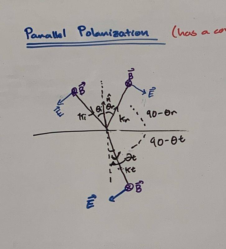

Geometrically speaking we have the following
Your diagram isn't correct. For example, if you take ##\vec E \times \vec B## according to your diagram, what do you get? Is it correct? Edit: Actually, there's nothing wrong with the diagram. It shows the correct orientation of the 3 vectors shown. But I think you are using the diagram incorrectly to get your equations in the diagram.
Also, suppose you take the magnitude of both sides of ##\vec B = \frac{\sqrt{\mu \epsilon}}{k}\left( \vec k \times \vec E\right )##. What does this imply for the relation between the magnitude of ##\vec E## and the magnitude of ##\vec B##? Then do the same for ##\vec E = \frac{\sqrt{\mu \epsilon}}{k} \left( \vec B \times \vec k \right)##.
According to my diagram ##\vec{E} \times \vec{B} = \frac{\mu \epsilon}{k} \vec{k}## is that not correct?
If we take the magnitudes of both sides of ##\vec B = \frac{\sqrt{\mu \epsilon}}{k}\left( \vec k \times \vec E\right )## we get ##B = \sqrt{\mu \epsilon} E ##
If we take magnitudes of both sides of ##\vec E = \frac{\sqrt{\mu \epsilon}}{k} \left( \vec B \times \vec k \right)## we get ##E = \sqrt{\mu \epsilon} B##oh....good point. Now I have to re-write my boundary conditions but I think it will get me somewhere.
Your starting equations will just have ##\sqrt{\mu \epsilon}## replaced by ##\frac{1}{\sqrt{\mu \epsilon}}## everywhere. So, you can just take the answer you got and make the same replacement.
This can't be correct. By definition of the cross product, ##\vec E \times \vec B## must have a result that is proportional to the magnitudes ##|\vec E|## and ##|\vec B|##.
Suppose you have three mutually perpendicular vectors ##\vec A##, ##\vec B##, and ##\vec C## such that ##\vec C = \vec A \times \vec B## as shown:
It does not follow that ##\vec B \times \vec C = \vec A##.
Alright @TSny I incorporated your suggestion but I also switched gears; instead of trying to prove the approximate formula on wikipedia I opted to try and prove the general formula given by Jackson's Classical Electrodynamics.
Here we go, this is going to be a long oneLet's start with a picture (thumbnail) just for completeness
Let's also state what is supposed to be the right answer from Jackson for ##\left(\frac{E_t}{E_i} \right)_{parallel}##
$$\left(\frac{E_t}{E_i} \right)_{parallel} = \frac{2\eta_in_t \cos \theta_i}{\frac{\mu_i}{\mu_t}\eta_t^2 \cos \theta_i +\eta_i \sqrt{\eta_t^2 - \eta_i^2 \sin^2 \theta_i}} $$
My answer does not match this, my answer is
$$\frac{2 \eta_i \eta_t \cos \theta_i}{ \frac{\mu_i}{\mu_t}\eta_t^2 \cos \theta_i + \frac{\eta_t^2}{\eta_i}\sqrt{\eta_t^2 - \eta_i^2 \sin^2 \theta_i}}$$
That ##\frac{\eta_t^2}{\eta_i}## should be ##\eta_i##
Here's the work
The boundary condition I used was that the tangential components of ##\vec{E}## must be continuous across the boundary
$$ \left( \vec{E_i} + \vec{E_r}\right) \times \hat{n} = \vec{E_t} \times \hat{n} $$
In terms of ##\vec{B}## and ##\vec{k}## that is
$$\frac{1}{\sqrt{\mu_i \epsilon_i}} \left[ k_i \left( \vec{B_i} \times \vec{k_i}\right) + k_r \left( \vec{B_r} \times \vec{k_r}\right) \right] = \frac{1}{\sqrt{\mu_t \epsilon_t}} \left[ k_t \left( \vec{B_t} \times \vec{k_t} \right) \right]$$
I'm going to use the vector identity ##\left( \vec{B} \times \vec{k} \right) \times \hat{n} = - \left(\vec{k} \times \vec{B}\right) \times \hat{n} = - (\hat{n} \cdot \vec{k} ) \vec{B} + (\hat{n} \cdot \vec{B}) \vec{k} = - (\hat{n} \cdot \vec{k} ) \vec{B} ## (Since ##\vec{B}## is orthogonal to ##\hat{n}##)
Going term by term and using some geometry (translating vectors so their tales align and whatnot)
$$\frac{1}{\sqrt{\mu_i \epsilon_i}} \left[ k_i \left( \vec{B_i} \times \vec{k_i} \right) \right] \times \hat{n} = - \frac{k_i}{\sqrt{\mu_i \epsilon_i}} \left( \hat{n} \cdot \vec{k_i} \right) \vec{B_i} = \frac{k_i^2}{\sqrt{\mu_i \epsilon_i}} \cos \theta_i \vec{B_i}$$
$$\frac{1}{\sqrt{\mu_i \epsilon_i}} \left[ k_r \left( \vec{B_r} \times \vec{k_r} \right) \right] \times \hat{n} = - \frac{k_r}{\sqrt{\mu_i \epsilon_i}} \left( \hat{n} \cdot \vec{k_r} \right) \vec{B_r} = - \frac{k_r^2}{\sqrt{\mu_i \epsilon_i}} \cos \theta_i \vec{B_r}$$
$$\frac{1}{\sqrt{\mu_t \epsilon_t}} \left[ k_t \left( \vec{B_t} \times \vec{k_t} \right) \right] \times \hat{n} = - \frac{k_t}{\sqrt{\mu_t \epsilon_t}} \left( \hat{n} \cdot \vec{k_t} \right) \vec{B_t} = \frac{k_t^2}{\sqrt{\mu_i \epsilon_i}} \cos \theta_r \vec{B_r}$$
I BELIEVE AS A CONSEQUENCE OF SNELL'S LAW that ##k_i^2 = k_r^2##
So we have
$$\frac{k_i^2}{\sqrt{\mu_i \epsilon_i}} \left[ \cos \theta_i \vec{B_i} - \cos \theta_i \vec{B_r} \right] = \frac{k_t^2}{\sqrt{\mu_t \epsilon_t}} \cos \theta_t \vec{B_t}$$
By definition of the index of refraction and ##k^2## we can say ##\frac{k_i^2}{\sqrt{\mu_i \epsilon_i}} = \sqrt{\mu_i \epsilon_i} \frac{\omega_2}{c^2}## and ##\frac{k_t^2}{\sqrt{\mu_t \epsilon_t}} = \sqrt{\mu_i \epsilon_t} \frac{\omega_2}{c^2}##. Notice that ##\frac{\omega_2}{c^2}## is common to both sides so we can cancel them out and the previous equation becomes
$$\sqrt{\mu_i \epsilon_i} \left[ \cos \theta_i \vec{B_i} - \cos \theta_i \vec{B_r} \right] = \sqrt{\mu_t \epsilon_t} \cos \theta_t \vec{B_t} $$
Now I'm going to use another boundary condition, namely that the tangential components of ##\vec{H}## are continuous across the boundary ##\frac{1}{\mu_i} \left[ \vec{B_i} + \vec{B_r} \right] \times \hat{n} = \frac{1}{\mu_t} \vec{B_r} \times \hat{n} \Rightarrow \vec{B_r} = \frac{\mu_i}{\mu_t} \vec{B_t} - \vec{B_i}##. Substituting this into the previous equation and moving terms of ##\vec{B_i}## to one side and ##\vec{B_t}## to the other.
$$2 \sqrt{\mu_i \epsilon_i} \cos \theta_i \vec{B_i} = \left[ \frac{\mu_i \sqrt{\mu_i \epsilon_i}}{\mu_t} \cos \theta_i + \sqrt{\mu_t \epsilon_t} \cos \theta_t \right] \vec{B_t}$$
Taking the dot product of each side with itself and then taking the square root I get
$$\frac{B_t}{B_i} = \frac{2 \sqrt{\mu_i \epsilon_i} \cos \theta_i}{\frac{\mu_i \sqrt{\mu_i \epsilon_i}}{\mu_t} \cos \theta_i + \sqrt{\mu_t \epsilon_t} \cos \theta_t}$$Recall ##\frac{B_t}{B_i} = \frac{\sqrt{\mu_t \epsilon_t} E_t}{\sqrt{\mu_i \epsilon_i} E_i} \Rightarrow \frac{E_t}{E_i} = \frac{\sqrt{\mu_i \epsilon_i} B_t}{\sqrt{\mu_t \epsilon_t} B_i}##
So we have
$$\frac{E_t}{E_i} = \frac{2 \mu_i \epsilon_i \cos \theta_i}{\frac{\mu_i}{\mu_t} \sqrt{\mu_i \epsilon_i}\sqrt{\mu_t \epsilon_t}\cos \theta_i + \mu_t \epsilon_t \cos \theta_t}$$
Multiply by a form of one, namely ##\frac{\frac{\sqrt{\mu_t\epsilon_t}}{\sqrt{\mu_i \epsilon_i}}}{\frac{\sqrt{\mu_t \epsilon_t}}{\sqrt{\mu_i \epsilon_i}}}## and use the definition that ##\eta = \sqrt{\mu \epsilon}##
(EQUATION*)
$$\frac{2 \eta_i \eta_t \cos \theta_i}{ \frac{\mu_i}{\mu_t}\eta_t^2 \cos \theta_i + \frac{\eta_t^3}{\eta_i}\cos \theta_t}$$
Work on the term ##\frac{\eta_t^3}{\eta_i}\cos \theta_t## using Snell's Law
$$\cos \theta_t = \sqrt{1 - \sin^2 \theta_t}$$
$$\sin^2 \theta_t = \frac{\eta_i^2}{\eta_t^2} \sin^2 \theta_i =$$$$\cos \theta_t = \sqrt{1- \frac{\eta_i^2}{\eta_t^2} \sin^2 \theta_i}$$
$$\frac{\eta_t^3}{\eta_i}\cos \theta_t = \frac{\eta_t^2}{\eta_i} \sqrt{\eta_t^2 - \eta_i^2 \sin^2 \theta_i}$$
Substituting this into (EQUATION *)
We get
As you can see I'm very close but not quite there. As mentioned earlier that ##\frac{\eta_t^2}{\eta_i}## should be ##\eta_i## I can't see where I went wrong. I fully acknowledge that this is a strenuous derivation but hopefully I made a small mistake that is easy rectifiable. Any help is greatly appreciated.
PhDeezNutz said:
Here's the work
I believe you need to move ##k_i##, ##k_r##, and ##k_t## into the denominator as you had in your first post. So, it should be
$$\frac{1}{\sqrt{\mu_i \epsilon_i}} \left[ \frac{1}{k_i} \left( \vec{B_i} \times \vec{k_i}\right) +\frac{1}{ k_r} \left( \vec{B_r} \times \vec{k_r}\right) \right] = \frac{1}{\sqrt{\mu_t \epsilon_t}} \left[ \frac{1}{k_t} \left( \vec{B_t} \times \vec{k_t} \right) \right]$$
My goodness you are right, I'm making so many mathematical intuitive leaps that are wrong, thanks for being patient with me. I'll have to rewrite my boundary conditions yet again and maybe that will rectify my problem. That said I find it concerning that I got 2/3 terms right and I feel like this fix will yield a similar problem but we shall see.
Just to prove that you're right for anyone else that will read this thread
$$\vec{B} = \frac{\sqrt{\mu \epsilon}}{k} \left( \vec{k} \times \vec{E} \right) = \sqrt{\mu \epsilon} \left( \hat{k} \times \vec{E} \right) $$
Implies
$$\frac{1}{\sqrt{\mu \epsilon}} \vec{B} = \left( \hat{k} \times \vec{E} \right)$$
Now to solve for ##\vec{E}## by taking the cross product with ##\hat{k}## and using a vector identity
$$\frac{1}{\sqrt{\mu \epsilon}} \left( \vec{B} \times \hat{k} \right) = \left( \hat{k} \times \vec{E} \right) \times \hat{k} = - \left[ \hat{k} \times \left( \hat{k} \times \vec{E} \right) \right] = - \left[ \vec{E} \left( \vec{k} \cdot \vec{E} \right) - \vec{E} \left(\hat{k} \cdot \hat{k} \right) \right] = \vec{E}$$
Therefore
$$\vec{E} = \frac{1}{\sqrt{\mu \epsilon}} \left( \vec{B} \times \frac{\vec{k}}{k}\right) = \frac{1}{k \sqrt{\mu \epsilon}} \left( \vec{B} \times \vec{k} \right)$$
I will rework it and hopefully I'll get somewhere. It's hard to see how this will help me corroborate Jackson's expression but at least I will be closer to being right.
Again thanks for your help.

I think from the continuity of the normal component of ##\vec{D}## we have
$$\epsilon_i \vec{E_i} \cdot \hat {n} + \epsilon_i \vec{E_r} \cdot \hat {n} = \epsilon_t \vec{E_t} \cdot \hat{n}$$
Using some geometry, lining up vectors tail to tail and then looking at angles between them
$$\epsilon_i E_i \cos \left(\frac{\pi}{2} + \theta_i \right) + \epsilon_i E_r \cos \left( \theta_i \right) = \epsilon_t E_t \cos \left( \frac{\pi}{2} + \theta_t \right)$$
$$- \epsilon_i E_i \cos \theta_i + \epsilon_i E_r \cos \theta_i = - \epsilon_t E_t \sin \theta_t $$
I used this relation to get the answer that was in Jackson. I will upload the pictures in a follow up post. At some point I will type it all up.
Thank you both for your help.
The final formulas for perpendicular polarization are at the top of the second page. And the final formulas for parallel polarization are at the bottom of the fourth page.
Without a loss of generality.
Eat your heart out Jackson. All joking aside I understand that If he went into that much detail for each derivation the book would be 10x as long...but this derivation was not as trivial as he let's on.
