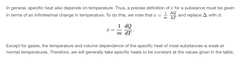

For this,
Text excerpt defining specific heat c as (1/m)(ΔQ/ΔT), replaced with (1/m)(dQ/dT) for infinitesimal temperature change, then noting specific heats are taken as constant for most substances at normal temperatures.
Dose anybody please know of a better way to derive the formula without having ##c = \frac{\Delta Q}{m \Delta T}## then taking the limit of both sides at ##\Delta T## approaches zero? I thought ##\Delta Q## like ##\Delta W## was not physically meaningful since by definition ##Q## is the heat transfer.
Many thanks!

The specific heats are defined in terms of derivatives of intenal energy or entropy not of heat. And as definitions, they cannot be proven.
The heat is not a function of state so using the derivative of heat in respect to temperature it may be a little hand waving.

Thank you for your reply @nasu!
That is very interesting what you mention. Sorry I did quite get the bit I put it italic above. I don't understand the bit about hand waving. Is it still correct what the textbook did?
