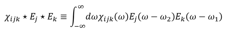

Attempt 2
Another approach I have attempted is that recognizing the the desired frequency-domain form (equation 2) is very close to convolution with respect to ω=ω1+ω2:
Frequency-domain expression: chi_ijk(omega) star E_j(omega) star E_k(omega) equals the double integral from minus infinity to infinity over d omega_1 and d omega_2 of chi_ijk(omega) E_j(omega minus omega_2) E_k(omega minus omega_1).
However,
- Why would a convolution in the time domain map to a convolution in the frequency domain?
- The original formula (equation 2) does not have an integral with respect to ∫dω2.
Any help is incredibly appreciated.

  • Equation: chi_ijk star E_j star E_k equals the integral from minus infinity to infinity of d omega chi_ijk(omega) E_j(omega - omega_2) E_k(omega - omega_1).
  • Equation: chi_ijk(omega) star E_j(omega) star E_k(omega) equals the integral from minus infinity to infinity of d omega chi_ijk(omega) E_j(omega - omega_2) E_k(omega - omega_1).
  • Frequency-domain expression: chi_ijk(omega) star E_j(omega) star E_k(omega) equals the integral from minus infinity to infinity of d omega chi_ijk(omega) E_j(omega - omega_2) E_k(omega - omega_1).
  • Frequency-domain expression: chi_ijk(omega) star E_j(omega) star E_k(omega) equals the double integral from minus infinity to infinity over d omega_1 and d omega_2 of chi_ijk(omega) E_j(omega minus omega_2) E_k(omega minus omega_1).
