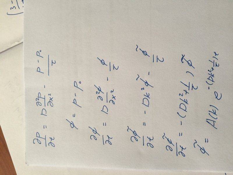

Shift p to p-p0 (p nought) to get rid of the inhomogeneous term. (Doesn't affect the derivatives)
Then Fourier transform the equation, the derivation is similar to that of the heat kernel. Throw p0 to the other side and you get that expression.
Sorry for the informal language.
EDIT:I'm bad with LaTex so here's a photo of the first few steps. Just do the same trick with the heat kernel here and you're good.
  • Handwritten derivation, rotated on the page: shifting p-p0 to phi, then the heat-type PDE dphi/dt = D d2phi/dx2 - phi/tau, followed by its Fourier transform, giving an ODE in k and a solution with exponential factors.
Thanks man, that worked out nicely.

No prob. Did you have difficulty with the inverse Fourier transform

I'd have if I've done it myself, but I used wolframalpha.com!
