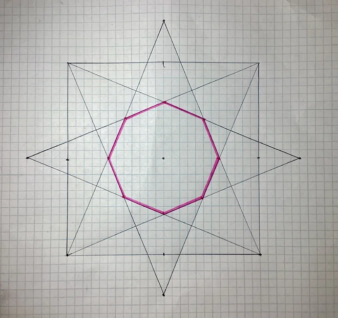

I need to learn to work the computer graphics package. :) If you follow my post 36 carefully, you will get a small regular octagon in the center of the figure, nearly the same in size as the one of the irregular case of post 23. :)
It will be oriented so that the top and bottom are both horizontal, and the right and left sides are both vertical lines.
Finally, I think you meant this.
  • Love
@bob012345 Yes, the octagon in the very center is what I was looking for. Excellent. :)
That's what I think they were trying to do in the second part of the video of post 28, but they didn't get it right.
It looks off but I computed the coordinates and checked the edge lengths which are ##2-√2##.
  • Agree
I believe you have it completely correct, (post 46). You didn't get the black marker right on top of the fine line in all cases, but very good. Excellent. :) and I agree with your calculation for the length of each side of the octagon. :)
Very close inspection shows the root 2 in your diagram is 1.375=11(.125), instead of 1.414, but it's more than accurate enough to illustrate the concept. :)
Yes, I rounded it to fit the grids of the graph paper from 2.828 to 2.75 since the grids were quarter inch. Made the drawing a lot easier!
