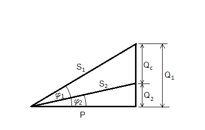

Sounds like HW, but I'll give you instructions.
Consider triangle of powers:
Since given data are power, voltage, and power factors it is suitable to work with this values only.
P=P1=P2
cos φ1 → φ1=...
cos φ2 → φ2=...
Q1=P⋅tg(φ1)
Q2=P⋅tg(φ2)
Qc=Q1-Q2
Qc=V2⋅2π⋅f⋅C ⇒ C=Qc/(2π⋅f⋅V2)
Note, this is a calculation for a single phase circuit case. If you're referring to a symetrically loaded 3 phase circuit, then given power is total power of 3 phase system. This means you have to calculate with power P/3 per phase and with phase voltage is V/√3. This will give you value of cap if the caps are wye connected. If you want caps connected in delta the value is CΔ=Cwye/3.

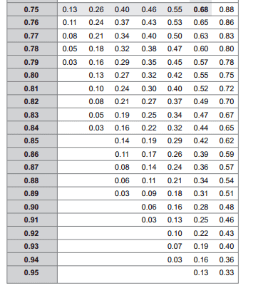

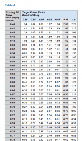

i can answer this in a very simple way and to the point. just watch out.
We have formula for it, i.e KVAR=factor*KW
whereas factor = factor K for compensation (you can get this from table-4,which i have attached also with this post)
KW = actual load
KVAR = required capacitors to improve p.f (as in market here, capacitors sell out by KVAR rating, not in FARAD. )
there are three types of capacitors available in industrial market, (i)12.5 KVAR (ii) 25 KVAR (iii) 50 KVAR, as i told you that you can purchase capacitor by KVAR ratings also.
Now come to the problem of Walli Bhatti,
KVAR = 0.59 * 930KW
=548.7KVAR
so you then need 10 capacitors of 50KVAR ratings and 2 capacitors of 25KVAR ratings, connecting these in parallel, your power factor will definitely improve upto 0.92.

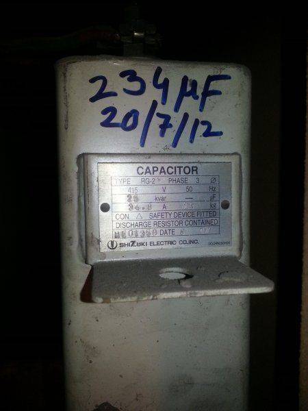

as attached files...the one with the calculation using above formulas, resulting the 75uF Capacitor which is too low value for such load. where as on the site there are two capacitors of 234uF and one 100uf are installed in parallel...as attached files...do help me out in this regard

thnks for your guideline engr jawad... as i have seen personally these two capacitors of 25kva and one of 15kva are installed parallel, as i switch of these capacitors due to running inductive load power factor comes to 0.75 and as i switch one this capacitor bank it turn to 0.92. along with this load of 950KW...can u please guide me how the three capacitors are working here to imprve upto this level

Looks to me you don't know how to multiply/divide couple of numbers or/and convert basic electrical units even when given step by step formulae...
For compensation of ≈560 000 VAr at V=400 V, f=50 Hz, the formula gives wye connected capacity value ≈11150 μF (yes, that's 11.15 mF).
Also you didn't answer question regarding dominant load in your industrial facility (motors? induction furnaces? etc) , its' variabilty, type of compensation you're dealing with...It's obvious you have very limited knowledge about this. Man, it is power equivalent of half a megawatt, and yet you want DIY and somebody to help you with it on public forum.
Friendly advice: find professional to take care of it. Good luck.
