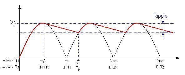

Don't forget to account for the diode voltage drops! The 5V +/-1% specification puts a pretty tight constraint on the allowed peak voltage (Vp), which will follow the peak voltage supplied by the bridge rectifier.
To calculate C I did this:
charge Q = I x t where t is the time for 1/2 cycle (full wave rectification) =1/2f
Q = I/2f
C = Q/V (V is the ripple voltage)
C = 1/2fV
You equation is V = 1/2fC
Both methods are exactly the same

I'm guessing that you averaged the full wave rectified waveform to determine this DC value? That analysis only applies where there is no filter capacitor, so is not applicable to your circuit. In your circuit, the big filter capacitor charges to the peak value of the AC and holds this voltage until the next peak. So the DC output will be roughly equal to the peak of the AC (less diode drops).

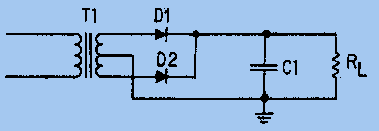

2) what is Diode configuration? full wave rectifier or full wave bridge rectifier.. which one ?
The opening post of the thread did not specify the configuration. It said to specify a configuration. Why not choose one and work with it?
A full-wave rectifier circuit might be a little closer to ideal, with only one diode's impedance involved at any time.
