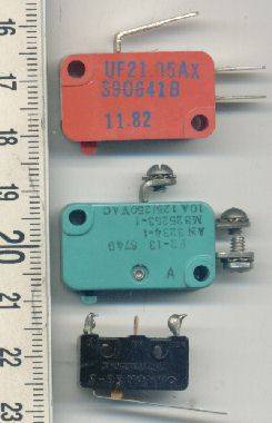

Once you've determined which spring (stiffness), you could use micro-switches to determine the top and bottom locations. Maybe to sound an alarm or trigger some other action.
