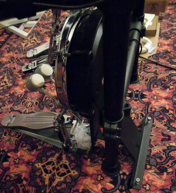

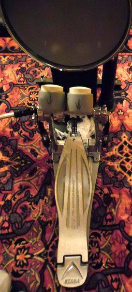

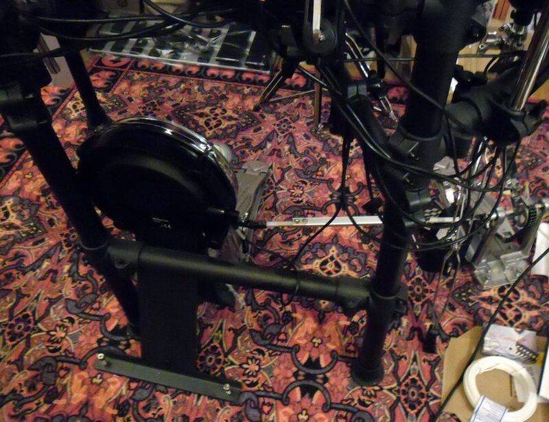

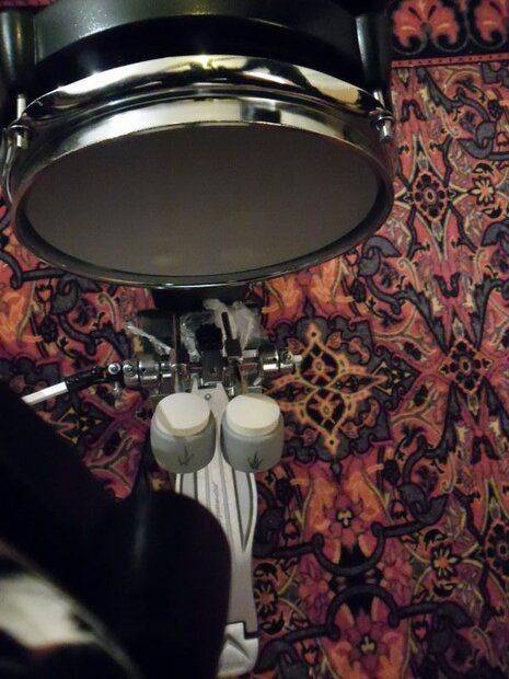

I can still edit it, but I think it's fine as-is for now. Do you have any pictures of your setup, especially the kick drum part? :smile:

As for what this stuff looks like... Well, I have the plywood thing, resting on 4 sandbags of 25kg each, and a carpet on top. I also tried adding thick multi layers of cardboard directly under the pedals to no avail.
Some people just put massive amounts of foam material from home depot under the platform, but again, that sort of stuff tends to emit aggressive (to my airways) gases into the room air, so not for me.
I will read the so far suggestions and linked to sites this weekend, have been too tired the past evenings.
