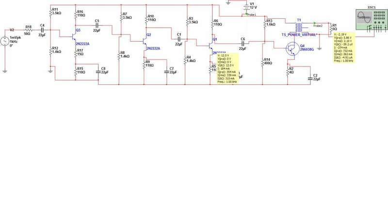

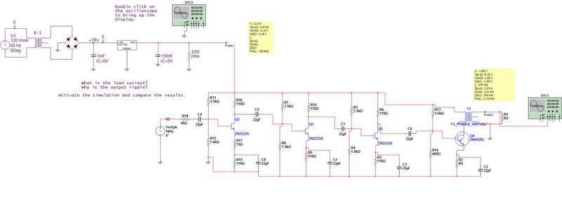

Designing a Class A amplifier for project with high voltage gain and high efficency or at least as high as we can get. It has to have a 12V power supply. We have the design but the when we add the power supply that converts the 120v ac to 12v dc our output voltage goes completely wack and isn't smooth at all, yet what's coming out of the rectifier is 12V according to multisim, so what's the problem?

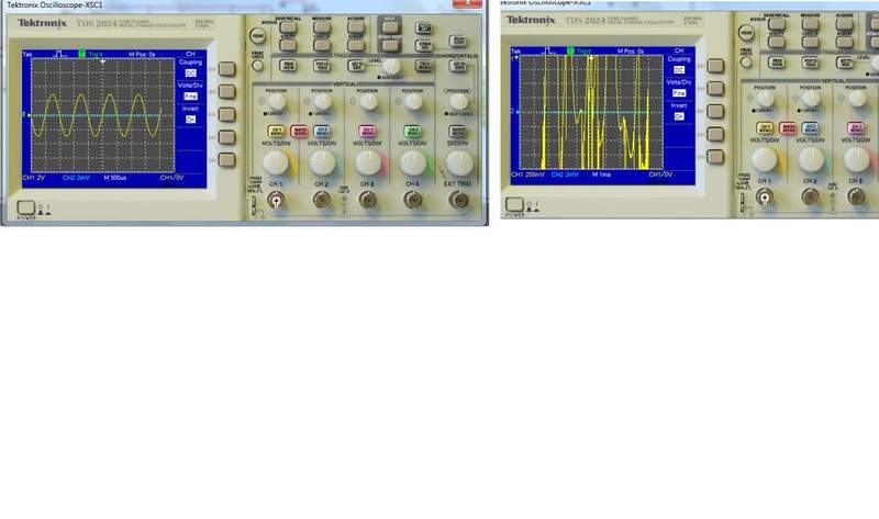

I attached a picture of the circuit with the Vp-p output and the power supply output. This circuit doesn't produce a smooth AC output voltage when the power supply is connected.
  • Multisim schematic of a power supply (120 V, 60 Hz source, 8:1 transformer, bridge rectifier, 1 mF and 100 mF capacitors) feeding a three-stage transistor amplifier with 2N2222A and 2N3906 transistors and a T1 power transformer output.

  • Multisim schematic of a three-stage transistor amplifier with 2N2222A and 2N6036 transistors, a 12 V DC supply, a 1 mV 1 kHz sine source, and a probed transformer output feeding an oscilloscope.

  • Two Tektronix TDS 2024 oscilloscope screenshots: left shows a smooth sine wave in yellow and green, right shows a noisy, distorted yellow waveform with sharp spikes and irregular bursts.

If the supply voltage is not smooth it suggests your smoothing capacitors are too small.
I think I can see 1mF before the voltage regulator and 100nF after the regulator
Do you mean 1 microFarad by 1mF or 1 milliFarad?
100nF means 100 nanoFarads
These seem small for smoothing capacitors.
Can describe how you arrived at the values of the resistors and capacitors?
