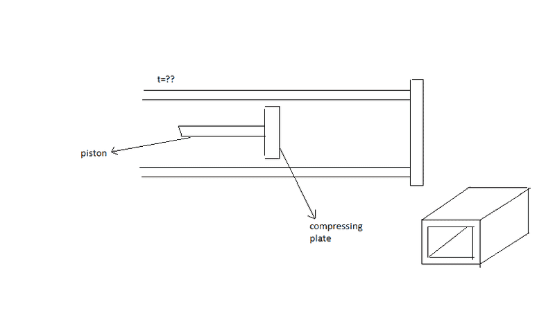

Hey there,
We are designing a rectangular duct composed of 4 metallic plates fastened together by bolts(or welded), where we will compress approximately 30 drinking cans, we are facing a problem by determining:
1- The thickness of the metallic plates that form the walls of the duct.
2- The thickness of the steel plate that is fixed to the hydraulic piston which will compress the cans.
To compress 30 cans, we need a total load of 180KN.
The duct's inner dimension are 30x30 cm.
Clearence between the sheet plate and the rectangular duct is about 5mm.
check the drawing for details.
much thanks
