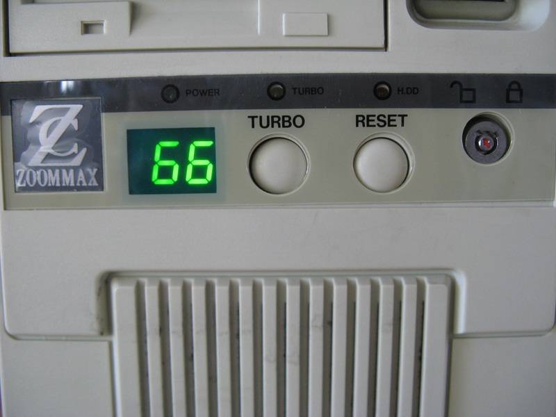

Have you tried the Turbo button?
There is no turbo button! The computer was working perfectly last night and has been working, this is a very reliable computer since it was new, it just happen today.
I think Dave was pulling your leg.

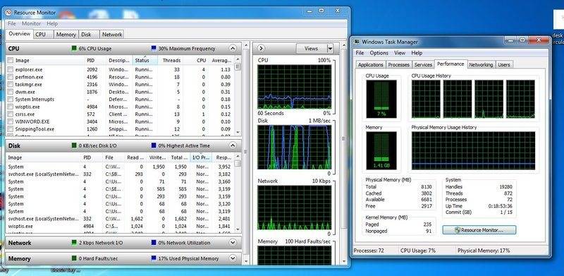

What are the stats for hard drive activity in task manager?
And I've always wondered what that turbo button did, what does it do?
I took a screen shot of the activity:
You can see, CPU and menory usage is very low even I am doing the screen capture, you can see the disk usuage is high because of the screen shot, but it return to very low again after that. Everything is just idle and slow.
I have seen tubo button, it's not new to me. This computer just don't have it. I never know what it does because I tried and no difference in anything. It's not as if it run faster.

The Turbo Button is only available in PCs made before the 90's. Instant cpu overclocking.
