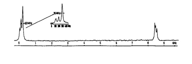

The figure below shows the hyperfine structure in the transition 6s $^2S_{1/2}$ - 8p $^2P_{3/2}$ in 115In (I = 9/2). The measurement is made using a narrow-band tunable laser and a collimated atomic beam; hence the Doppler width is greatly reduced. The 6 components shown have the following frequencies 31, 112, 210, 8450, 8515 and 8596 MHz. Draw a schematic figure of the energy levels with the appropriate quantum numbers and show the allowed transitions. Determine the hyperfine constants, in MHz, for the two fine structure levels
(Image is just a blurry graph and not necessary, all data is given)

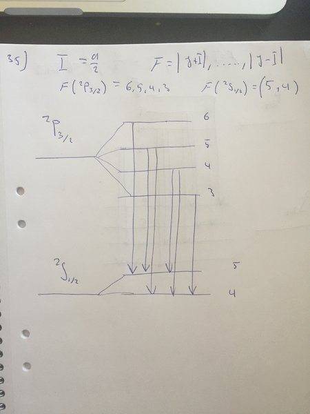

I did as you said and drew the energy diagram. See uploaded picture. Also a print-screen of the graph belonging to the exercise.
You are right, I do probably have the energy differences in MHz, but I'm not quite sure how to identify the transitions.
I also tried to use formula (1), with the biggest frequency, 8596MHz on the left hand side, and used $F_{max}$ as my F in the equation. But that was a bold guess and the the answer got wrong.
So now I'm pretty stuck again, I know there is the Landé interval rule stating $$Energy ratio = \frac{F_{max}}{F_{max}-1} (2)$$ but I can't see how that can help me determine A either...

OK, so you have the a diagram of the energy levels and the transitions. Now use your equation for Ehfs to obtain values for the energy levels in terms of A (remember the A values will be different for the 6s and 8p states, you are asked to find both). Assume a value T (unknown) for the energy difference between the unsplit S and P states. Now derive expressions for the energies of the allowed transitions. Do you observe any patterns that would help you assign the observed frequencies to particular transitions?

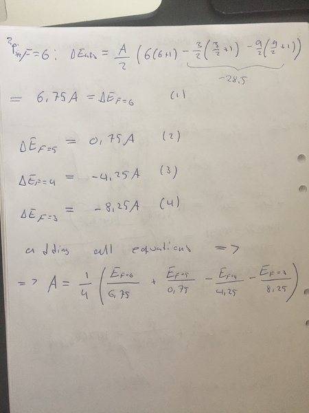

I see. Starting with ##P_{3/2}##, I sat up 4 equations for all the F values (6,5,4,3). Then I solved for A (see attached picture).
Now I guess all I need to do is to figure out what ##E_{F=i}## for i=(6,5,4,3). I tried to use them in magnitude order, but the result got plain wrong.
Am I on the right track or am I thinking about it wrong? Because I really can't see the connection between the given frequencies and ##E_{hfs}##.
Thanks on advance.

The frequencies aren't directly connected to Ehfs. They are transition frequencies, so refer to the difference between two energy levels. Repeat what you've done for the 2S level, and work out the energies of the allowed transitions.

Yes. You need to obtain expressions for the TRANSITION energies. You can't work out A (2P) just from the expressions for the 2P energy levels, because you have no (direct) data on the relative energies of these levels. You have frequencies for the transitions between the 6s and 8p levels.

I now have the expressions $$A_{^2P} = \frac{1}{4}[ \frac{E_6}{6.75} + \frac{E_5}{0.75} - \frac{E_4}{4.25} - \frac{E_3}{8.25} ] (1) $$
$$A_{^2S} = \frac{1}{2}[ \frac{E_5}{2.25} - \frac{E_4}{2.75} ] (2) $$
Is it so that the frequencies now is the energy-differences in these expressions, e.g. ##E_6 - E_5## is the given frequencies. I'm still not sure how I know what frequency correspond to what energy differences. Nor how to solve the equation system above. Do you have a lsat hint on this so it clicks?
Once again, you can't solve the equation system because you don't know what the energies are. Try doing what I have suggested several times. Get expressions for the energies in terms of the A constants (rather than the other way round). To simplify, let us give the lowest energy level (E4 of 2S) a value of 0. What is the energy of E5(2S)? Let us give the lowest 2P level (E3) a value of T (I suggested a different definition for T above, but run with this, it's simpler). What are the energies of the other 2P levels?
Now work out expressions for the energies of the allowed transitions between levels. You have drawn these transitions in post #3.
Then look for patterns in the transitions that may help you assign them. Look at the differences between the transition energies. For example, as the transitions 6→5, 5→5 and 4→5 all terminate on the same lower state, the differences between them should be the same as the differences between the 6, 5 and 4 levels of 2P. Does this help you find A(2P)?
Hint: A(2S) and A(2P) may be very different!
