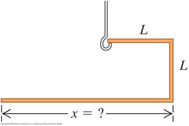

A thin uniform metal rod is bent into three perpendicular segments, two of which have length L = 4.67 m. Determine the length of the third segment such that the unit will hang with two segments horizontal when it is supported by a hook as shown in the figure.
sum T=0
sum F=0
mgr=T
mg=F
i tried a number of different ways to solve the problem but it seems like nothing has a chance of working
PS this is the first time I've posted on here, i looked through some other posts and read the rules to figure out the etiquette but if i still did anything wrong please just let me know it wasn't on purpose.
I have the same problem as you, I did a google search for this question and got this thread. I have no idea how to solve it though. Good Luck!
I can't see the image try uploading it to imageshack or something then posting the link, thanks.
If it is in equilibrium then the center of mass lies directly below the point of support.
Find the point that it balances right?
x = 1/M*∑ xi*mi
Since this x is located at L from the right ... you need to solve for the unknown length of the bottom piece (it appears in the sum of the moments) that you don't know.
