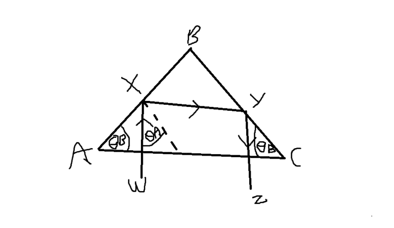

In the figure shown, a prism ABC can be used to reflect a laser beam such as WXYZ.
Determine the relationship between θB and θA
Sin(c) = 1/(refractive index)
To be honest I am not sure at all, I know that for total internal reflection to occur, the angle of incidence must be greater than the critical angle which is not given, but I do see that the angle WXY is 90° and since a normal is separating them then θA must be 45 degrees, am I correct in saying this? I don't know how that angle is related to θB though.
Any help would be appreciated

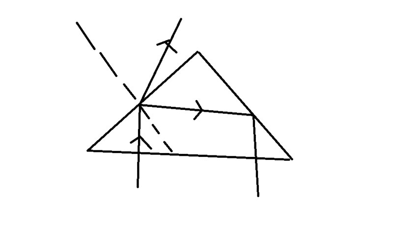

Make a drawing to see what you get when ##\theta_b < \theta_a##.
I would get refracted ray such as this?

What is the relationship between θA and angle AXW? What is the relationship between θB and that angle?
Ah yes haruspex I see, θA and angle AXW must add up to 90 because that is a normal that is between them, as for θB and angle AXW...I'm not entirely sure

So if theta A and angle AXW will add up to 90, how is angleAXW related to theta B and then from there how is theta A related to theta B?
Come on !
##\quad \theta_a + \angle {\rm AXW} = 90^\circ##
##\angle {\rm AWX} = 90^\circ ## (as you gave away in a later stage :rolleyes:)
so what about ##\quad \theta_b + \angle {\rm AXW} ## ?
Here goes my attempt kind physics teachers:
θB+90+(90-θA)=180
180+θB-θA=180
θB-θA=0
θB=θA

Now the nice thing about this ##45^\circ## prism is that even if ##\angle AXW\ne 90^\circ## (*), the ray is still reflected in the direction it came from: WX is parallel with YZ.
A bit of practice to show that will do you good !
Greetings from a kind 'teacher' o0)
(*) within limits determined by the Brewster angle
Oh ok, so θA and θB would have been the same even if the angle wasn't 90 degrees then? Also am I safe to assume my answer is correct?
No to the first and yes to the second.
The second even with a caveat: we haven't seen that ##\angle ABC## is exactly 90 degrees in the problem statement, have we ? Are we to assume WX // YZ from thte picture, or is it a given ? because then not only ##\theta_a=\theta_b## but even stronger ##\theta_a=\theta_b=45^\circ##
And for the first: if ##\theta_b = 45^\circ## and WX not ##\perp{}## AC then of course ##\theta_a\ne 45 ^\circ## so a bit more work is at hand to show that WX//YZ
You should draw a number of diagrams carefully. A separate diagram for each case, for example with ∠ABC = 900. and ∠ABC ≠ 900. Follow the rules of reflection and refraction in each case.
