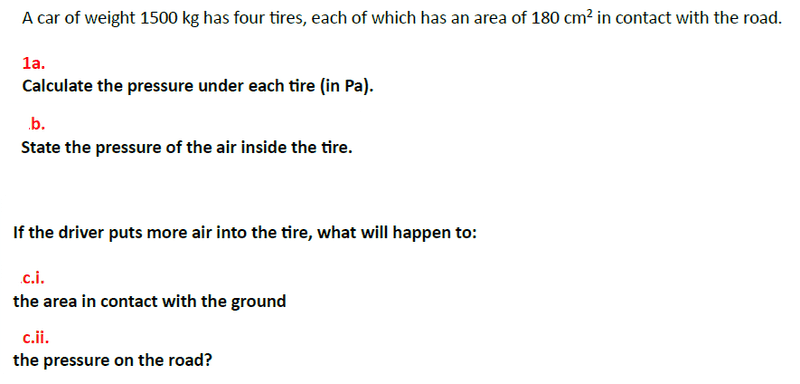

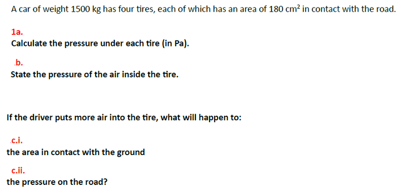

A car of weight 1500 kg has four tires, each of which has an area of 180 cm[SUP]2[/SUP] in contact with the road.
a) Calculate the pressure under each tire (in Pa).
b) State the pressure of the air inside the tire.
c) If the driver puts more air into the tire, what will happen to:
(i) the area in contact with the ground
(ii) the pressure on the road
P = F / A
a) ##P=\frac{F}{A}=\frac{\frac{1500\times 9.8}{4}}{180\times 10^{-4}}=2.04 \times 10^{5} Pa##
b) Is the pressure in (a) gauge pressure? My answer for (b) is 2.04 x 10 5 + Po where Po is atmospheric pressure
c)
(i) it will increase since the size of the tire also increases
(ii) I am not sure about this one. The area increases but the force exerted by the tire also increases due to increase in number of air molecules inside the tire but I suppose maybe the increase in force is smaller compared to increase in area so my answer will be the pressure decreases.
Is my answer correct? Thanks

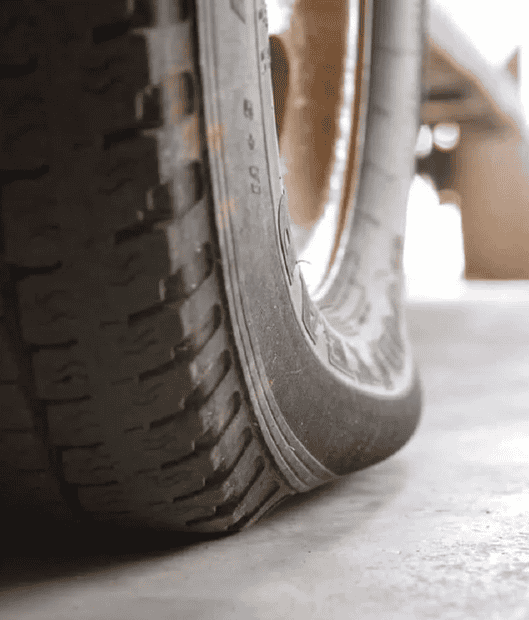

For a bit of intuition: Would you say this tyre is over or under inflated? What about the contact area in comparison to a tyre with correct pressure?

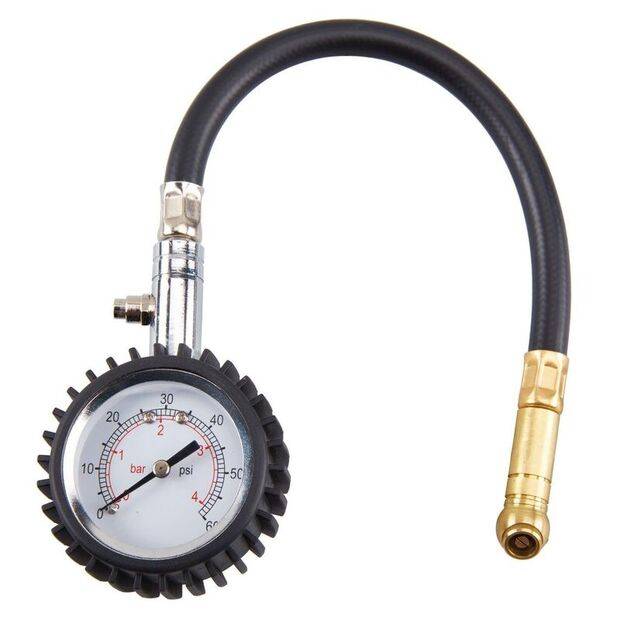

The practical way to measure internal air pressure in any tire is via a manometer; therefore, the measured value is not of absolute pressure, but above the atmospheric pressure.
When not connected to an inflated tire, all manometers or tire gauges should be showing 0 (respect to the actual surrounding atmospheric pressure).
Also, the external force of the contact patch on the road will not change for any internal force of the air on the interior surface of the tire.
Both are pretty much independent from each other.
Under inflated. The contact area is bigger than tyre with correct pressure.

. Why the answer is not the total pressure of air inside the tire?
For the reasons @Lnewqban gave in post #7. There are two standard ways to state a pressure:
- as "gauge", pressure, which means the measure shown by a standard pressure gauge. This shows the excess pressure above atmospheric pressure, because that is what is easy to measure and for most practical purposes is the important statistic. The effective pressure in a tyre is its gauge pressure: that determines how firm it is and whether it is at risk of bursting.
- as absolute pressure. To measure that you need to have on hand a partial vacuum as reference, such as in an aneroid barometer.
School questions ought to state which is being used. If unstated, you have to consider the context. Here, gauge pressure is appropriate. Had the question provided a value for atmospheric pressure then that would have been a hint to answer in absolute.
