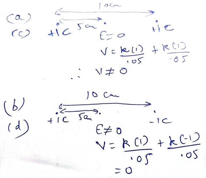

Below is what I came up with. I considered two charges of ##+1C## separated by a distance ##10 cm## to disprove (a) and (c). I then considered the mid point of the line joining these point charges where net ##E=0## by superposition principle but ##V\ne0##. This disproves (a) as well as (c).
Similarly, to disprove (b) and (d) I considered charges ##+1C## and ##-1C## separated by a distance of ##10cm##. Then, I determined ##E## and ##V## at the mid point of line joining these point charges, using superposition principle.

vcsharp2003 said:
Below is what I came up with. I considered two charges of +1C separated by a distance 10cm to disprove (a) and (c). I then considered the mid point of the line joining these point charges where net E=0 by superposition principle but V≠0. This disproves (a) as well as (c)]
👌. I am an introductory physics student, so I don't know how to solve it rigorously using calculus. I will leave that to the experts
I think the "key" point of this problem is that it asks for a point in space, that is a single point. If it was in a region of space containing infinite points (all finite regions of space contain infinite points) then things would be different. Everything can be derived from ##\vec{E}=\nabla V##, having again in mind what happens in this equation when the values are as given for a single point in space.

I suspect the question is poorly worded and should say something like this:
At a point, P, in space, each of the following statements can be true of false. Under what conditions will each statement be false? (Take potential to be zero at infinity in the usual way.)​
I would answer like this:
a) How can the statement "If E=0 then V=0" be false at P?
The statement will be false if the (vector) sum of 2 or more fields at P is zero but the (scalar) sum of the associated potentials is non-zero. E.g. P is a point midway between 2 equal point charges.
And tackle the other statements in the same way (if you can get your head around the multiple negatives in statements c) and d)!).

I already came up with a similar solution as explained in an earlier post#8, where I assumed a pair of point charges of +1C for disproving (a) and (c), and a pair of point charges +1C, -1C for disproving (b) and (d). Separation of charges was 10 cm in both scenarios.

Another example that disproves statements (a) and (d) is as below.
Inside a charged solid spherical conductor with radius ##R## and total charge ##Q##, ##E =0## but ## V = \frac {kQ} {R} \ne 0##.

I think a counterexample is a pretty good description of why. I assume the point is you don't get full credit just for guessing correctly.
