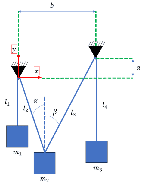

3 masses are hanging from 2 pullies as shown in the picture.
Assume ##l_1## and ##l_4## to be sufficiently large to allow for equilibrium to be reached if possible.
There is no friction. The pullies are small enough to be considered a point. Constant gravity is at play.
1) Knowing ##m_1##, ##m_2## and ##m_3## find ##\alpha##, ##\beta##, ##l_2## and ##l_3##.
2) If ##m_1## and ##m_3## are known, find the limiting values of ##m_2## that make equilibrium possible. Apply "question 1" to those 2 limiting scenarios.
Newton.
Vector summation.

I'll start with question 1. To find that, it's necessary to apply equilibrium to ##m_2##.
$$\sum F_x=0 \rightarrow -m_1g\sin\alpha + m_3gsin\beta = 0\rightarrow m_1\sin\alpha = m_3\sin\beta \tag{1}$$
$$\sum F_y=0 \rightarrow m_1g\cos\alpha -m_2g+ m_3gcos\beta = 0\rightarrow m_1\cos\alpha + m_3\cos\beta = m_2 \tag{2}$$
From equations ##1## and ##2## it is already possible to find ##\alpha## and ##\beta##. It's not pretty because it's a trigonometric system of equations so I couldn't completely clear the variables. This is what I got.
From ##1##.
$$\alpha=\arcsin(\frac{m_3}{m_1}\sin\beta) \tag{3}$$
Plugging that into ##2## results in.
$$m_1\cos(\arcsin(\frac{m_3}{m_1}\sin\beta) )+ m_3\cos\beta = m_2 \tag{4}$$
I believe ##\beta## cannot be cleared from ##4## so it's only possible to find numerical solutions. Still, from the numerical solution of ##4##, it's possible to plug in the value in ##3## and then we'd have both ##\alpha## and ##\beta## solved. Once that is known, it's now possible to find the values of ##l_2## and ##l_3##.

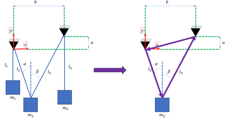

Left: two-pulley-free hanging setup with support points labelled by coordinates x and y, strings l1 to l4 holding masses m1, m2, m3, with angles alpha and beta from vertical and horizontal distances a and b. Right: arrow pointing to the same system drawn as purple force-direction lines.
The sum of the purple vectors must be 0. This gives two equations. Only ##l_2## and ##l_3## are unknown so it's solvable.
$$\sum x=0 \rightarrow l_2 \cos(3\pi/2+\alpha)+l_3\cos(\pi/2-\beta)-b=0 \tag{5}$$
$$\sum y=0 \rightarrow l_2 \sin(3\pi/2+\alpha)+l_3\sin(\pi/2-\beta)-a=0 \tag{6}$$
With that, the first question should be completely solved with the inconvenience of not being able to clear eqn ##4## to get a nice expression for the angles.

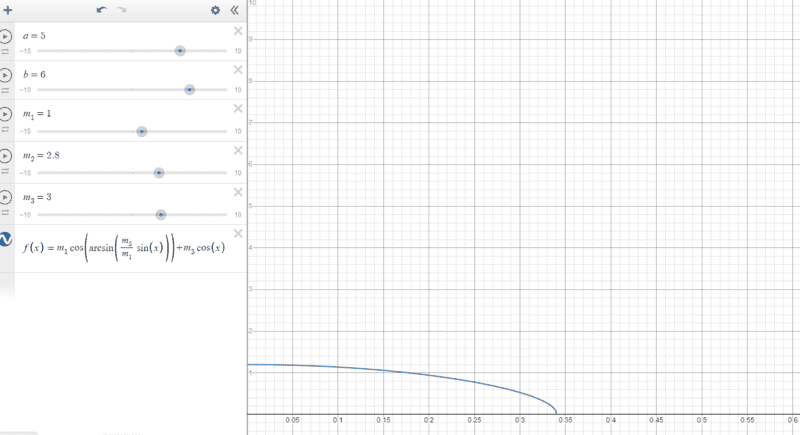

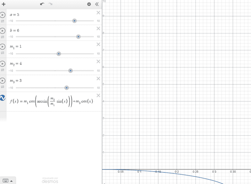

Now for question 2, I could only find the limiting values using a graphic calculator and I'd like to know if there is a better method that'd give some insight. I considered eqn ##4## to be a function. To deal with the online graphic calculator I changed ##\beta## with ##x##.
$$m_1\cos(\arcsin(\frac{m_3}{m_1}\sin\beta) )+ m_3\cos\beta = m_2$$
$$\downarrow$$
$$f(x)=m_1\cos(\arcsin(\frac{m_3}{m_1}\sin x) )+ m_3\cos x - m_2 \tag{7}$$
Fixing ##m_1## and ##m_3## it's possible to change the value of ##m_2## and see if there's any ##x## (##x=\beta##) for which ##f(x)=0##. As a first shot, the studied region will be within ##0\leq\beta\leq \arctan(a/b)##. The angle will be 0 when ##m_2## is too heavy and the angle will be parallel to the line between the supports if ##m_2=0##. In the following link, you can see the function.
https://www.desmos.com/calculator/8ddibiq3v0
Lowest possible ##m_2## that makes the function ##f(x)=0## within the shown range.
Desmos graph of f(x) = m1 cos(arcsin((m2/m1) sin(x))) + m2 cos(x) with m1 = 1, m2 = 2.8, a = 5, b = 6, m3 = 3; the curve starts near 1.2 at x = 0 and falls to zero near x = 0.34.
Greatest possible ##m_2## that makes the function ##f(x)=0## within the shown range.
Desmos graphing calculator screenshot with sliders for a=5, b=6, m1=1, m2=4, m3=3 and the function f(x) = m1 cos(arcsin((m3/m1) sin(x))) + m3 cos(x), plotted on axes from 0 to 0.35.
The limit case where ##m_2## is too heavy is somewhat intuitive. From playing with the function it seems that if ##m_2 = m_1+m_3## then the angles need to be 0 to support it. This can be seen in eqn ##2## although it feels weird both angles approach 0 "at the same speed" as ##m_2## goes lower and lower.
For the smallest ##m_2## though... I have no intuition about where the limiting value comes from. Let me know if you have other point of view or resolution method that could make this a little clearer.

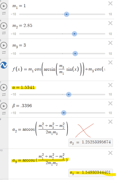

In the limiting case where ##m_2=m_1+m_3## → the angles ##\alpha## and ##\beta## will approach 0 to make equilibrium possible, and the sections of the ropes ##l_2## and ##l_3## will approach ##\infty## so that they can make those angles possible.
In the limiting case where ##m_2## is too light, I can only give a numerical solution so I need to assign values to all the variables (using SI for all of them). With ##m_1=1##, ##m_3=3## and using the graph shown then the minimum value for ##m_2## will be ##m_2 \approx 2.85## which will cause ##\beta \approx 0.3396##. Once ##\beta## is known, ##\alpha## can be known:
$$\alpha=\arcsin(\frac{m_3}{m_1}\sin 0.3396) =1.5341 \approx \pi/2$$
That suggests the limit for the lowest value of ##m_2## happens when the rope attached to the lower pulley becomes horizontal but I'm not sure why that is. This seems to get me closer to the insight I needed. Finding ##l_2## and ##l_3## seems trivial at this point so I'll omit it. EDIT: Actually it isn't. I want to check if ##m_2## always falls in the middle of the two.

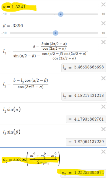

I doesn't look like ##(9## and ##(10)## simplify to make ##(8)## true. As a quick check, I'll find the resulting lengths for the smallest ##m_2## from post #2. For ##a=5##; ##b=6##; ##m_1=1##; ##m_2=2.85##; ##m_3=3##; ##\alpha=1.5341##; ##\beta=0.3396##. Plugging all that into ##(9)## gives:
https://www.desmos.com/calculator/1ghqgwlocn
$$l_3=5.4655$$.
$$l_2=4.18$$.
$$l_{2x}=\sin\alpha=4.17$$
$$l_{3x}=\sin\beta=1.82$$
As a quick check, it can be seen how ##l_{2x}+l_{3x}=b## so it'd be an indicator of the calculations being correct.
So it's been checked that ##m_2## is not restricted horizontally to the middle of the pulleys. The following is still the pending point to better understand this problem.

I'd say right now the main topic now is:
The limit for the lowest value of ##m_2## seems to happen when the rope attached to the lower pulley becomes horizontal but I'm not sure why that is. The realization of the horizontal limit gets me closer to the insight I needed.
I believe it happens because if that rope (the left one in this case) goes above horizontality, then ##m_3## would need to increase so much to equilibrate the forces that it'd be too heavy and it'd drag the rest of the masses with it but I couldn't prove it so far.
Steve4Physics said:
Hint for Q1. Draw the equilibrium force triangle for ##m_3## and use the cosine rule. You can easily find ##\alpha## and ##\beta## as functions of ##m_1, m_2## and ##m_3##.
Finding ##l_2## and ##l_3## in terms of ##a, b, \alpha## and ##\beta## is then just (probably messy) trig' and algebra.
I'd say Q1 is solved although not using the cosine rule. In fact, the cosine rule only gives 1 equation as @erobz showed on #5 but there are two unknowns (##l_2## and ##l_3##) so for that method I feel there's still something missing.
Even Q2 is solved numerically. I am now most interested in the text shown in italics above.

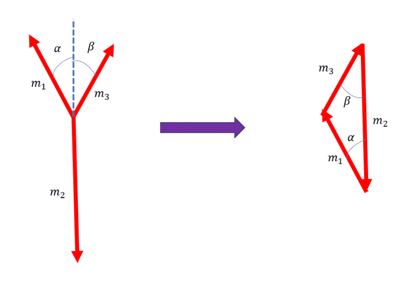

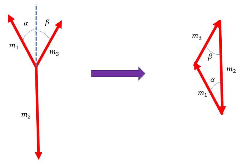

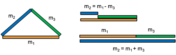

I wanted to point out an alternative approach. Often a first line of attack is to set up equations. But a more 'geometrical' approach sometimes helps. To be explicit...
EDIT. The following is wrong as I had ##m_2## and ##m_3## the wrong way round. The approach is correct though. For the correct version, see @Juanda's Post #20.
In Q1, if we construct ##m_3##’s force triangle we can use the cosine law. Cancelling the '##g##'s we can immediately write:
##m_2^2 = m_1^2 +m_3^2 - 2m_1m_3 \cos \alpha##
so
##\alpha = \cos^{-1}(\frac {m_1^2 + m_3^2 - m_2^2}{2m_1m_3})##
and similarly for ##\beta##.

Ok, I think now I'm getting where you're getting at. Also, the use of the cosine law differs from the one in post #5 because you did it on the triangle of forces instead of using it on the actual geometry. That seems to be very useful because it allows us to get explicit expressions for ##\alpha## and ##\beta## in terms of the masses.
I'll try to draw the triangles of forces you used to get to that expression to better understand its origin and get back here to confirm if it's the same or equivalent to what you did.

The point is that even if you have that expression ## \sin \alpha = f(\sin \beta )## when you plug it into (2), you won't be able to have an explicit expression for ##\beta## so I don't see the benefit of doing that.
I'm working on what @Steve4Physics suggested in post #14. Somehow he managed to use the cosine law without having both ##\alpha## and ##\beta## in the same equation so he'd actually get the angles as an explicit function of the masses although I still couldn't reproduce the result.
In fact, I suspect there might be something wrong. For the initial conditions described in #2 I got:
However, when I use the expression shown in #14 I get a very different result.

Here is the difference between the values of ##\alpha## depending on the method to obtain it. ##\alpha## is from the procedure I showed and ##\alpha_2## is using the equation suggested at #14.
Screenshot of a symbolic calculator showing sliders for alpha = 1.5341 and beta = .3396, equations for l3, l2, l2 sin(alpha), l3 sin(beta), and alpha2 = arccos((m1^2 + m3^2 - m2^2)/(2 m1 m3)) = 1.25253395674.
Here is what I got. This is the triangle of forces (scaled with a factor ##g##)
Left: a vertical rope junction with two upward-pointing vectors labelled m1 and m3 at angles alpha and beta from a dashed vertical line, and a downward vector labelled m2. Right: the same three vectors joined head to tail forming a closed triangle, with alpha and beta marked at the corresponding vertices.
Using the law of cosines:
$$\alpha = \arccos(\frac {m_1^2 + m_2^2 - m_3^2}{2m_1m_2})$$
It seems there's a small typo in the expression @Steve4Physics proposed but the concept is totally right and very convenient. Doing it like this, it's possible to obtain the expressions for the angles in terms of the masses and nothing else. Once the typo is corrected, I get the same results using both methods (the one I showed and the one using the law of cosines which I believe is much more convenient).
Screenshot of a GeoGebra interface with sliders for m1 = 1, m2 = 2.85 and m3 = 3, a plotted function f(x), and angle values alpha = 1.5341 and beta = .3396, with formulas for alpha_2 and alpha_3 as arccos expressions in the masses; alpha_2 is crossed out and alpha_3 = 1.54930344401 is highlighted.

I would assume that the pulleys are ideal, i.e. that they change the direction of the the tension but not its magnitude. Then because the tensions in the strings supporting ##m_3## are equal to the hanging weights on each side. The equilibrium condition is the that the sum of all the forces be zero.
##\vec T_1+\vec T_3 +m_2\vec g=0## which, as you have observed, forms a closed triangle (see my version below).
Left: a vertical string from a pulley-like node with three forces: m1g up and to the left at angle α from the dashed vertical, m3g up and to the right at angle β, and m2g straight down. Right: the closed force triangle formed by m2g, m1g and m3g, with angles α and β marked and the exterior angle labelled π-(α+β).
Now apply the law of sines on the force triangle on the right noting that ##\sin[\pi-(\alpha+\beta)]=\sin(\alpha+\beta).## $$\frac{m_3}{\sin\alpha}=\frac{m_1}{\sin\beta}=\frac{m_2}{\sin(\alpha+\beta)}.$$The first equation gives $$\sin\beta=\frac{m_1}{m_3}\sin\alpha~;~~\cos\beta=\sqrt{1-\left(\frac{m_1}{m_3}\sin\alpha\right)^2}.$$The second equation gives $$\sin\alpha=\frac{m_3}{m_2}\sin(\alpha+\beta)=\frac{m_3}{m_2}(\sin\alpha \cos\beta+\cos\alpha\sin\beta).$$ We now eliminate the ##\beta## trig functions and do some elementary algebra to get $$\cos\alpha=\frac{m_2^2+m_1^2-m_3^2}{2m_1m_2}.\tag{1}$$We find ##\cos\beta## by swapping indices 1 and 2, $$\cos\beta=\frac{m_2^2+m_3^2-m_1^2}{2m_2m_3}.\tag{2}$$These expressions answer the first part of the question.
As for the second part, the condition for equilibrium to exist is obvious. When there is equiibrium, the forces and hence the masses must form a closed triangle. In other words, the masses must obey the triangle inequality, $$m_1+m_2>m_3~; ~~m_3+m_1>m_2~;~~m_2+m_3>m_1.$$Note that equations (1) and (2) that give the squares of the sines are positive only if the triangle inequality is obeyed.
On edit: I just noticed that I called the middle mass ##m_3## instead of ##m_2## and the mass on the right ##m_2## instead of ##m_3.## I apologize for the confusion this might generate when comparing solutions.
On second edit: I swapped mass indices 2 and 3 in the diagram and equations to bring the labeling in line with OP's labels.
On third edit: Fixed algebraic errors in my original derivation which brought my original expressions in agreement with those of OP.

The use of the law of cosines in the triangle of forces to obtain ##\alpha## and ##\beta## agrees with this. If I try to go beyond the limits, the functions are not defined.
Left: three forces at a common point, m1 and m3 pulling up-left and up-right at angles alpha and beta from a dashed vertical line, and m2 pulling straight down. Right arrow leads to a closed triangle of the same three force vectors labeled m1, m2, m3, with alpha and beta marked between sides.
$$\alpha=\arccos(\frac{m_{1}^{2}+m_{2}^{2}-m_{3}^{2}}{2m_{1}m_{2}})$$
$$\beta=\arccos(\frac{m_{2}^{2}+m_{3}^{2}-m_{1}^{2}}{2m_{2}m_{3}})$$

Juanda said:
As a consequence, we have an upper and lower boundary for ##m_2##.
$$m_3-m_1<m_2<m_3+m_1$$
That's the triangle inequality. Take two sticks of different lengths. Call the longer one ##m_1## and the shorter one ##m_3##. Consider the upper and lower limits the length ##m_2## that a third stick must have to form a triangle. See picture below.
Left: a triangle with sides labelled m2 (blue), m3 (green) and m1 (orange base). Right: two strip diagrams, the top with m2 = m1 - m3 and the bottom with m1 and m3 end to end as m2 = m1 + m3.
Yes. That's clear now. I did a worse sketch on my notebook but I got it when you pointed at it on post #23. Seeing presented here like that helps though. Especially to future readers.
This problem is turning out to be an even better learning experience for me than I anticipated.

@Juanda, I suspect this is part of the problem...
The line (##L##) joining the pulleys makes an angle ##\theta =tan^{-1} {\frac ab}## with the horizontal.
The maximum possible value of ##\alpha## is ##\alpha_{max} = \frac {\pi}2 + \theta## when the upper rope-sections are in a straight line. (For ##\alpha## larger than this, ##m_2## would be above ##L##.)
With the values of ##a## and ##b## used in your link, I get ##\alpha_{max} = 2.266~rad~(=129.8^o)##.
But the link shows ##\alpha = 2.372~rad~ (=135.9^o)##, which exceeds ##\alpha_{max}##. So equilibrium is not possible for the values of mass used in the link.
I see it the same way. For example, if ##m_2=0## then the rope would be straight from pulley to pulley, and equilibrium would only be possible if the remaining masses are the same.
However, the central point of the argument is that we "know" the line cannot fall on top of the line linking the two pulleys derived from the intuition of the case where ##m_2=0## but I can't get a conclusion about why the limiting angle for the line is the same in the general case where ##m_2 \neq 0##.
Secondly, for ##m_2=2.3## the result is also strange because according to ##f(x)## there is no real value for the angle that can make equilibrium possible. However, we know equilibrium does happen because when obtained from the cosine law the results are physically possible. (I believe the problem with ##f(x)## is related to how the function ##\arcsin()## is defined similar to how the function ##x^{0.5}## only returns positive values).
Desmos graphing calculator screenshot with sliders a=5, b=6, m1=1, m2=2.3, m3=3, followed by definitions of alpha and beta via arccos, a value for l3 and a blue curve plotted against axes from 0 to 0.4 and -5 to 15.
